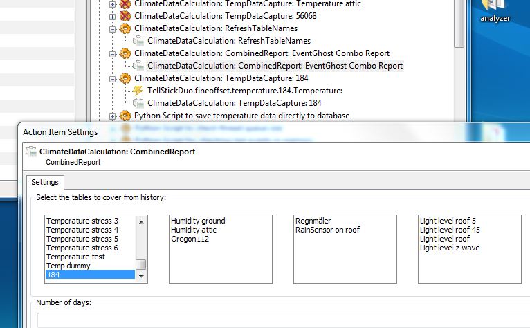

But to see this in a report you need to do the following at least once
1) Verify that the capturing is correctly configured and has started (you have to drag the event to the macro like in the picture below)
2) Run the action 'RefreshTableNames' or restart the plugin
3) Create a combo report and you should find your table there in the list (184 in my case)
Hi, it works here. I have simulated your event and it is captured if you use id=184. I named the table 184 as well.Thanks for the answer, but "184" was the first thing I tested and it didn't seem to work.
I have also tried the whole string "TellStickDuo.fineoffset.temperature.184.Temperature:", but no luck.

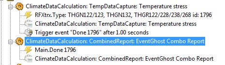

1. I would like to generate a new report every time a new value is entered to the database. Is that possible? (or would it perhaps be possible to generate an event when a value is entered?)

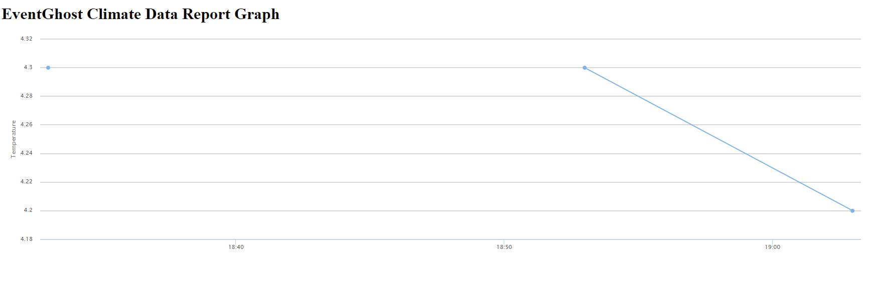

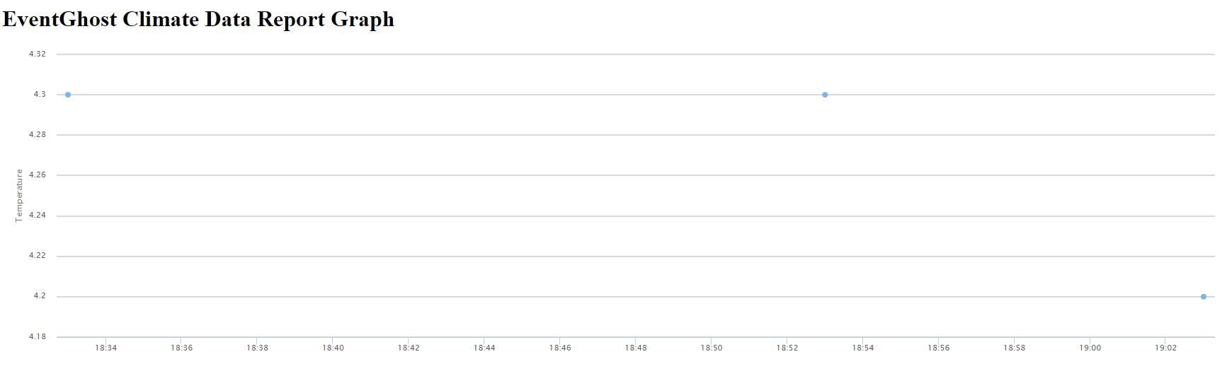

Re: ClimateDataCalculation
Hello, nice to hear!
In a normal situation, a 10 minute interval is most of the time acceptable unless you really want to measure fast changes (but then you should also select a shorter period for the report itself).
I do not yet understand why your reports are empty. When I try it works as expected. I have saved a few readings with 10 min interval and then generated reports with and without the check box ticked. I do get the reports with data, only difference is the horizontal scale for the time, in the 10 min variant the scale is with 10 min, the 1 min is with 1 min and in the 1 min chart there are no lines between the data points.
What I could imagine is that you are logging at 10 min interval. If you create a 10 min report, you will see lines between the data points (unless there are gaps). If you instead select a 1 min report to be created, the lines will disappear since the report generator is seeing gaps in your data collection (expecting data every minute but only seeing every 10 min)
See Pictures below
Yes, I do that myself using an event and a macro that creates the report after a short 1 second pause (to allow the database to be closed, maybe not needed but anyway...). The configuration look like this:1. I would like to generate a new report every time a new value is entered to the database. Is that possible? (or would it perhaps be possible to generate an event when a value is entered?)
It uses the readings you have collected, means if you have gaps, the average will still be calculated on those that exists. If you set the number of readings to use = 10, it will pick the last ten from the database. If only 8 readings exists, it will use those 8.2. What happens if the number of collected values during one logging interval is lower than the setting for "number of readings for the average calculation"? (One of my sensors is a bit unreliable so i dont really know how often it will send values...)
The purpose is to speed up the creation of reports. If you have a lot of data readings from each minute and generate a report for a longer period, it will take considerable long time to create the report compared with using only one reading per 10 minute.3. What is the "Use 10 minutes data point spread" supposed to do? If I uncheck it all of my reports becomes empty.
See Pictures below
