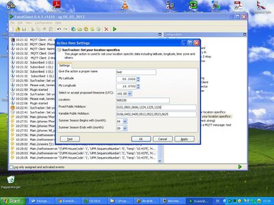

Here is the first version of SunTracker with the actions
- set plugin configurations for your location specific data including latitude, longitude, time zone and others
- vacation and empty house modes on/off
(find the official updated version in the first post)
Example screen shot:
Just to configure and execute and the plugin will be restarted and settings updated
It is of course still possible to execute the actions from a script the normal way like this:
eg.plugins.Suntracker.SetLocation(u'test', '18.07', '59.33', u'905335', u'0101,0501,0606,1224,1225,1226', u'0106,0402,0405,0512,0522,0523,0625', u'04', u'09', u'+01.00')
My best regards, Walter
