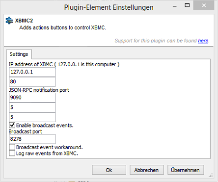

hey guys,
first thank you very much for this plugin and the huge amount of work you put into it.
Please forgive me if this has been asked a 1000 times but I've been trying for an hour now searching here in the thread and checking out whatever I could find. Could you please help me with the basic setup?
I am quite new to xbmc and try to get it running with eg. I installed the nightly from yesterday XBMCSetup-20121127 and I try to get notifications into eg. Sending commands to xbmc worked from the start...
Right now I am using the test version of xbmc2 from this post: Link
So this is how I set it up:
Here I tried any combination of ticking/unticking the options at the bottom to no avail
(in one post I read that broadcast is outdated and json is the way to go now, is ticking "Enable Broadcast events." meaning broadcast in general or is it just referring to the outdated (?) method over 8278?)

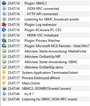

I opened port 9090 tcp in and out.
This is what I will get after starting up eg and doing the connect:
screen_mmigstation_2012-11-28_ 003.png (93.7 KiB) Viewed 6998 times
Whatever I do in xbmc I will not get any events show in eg logs...
I would appreciate your help very much!

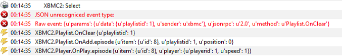

BTW:
I will get this when starting a video file:

BTW:
Thanks, there are some new event types that I haven't properly looked into so it's unrecognized but seems to generate the correct event.

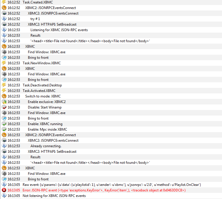

Luca Brasi wrote: BTW:
I get a similar error with Frodo, along with a file not found error.
