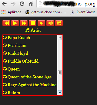

Posted: Thu Jan 16, 2014 8:07 am
by Pako
radenblazed wrote:... the problem is it works perfect with localhost but when i use my ip or http://**************.no-ip.org/ it does not work.
What does "it does not work"?
I connected to the address http://**************.no-ip.org, and it looks like this:
Although I do not hear the song, but I am convinced that it works.
