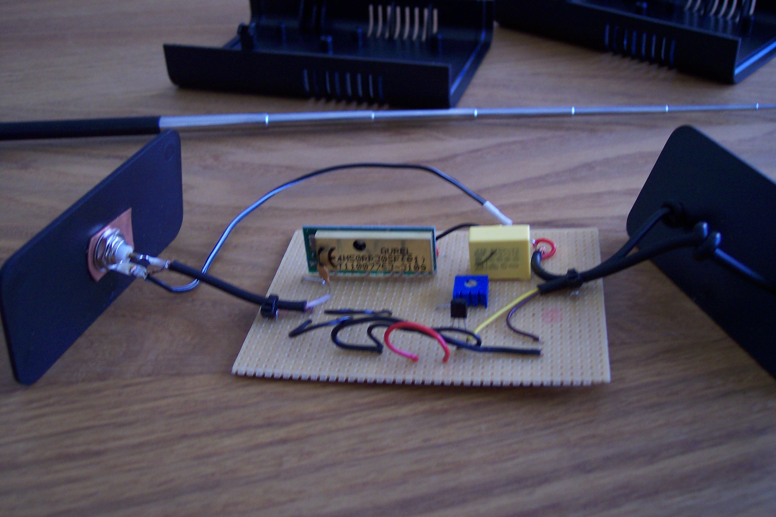

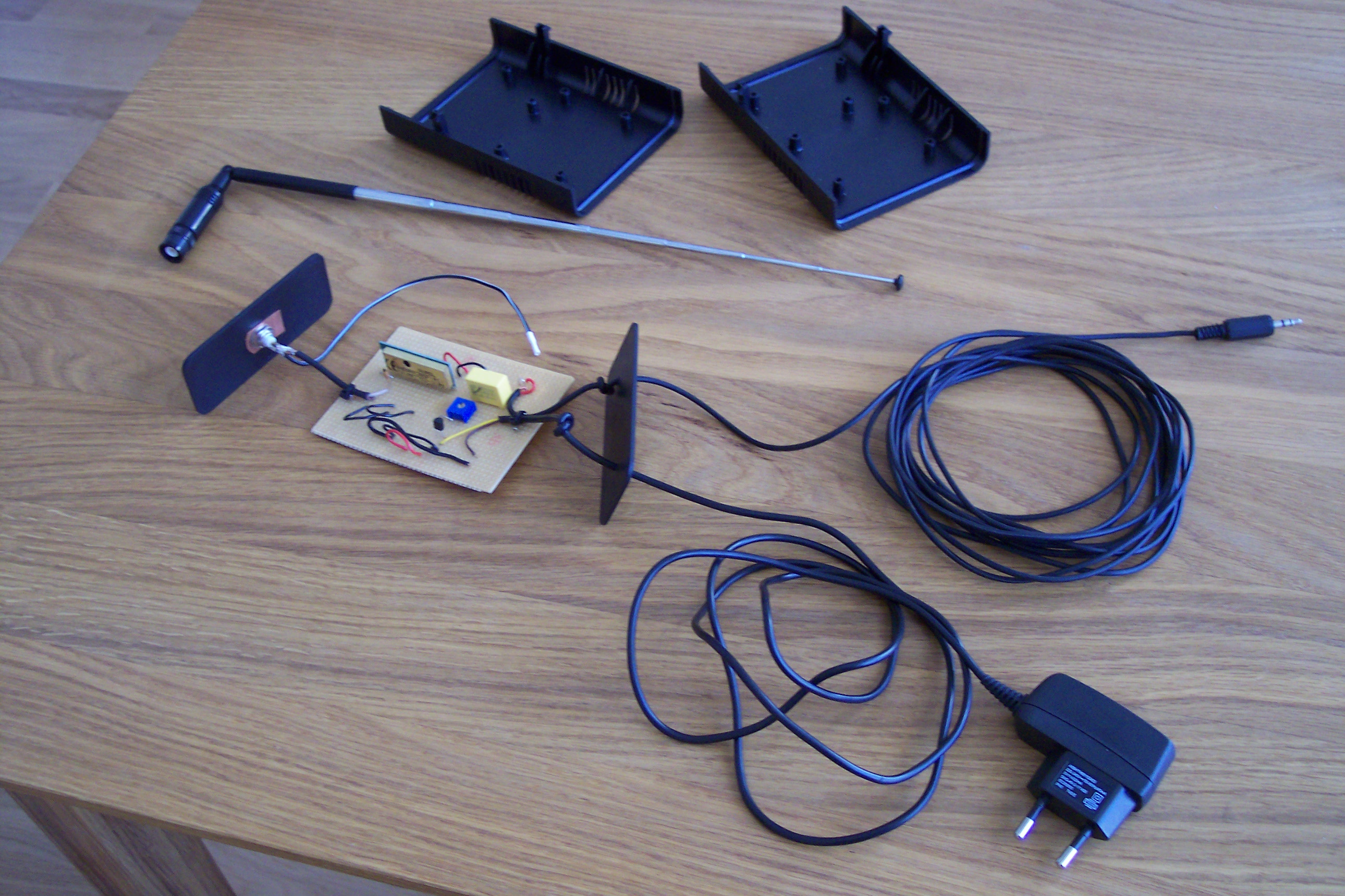

In the meantime, I have built a better receiver based on a standard receiver module from AUREL
http://www.aurelwireless.com/rf-wireles ... o.asp?id=7
I am very impressed by the sensitivity and coverage. The end result together with NetHomeServer is very good.
Here are some pictures. In a later post I will add a hand made schematic with the components I used. It was actually rather simple. I ordered the parts, including the receiver module, from CONRAD
Please do not forget the black/white wire seen in the pictures, it is an artificial ground
plane made with a wire counterbalance

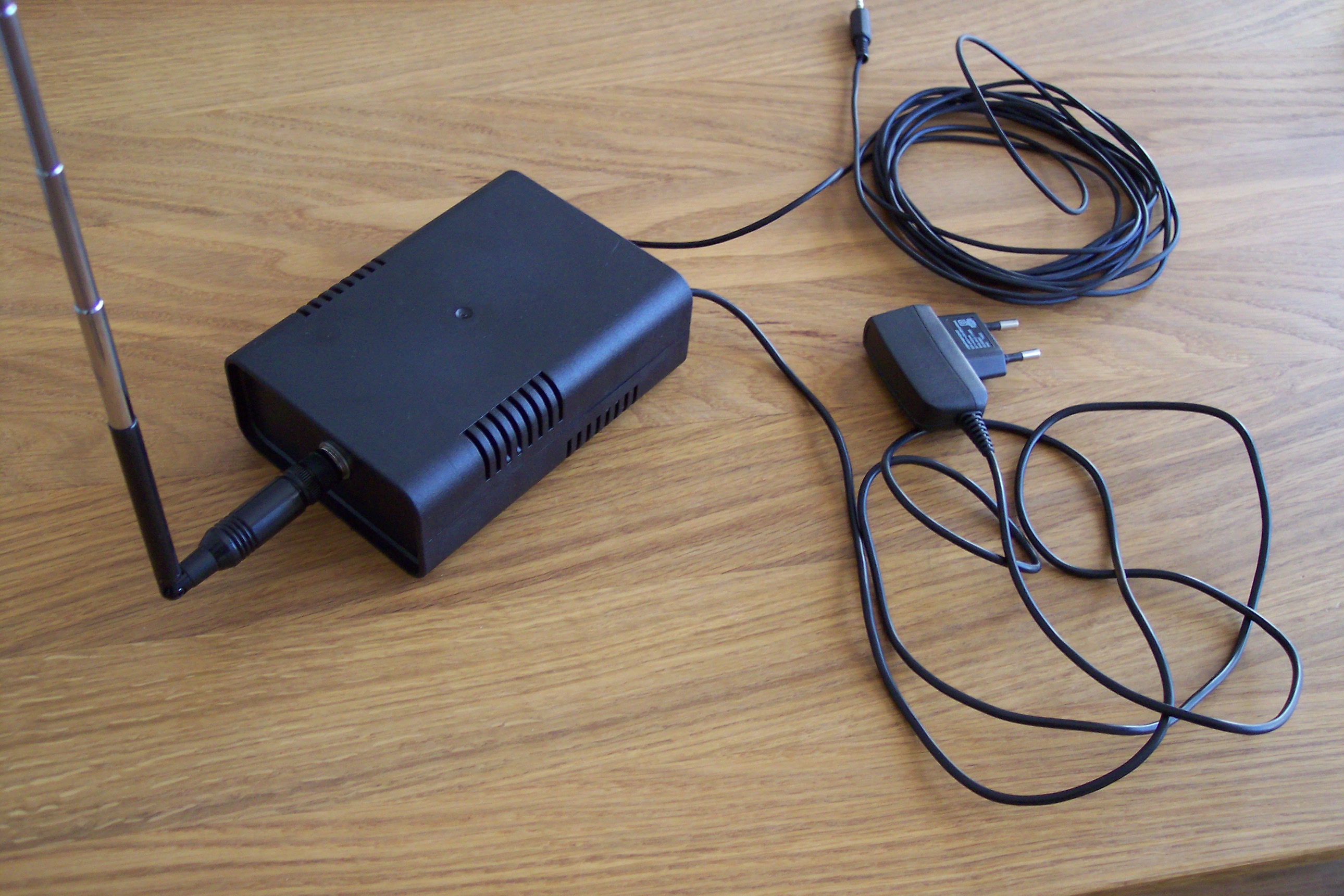

And the final result :D

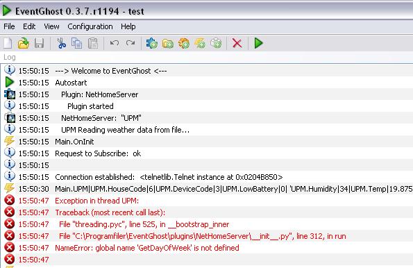

The rain sensor on the other hand crashes the whole plugin.

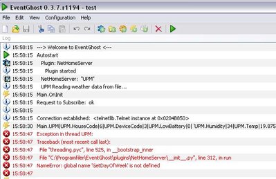

20:06:19   Exception in thread UPM:
20:06:19   Traceback (most recent call last):
20:06:19     File "threading.pyc", line 525, in __bootstrap_inner
20:06:19     File "C:\Programfiler\EventGhost\plugins\NetHomeServer\__init__.py", line 407, in run
20:06:19   NameError: global name 'rain_Week_levels' is not defined
20:06:19

I'm sorry for minor bugs, it will be a small pain until it works. Hopfully not too many
New version
(46.77 KiB) Downloaded 247 times

Error with rain sensor.
23:38:17   Exception in thread UPM:
23:38:17   Traceback (most recent call last):
23:38:17     File "threading.pyc", line 525, in __bootstrap_inner
23:38:17     File "C:\Programfiler\EventGhost\plugins\NetHomeServer\__init__.py", line 441, in run
23:38:17   TypeError: cannot concatenate 'str' and 'float' objects
23:38:17
Wind is still working like before.

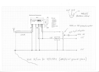

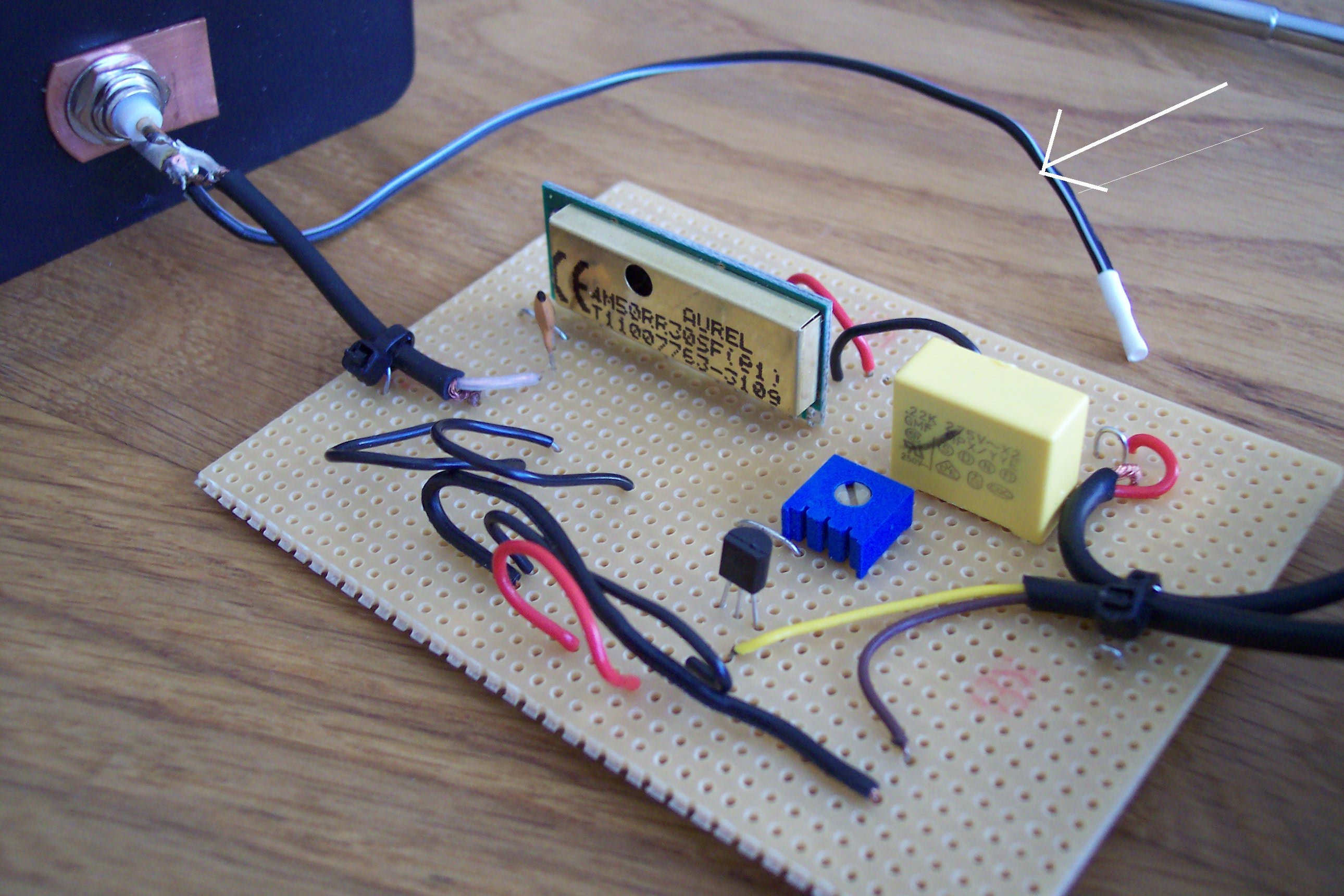

Below is the schematic, not the prettiest but still very functional :D
The components was ordered from Conrad (http://www.conrad.com where you pick your country)
I also found some stuff from my existing garbage collection like
- small colored wires
- thin shielded microphone and coax cable (I think I took that from cables delivered with a soundcard)
- the switched power supply (recycling of charger from an old mobile)
- the potentiometer (I think it is uncritical, I had 1 M Ohm but anything down to a reasonable load at the receiver output will do)
I ordered the items below from Conrad (took around a week to get them). Notice that I bought two types of antennas. I believe both are very good. The antenna on the picture above is my third type and it is also rather similar to the rest
Art nbr: 27453
Name                           EUROPAKORT 100 x 160 LÖDBANERASTER
Art nbr: 183024
Name                           IC78L05100 MA
Art nbr: 190264
Name                           Receiver module 433.92 MHz
Art nbr: 115142
Name                           Receiver antenna 433 MHz
Art nbr: 190073
Name                           433 MHz ground plane antenna
Art nbr: 458139
Name                           MKS 4 polyester capacitor
Art nbr: 523100
Name                           Half shell case
Art nbr: 740764
Name                           BNC-connector

Thinking about this antenna 115142 witch you sugjested i have to go trough 2 walls to the outside of the house for the wind and rain sensor. Do you think it is good enough. Or should i go for the "433 MHz ground plane antenna" looks big. The antenna from your photos where did you get that?
After quick overlock i noticed something witch i cant find on your drawing or list, maby im just blind.
Also is there any need for the coax cable? Wouldent it be just as good to go straight with ordanary 1 wire cables to the conector or is this something to do with range? Did you consider puting a USB sound card in the box also and go without the audio cable but usb cable instead?
Opening and soldering straight to something like this with goes for almost nothing(1,5$ with shiping) on ebay.
Best Regards, Jostein
Hello Jostein,
Regarding testing of the plugin, I have identified I have some problems/errors in the calculation routines of the collected data. As mentioned, I have a simulation mode so I'm actually running as if I had the rain & wind gauge.
I will deliver a version when I see that it calculates correctly, you do not need to test more for the moment, better wait
Regarding the yellow thing in the picture, it is the polyester capacitor of 0.22 micro F (in my case, recycled from a slaughtered Nexa receiver)
Brilliant idea of integrating the sound card directly, it will be next on my upgrade list. Should be straight away and easy to achieve. Actually, you can maybe also take the power supply +5V for the receiver from the USB as well
I used a short thin coax between the antenna and the board to get the correct total length of the antenna. Otherwise you need to add the length of the wire to the antenna length itself and then it will be longer than 1/4 lambda (maybe not critical but...)
Also used a shielded cable for the microphone input due to that I wanted to keep the receiver far away (10 meters) from my PC and other stuff. But with integrated sound card, this is of course not needed any more
As for the antenna, I see that you now suddenly have another option to put the whole box closer to outside, using a long USB cable. Otherwise the ground plane antenna is not very big, it's rather nice and has a magnetic foot so you could arrange a good ground plane by putting it on steel plate on the outside, the receiver close on the inside and then run a USB cable to the computer.
Kind regards, Walter

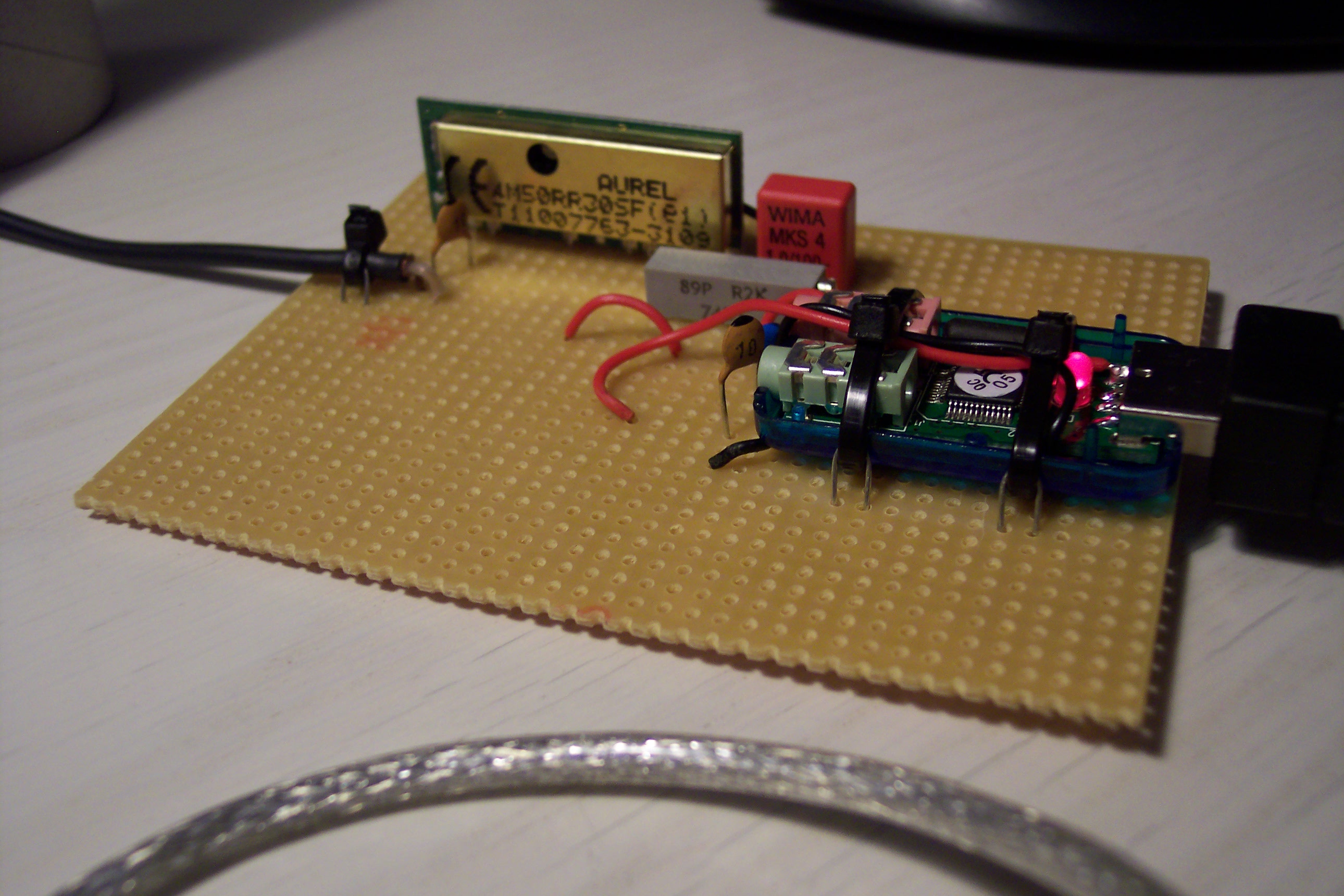

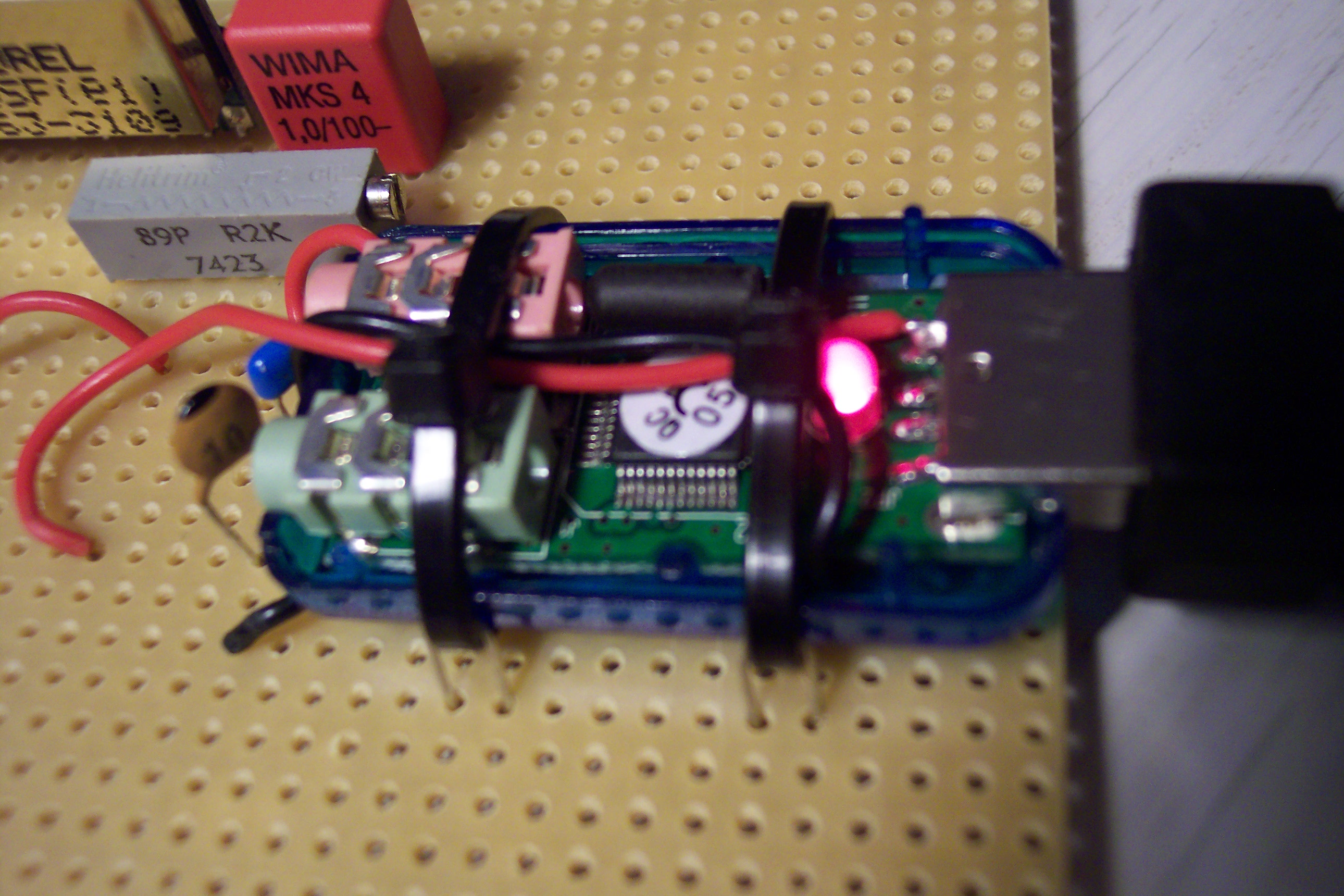

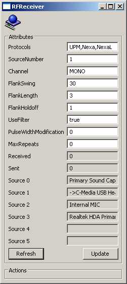

Edit: I can confirm that the idea of using/integrating a cheap small USB sound card worked very well indeed. I was also able to power supply the whole receiver directly with the 5V that was available. The 78L05 was not needed anymore. Picture will be posted later
Here are the pictures of the other receiver that I built using the USB Sound card dongle.
The schematic earlier can be used as basis except that you do not need the power supply regulator 78L05 any more
Besides this, I used a potentiometer with 2,2 kOhm this time and it worked just as fine. I also tried to add, as you might see, some additional capacitors to filter a bit but with no difference
The receiver is a bit "nervous" on the output (due to the high sensitivity I assume) but it doesnt really matter. NetHomeServer filters out and decodes the correct messages anyway. I adjusted the output level with the potentiometer to a minimum while looking at the output level in the analysator. The settings I'm using are as follows (but can be dependent on the USB dongle):
EDIT: After using/testing a while I have changed my settings quite a lot. The above picture shows my new settings
