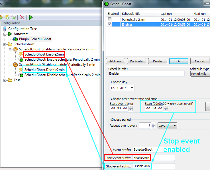

I don't think I understand the Span value. Is it possible with SchedulGhost to have a Periodic event that only happens during certain hours of the day? I want to trigger an event every 20 minutes from 0800-2300. I get an error when putting in a Span value (thinking that a Span of 15:00:00 + 08:00:00 = 2300).
Could someone clue me in? Thanks.

kkl wrote:I don't think I understand the Span value. Is it possible with SchedulGhost to have a Periodic event that only happens during certain hours of the day? I want to trigger an event every 20 minutes from 0800-2300. I get an error when putting in a Span value (thinking that a Span of 15:00:00 + 08:00:00 = 2300).
Yes, it is obvious that you do not understand the meaning of the span.
And even that is very helpful to your case. :D
But you'll need one extra schedule.
The attached picture is an example.
I believe that now you'll understand.
