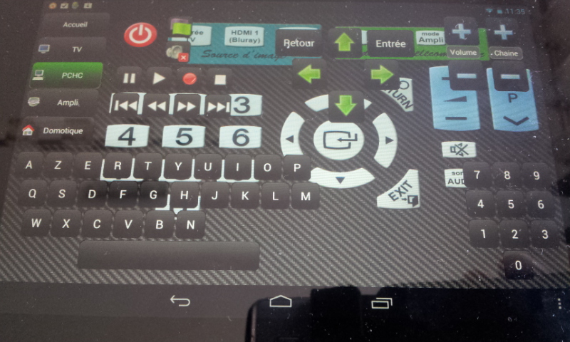

Hi Chris, and thanks for this update.
I always have my bugs on the your last version :
-On startup, i can't use the internal "switch layout" function : it doesn't works ; I have to use the hidden menu on the left, choose manually a layout and after this, all work perfectly.
- If I lock the screen, and unlock-it with the "drag function", I have multiple backgrounds at the same time on the screen ; on the previous version, they simply not appear... But this app is always the best one !!!
Best regards.
Best regards.
