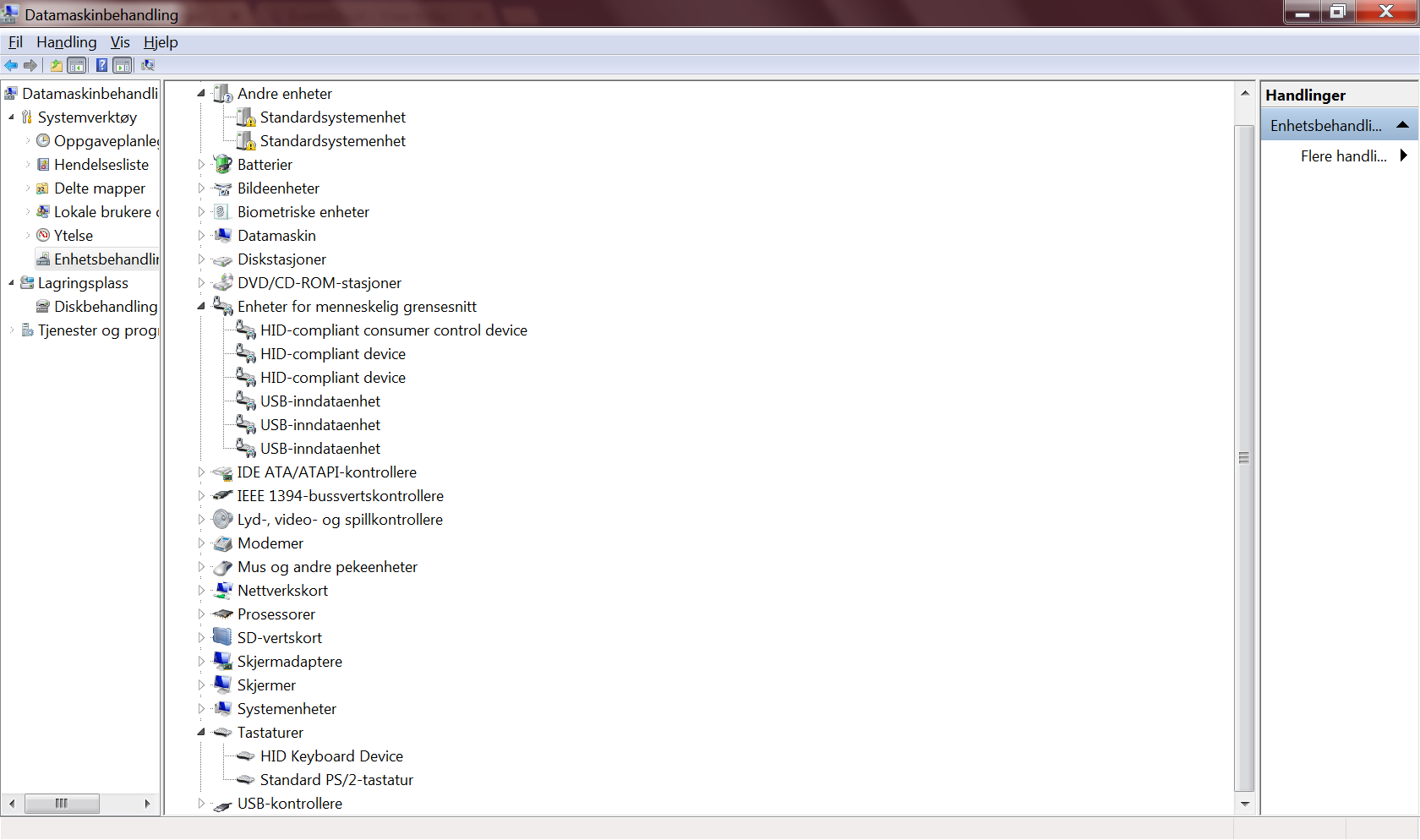

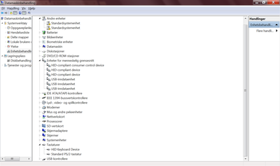

I tried to remove everything, from driver to EG. Downloaded the new version (released 09 june) and followed the guide again, same result.
EG finds the phx remote, but as usual it wont install the driver for some reason. Or.. It installs the driver, but EG can't get it up.
Posting a zip with picture and the xmlfile.
- eg.zip
- (142.63 KiB) Downloaded 175 times

blodskjegg...
Your XML configuration file is also fine.
After translating the Norsk log, I see that the error message is:
GetUncPathOf Error: 1200 The specified device name is invalid
I am not exactly sure where that error message is originating from, so a little detective work might be necessary.
Certainly, this is not a problem specific to the PHX01RN, I think you would have similar problems on this machine with some of the other remote plugins.
However, there are two things other that I can think of:
1. There may be something that is blocking access to the USB ports. For that, you will need to look in TaskManager to see what Processes are running.
2. Your mediacenter hardware. There might be something like an iMON on your motherboard which could be causing us some problems. I do not know very much about the iMON, but it would help if we can identify what kind of system your mediacenter is. Once we know that, it might be possible to figure things out.
Those are the only two things I can think of right now.
If it is some kind of iMON device, then there are plugins here, for the iMON, which you could use instead...

I think our best move now is to look at Device Manager.
Look at Procedure 01 and follow the steps shown in the section that starts with 'Open the Windows Control Panel'
Expand the Human Interface Devices section and do a screen capture of it for me.
That will tell us about what devices you have on the system.
The Logitech keyboard and mouse may be the problem, but a screen capture will give us more detail.
Thanks.

blodskjegg
- Posts: 15
- Joined: Mon May 05, 2014 11:08 am
Re: PHX01RN remote control plugin
Ok, here is the picture:)
Tastatur = keyboard
enheter for menneskelig grensesnitt = human interface
Tastatur = keyboard
