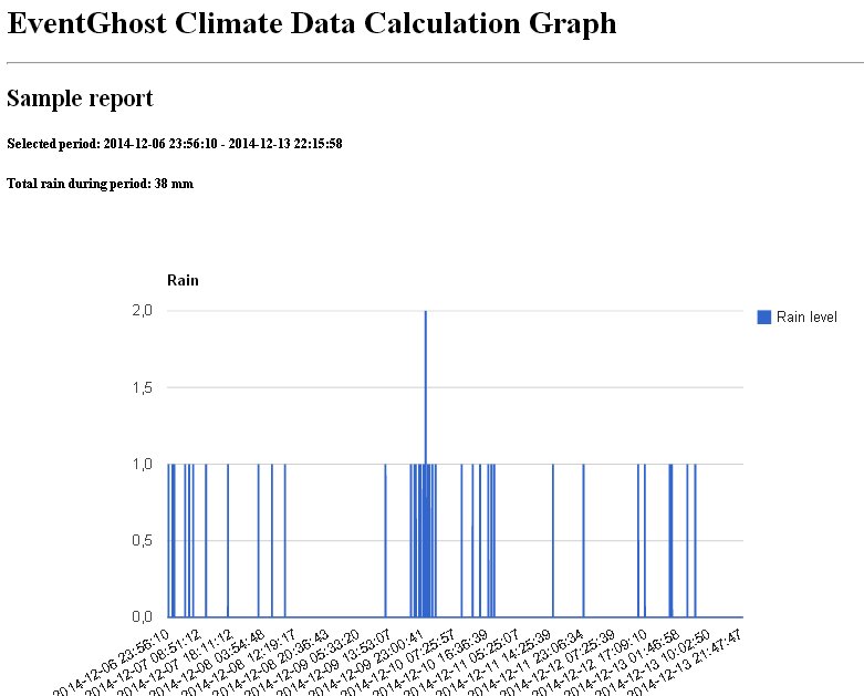

PS I can confirm that it looks as bad for me as well when I run the rain report so I now have something to investigate in detail. If you run the new Combo report and only select the rain part, it looks more normal I would say (even if the curve is rising)

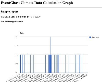

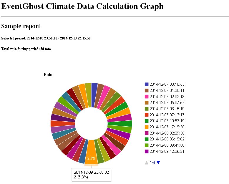

I have experimented a bit with your data and various charting options and I have found that your data is actually correctly presented (the smoothing options was somehow distorting the picture so I have removed that in the line charting example below). Your data is changing very little when it changes, when it changes it is mostly 1 mm, in one reading 2 mm. Most of the time there is no change and those readings are most likely of no interest I guess.
So now the question how this could be best presented. The line chart (it is actually a line and not bars) is one example and the donut is another. I think the donut is not so bad because it gives a view where you can identify readings of various sizes (which is also true for the line chart...) but the pie chart has one more advantage, it only shows readings when the rain level has changed.

Well, that's a hard question. I must admit that I really like the line graph, when that's possible. I'm afraid the donut is a bit to confusing for my use (it must be readable both by me, my wife and my parents, who use the cabin four weeks every year). But maybe the line charting would work better with shorter and broader lines and a longer X axis? I have the Yr (Norwegian metereological institute) setup here. This would be ideal for a two day span. Never mind the other lines and symbols in the graph, just look at the rain bars, and don't mind that they are different color. That's because they are predictions, not statistics, so they show maximum and mininmum predicted rain.

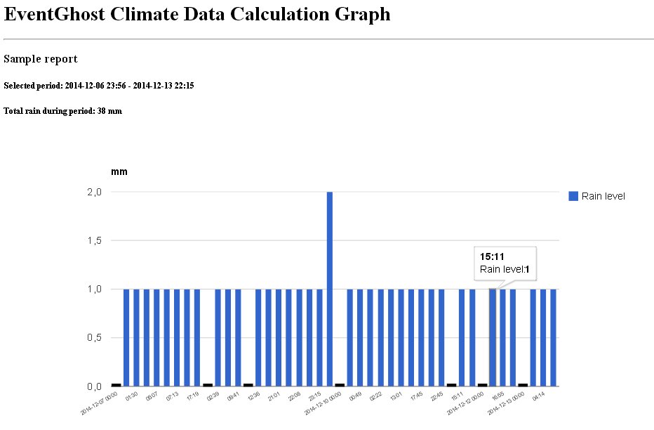

This is an updated version where I have tried a lot of various options in Google Charts. It is not perfect but it gives a better overview. Some words to the rain chart below:
- it includes bars only when the rain level has changed from previous reading
- I have added a small black bar when the date is changing giving some understanding how much it actually rained during a day
- sometimes you see the date & time value on the x-axis bur Google Charts is scaling the x-axis automatically and I have not figured out how to control it better
The separate temperature & humidity reports have been omitted since they are superseded by the combo report that can do the same.

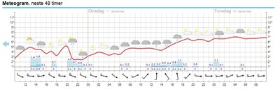

Thanks, I liked that graph a lot more! But one question: Can it be editet to show all hours of the day, no matter if it has been raining or not? So it's just like the one I showed you from Norwegian meteorological institute Yr a few posts back? That would really make the rain part perfect for me.
I see that you have changed the temp to time and date in the combined report too, so thanks! The only thing missing there would be a similar setup as the Yr, with mostly time. Or maybe that's not possible with the Google graph choices?

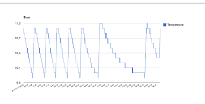

Thanks! I see what you mean about that automatic scaling, yes. Does the Y axis scale automatically as well, or is it possible to lock it at a certain range, like 5-25 degrees? The combo report got a bit of a weird effect on this, as you see in the attached image. I have no idea where those big jumps comes from, it looks very straigth.

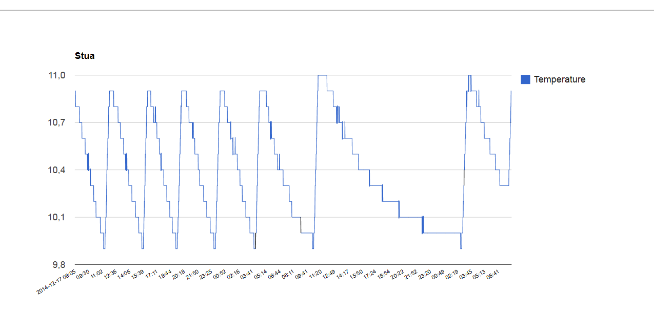

Yes, it does, it might be there is an option to avoid automatic scaling on both axis but I have not looked that deep into the myriads of available optionsDoes the Y axis scale automatically as well
Your temperature in your stua is only changing between 10-11 degrees so the thermostats seems to be working fine. In the chart everything is blown up due to the automatic scaling...those big jumps
I think you are right, either find another library better suited or learn more about all Goggle Charts options

OK, thanks! And yeah, the thermostats is no problem. It's just the scaling of the graphs that I would like to block completely. From what I googled up it should be possible by setting absolute minimum and maximum for the axis, I will try to play a bit with the data. Probably on a separat VM, since I no doubt will f*ck it up the first five times!

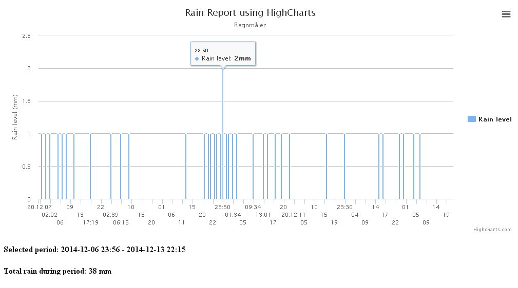

I made a sample using Highcharts that could be of interest to test. I have also made an experimental solution for a dynamic update of the x-axis, it is trying to adopt the scale to the actual number of readings in the chart. I have only worked with the rain report template (the combo is still unchanged and pending for upgrade later)
The good news is that I think Highcharts is better suited for this purpose, it is actually really nice. The bad news...I have not found any

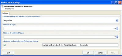

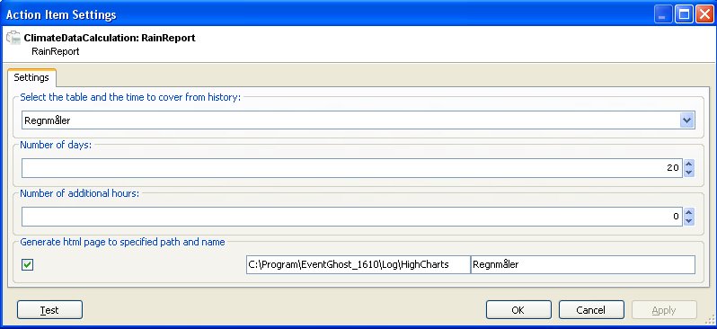

What you have to do:
1) rename the old 'CreateHtml.py' file and put in the attached one instead 2) download & unzip Highcharts free version to a directory of your choice
3) restart EG and define or edit a Rain report configuration action (it is important that the report is being saved to the HighCharts folder
4) run the action and a report will be generated
5) open the report with a browser
Once you have the report in your browser, try to zoom & pan, it works very well
Best regards

Fantastic!
