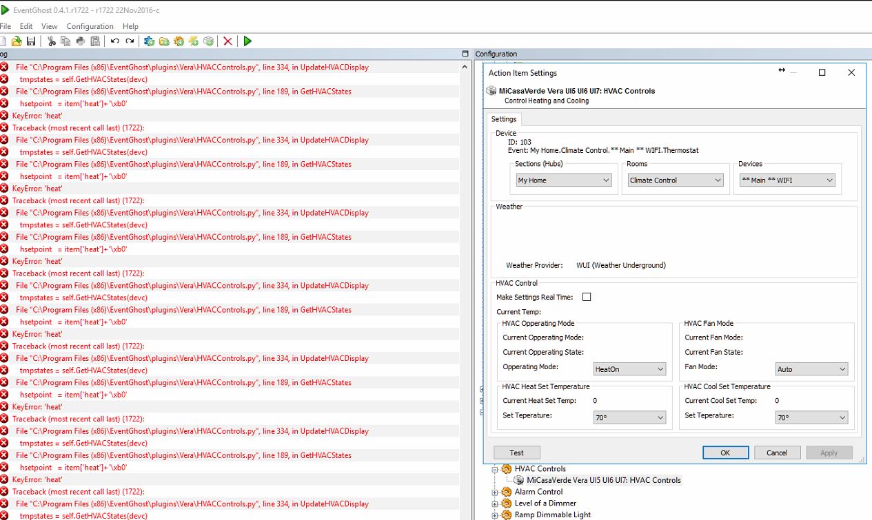

Re: MiCasaVerde Vera UI5, UI6, UI7 Plugin
As is typical, one problem solved, new problem arises. I finally got around to installing the current version. When I open the HVAC Control configuration, I get a stream of errors in the log. See screenshot. It appears that the data is updating in the Weather section of the configuration screen as this is happening.
2nd question: Is "My Home" hardcoded, or is the name definable somewhere?
Thanks.
Thanks.
