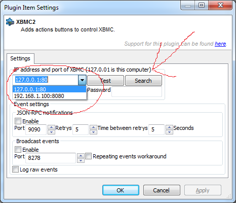

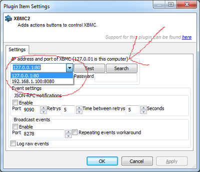

I'm really proud of the new "Search" button, seen in the screenshot below:
You press it and EventGhost locks up :twisted: after some seconds you should have a list of IP addresses for any XBMC on the network (As long as UPnP is active in XBMC).
The "Test" connection button seen in the screenshot should help in testing that the settings are correct. It will get even better when its finished.

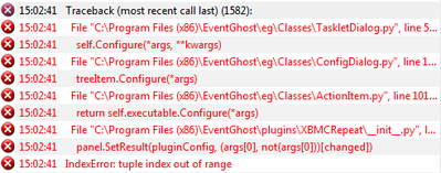

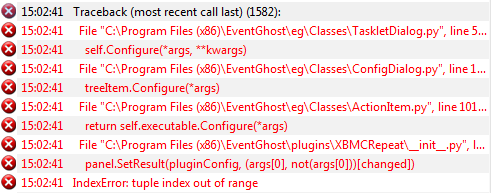

I got some errors when trying to add the plugin...
Any idea what it might be?
Samme wrote:I got some errors when trying to add the plugin...
Hmm, did you use a previous "test" version before? Do you know which one?
Anyway try to download the updated one.(same link) Thanks for testing and reporting.

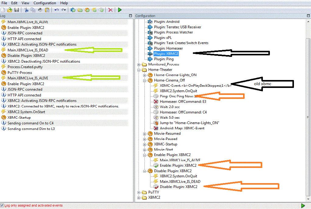

There was still one more problem when XBMC Frodo shutting down. The shutdown is so fast that it errors out that it stops responding on the next reboot.This is because JSON-RPC gets no chance to respond on shutdown but sometimes does.
You shutdown the computer from Frodo? And what stops responding on the next reboot? This sounds kinda serious so want to understand exactly the problem and hopefully fix it.
So I use the PING plugin with the action "ping one now" which gives two events of XBMC dead or alive. I created 2 macros (XBMC_is_DEAD = Action: Disable:Plugin:XBMC2) and (XBMC_is_ ALIVE = Action: Enable:Plugin:XBMC2). Works like charm with an occasional error when XBMC shuts down too fast.
Glad you found a workaround, but I don't like it if you need to disable the plugin as its meant to work always enabled.
Thanks man, for the quick response.
I use the iPad with an application (XBMC Constalletion https://itunes.apple.com/gb/app/xbmc-co ... 07301?mt=8). It shows all metadata plus remote control for my remote stand alone installation of XBMC (Pulse Eight), i.e with wifi and Eventghost running on my remote Home Automation Server. The XBMC shutdown process is instant which does not give Eventghost enough time to process the shutdown events causing the XBMC2 plugin to hung. That's why I created the disable/enable XBMC2 plugin with the ping plugin if XBMC is found to be dead/alive respectively.
Apparently the recent version you posted seems to work fine with the Windows version of XBMC with no errors. And I believe this is due to Eventghost and XBMC being on the same computer. All types of events are shown.
Thanks again man.
Eman457.
eman457 wrote:The XBMC shutdown process is instant which does not give Eventghost enough time to process the shutdown events causing the XBMC2 plugin to hung.
Just because XBMC closes fast there shouldn't be any problems for the plugin, it would just lose the connection and wait for a new one. What is the shutdown events that's making XBMC2 hang?
I just can't figure out anyway that the plugin would hang when XBMC closes.

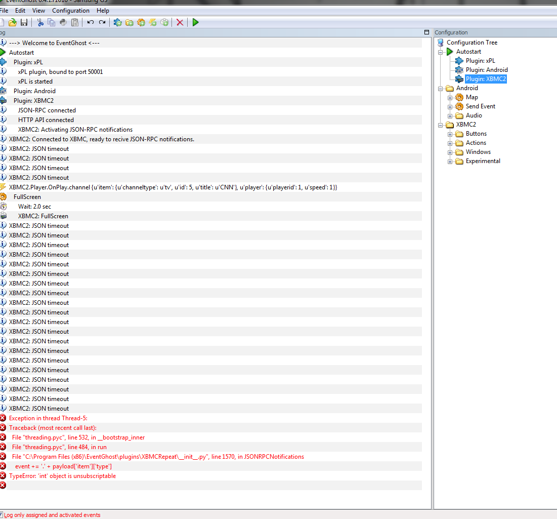

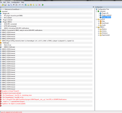

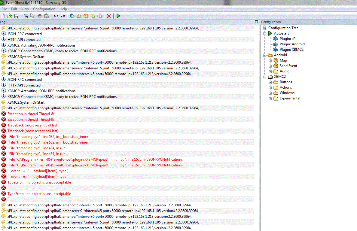

Ok this is what I get when I run it on the local computer
Local XBMC
Local XBMC
This one is XBMC stand alone installation with the same plugin.
Remote XBMC
Remote XBMC
Edit: Only one thing I can think of, would you mind uncommenting line 1535 (just remove the #) then see if you get "XBMC2: JSON timeout" in the log after you have shut down XBMC and XBMC2 gets hung. I want to see if the plugin still thinks it's connected to XBMC.
And this is when I have edited the file.
Remote XBMC
Remote XBMC
Regards.
Eman457.

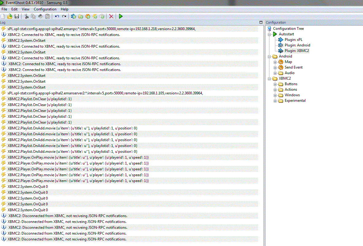

It works well for me, thanks, just had to change the port to 8080 and it was away.
XBMC2: Disconnected from XBMC, not reciveing JSON-RPC notifications.
There's a typo in receiving, but otherwise it seems good for me.
blaher wrote:It works well for me, thanks, just had to change the port to 8080 and it was away.
Thanks for the report. But just wait and the bugs will get ya.
Damn typos, they keep following me, why cant they just leave me alone. :x :lol:
eman457 wrote:Ok this is what I get when I run it on the local computer
OK, looks good except that I'm seeing double (times five). Have to fix the thread handling.
So the red text is when XBMC2 gets hung? this is useful to me and something I can fix (hopefully).
Thanks for testing, you can change it back as it was not relevant. I just missed testing for this problem.

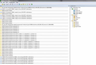

blaher, works well for me too on local XBMC.

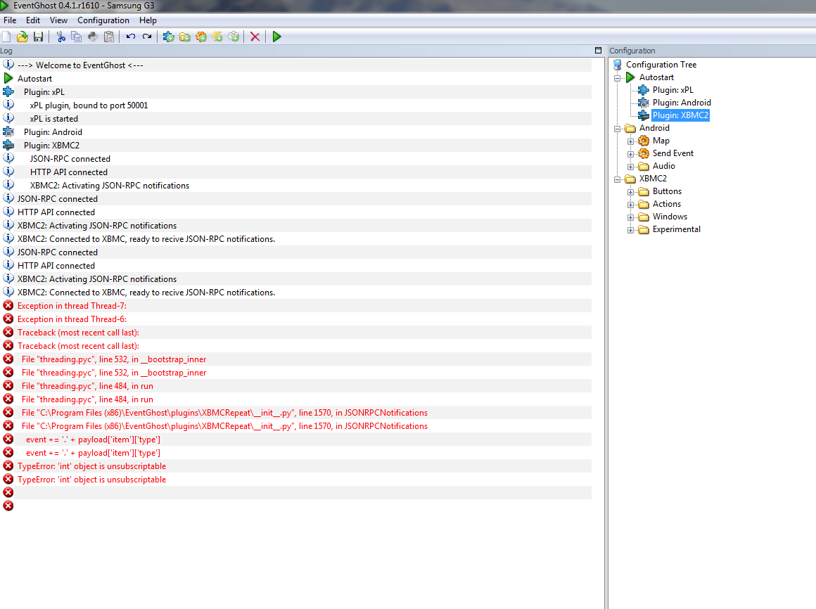

The problem is with a remote bare metal installation media centre as you can see from the image bellow.
Remote bare metal install
As you can see on start up everything is fine until you reboot or shutdown from the remote end using the iPad/iPhone app XBMC Constellation (https://itunes.apple.com/gb/app/xbmc-co ... 07301?mt=8)
The shutdown/reboot process is so fast thus causing Eventghost to error and causing the XBMC2 plugin to hang.
Regards.
Eman457.
eman457 wrote:The shutdown/reboot process is so fast thus causing Eventghost to error and causing the XBMC2 plugin to hang.
Try update2, it should fix and/or give more info about the problem.
