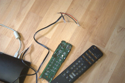

haha I finally got my home-made blaster to work with your new plugin. The emitter needs to be less than 3 inches from the device that I am trying to control, but I guess that's how the mce unit is supposed to work. It would be nice if I could amplify the signal somehow but I don't know anything about that. It is probably a very simple circuit for someone who knows how.
I'm attaching a pic of my hacked together blaster along with the remote that I stole the emitter from. You'll notice I don't even have any electrical tape...
