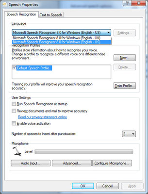

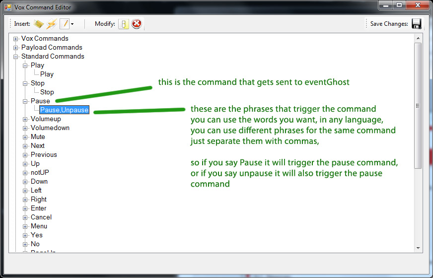

I noticed some talk about getting vox to understand german. I believe the solution is as follows.
First of all you need to edit the command tree, so that the phrases you want to use are written in german. Vox is completely customizable:
Also, you need to set the default language in windows control panel speech advanced settings. This is the same place that you select your trained profile if you have more than one.
on my version of windows I go to Control Panel\All Control Panel Items\Speech Recognition and then click "advanced speech options" on the left panel.
I hope this helps.
