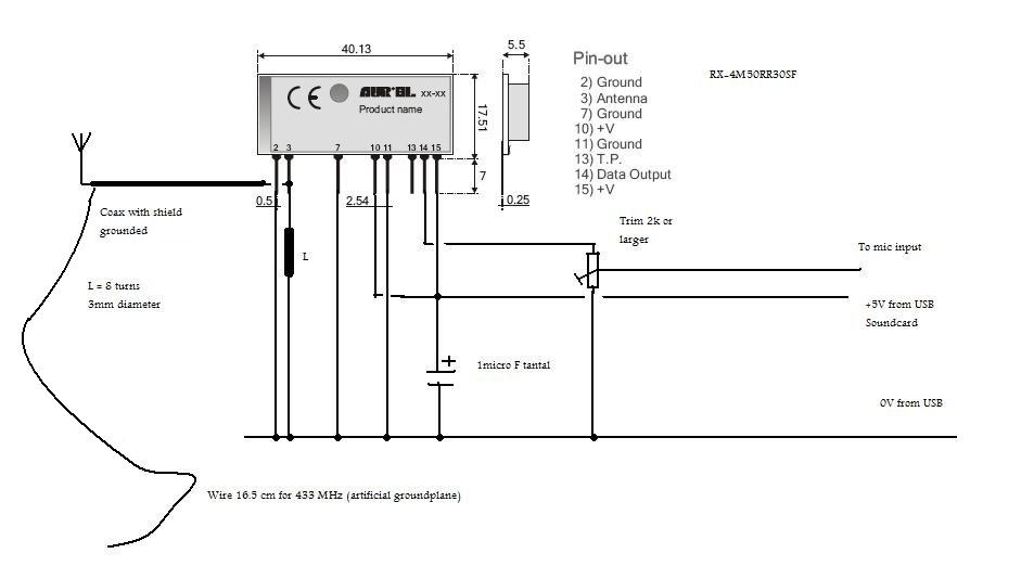

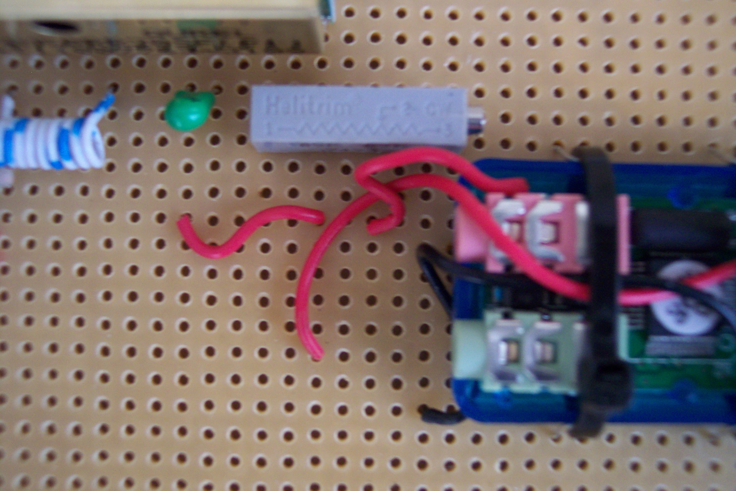

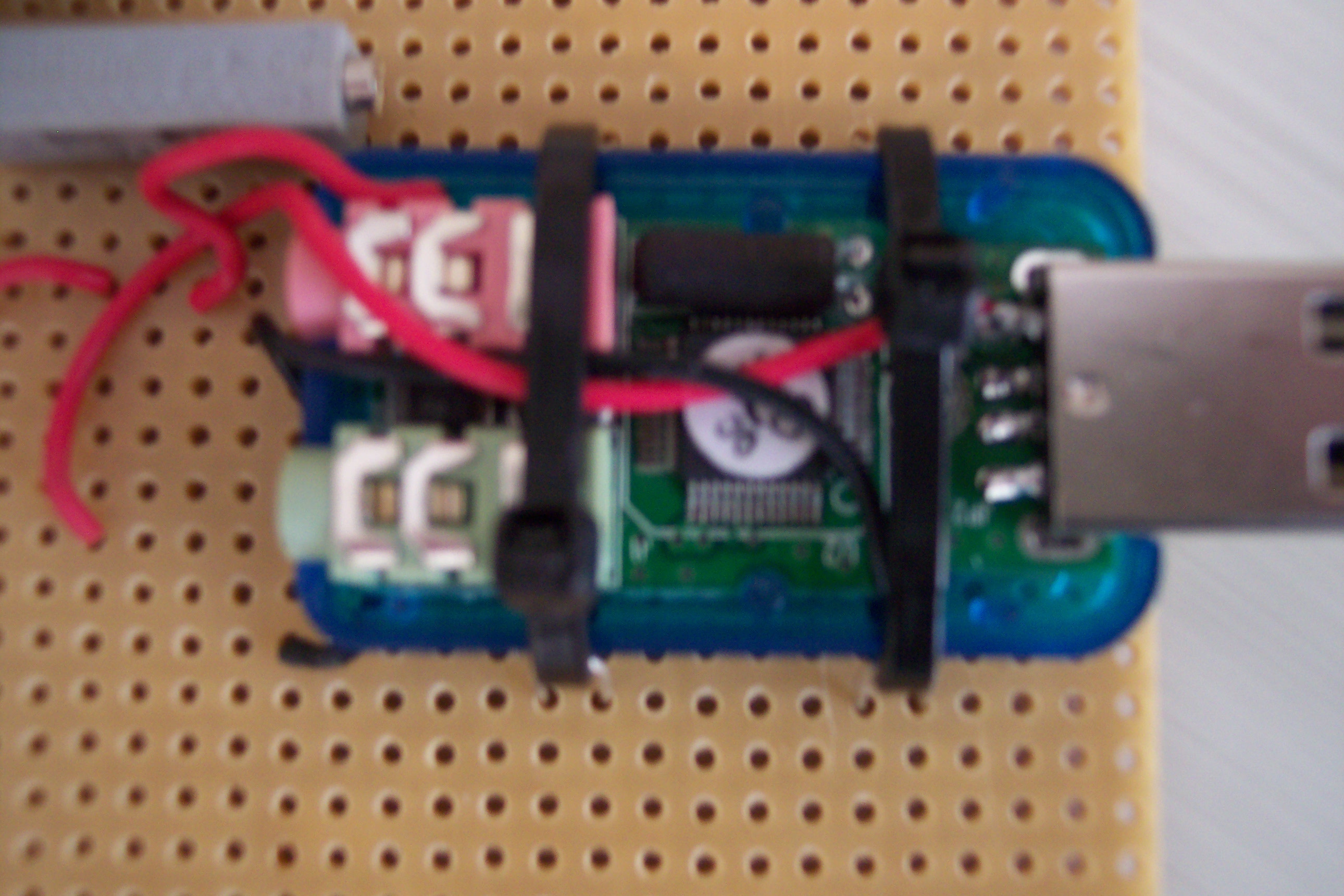

To improve the shape of the received signal:
If you have built the receiver with integrated sound card as shown in the picture above, pls remove the capacitor and connect the input on the sound card directly to the potentiometer mid pin instead

Unfortunately I am not experienced enough to se how to build it from the last pictures and the schematic for the - 3,5 mm sound-jack-version.
Is it possible for you Krambrew to make a new schematic and in addition take some new pictures to show how to connect signal to and power from the USB sound card dongle?
Best regards
Yes, within a short while

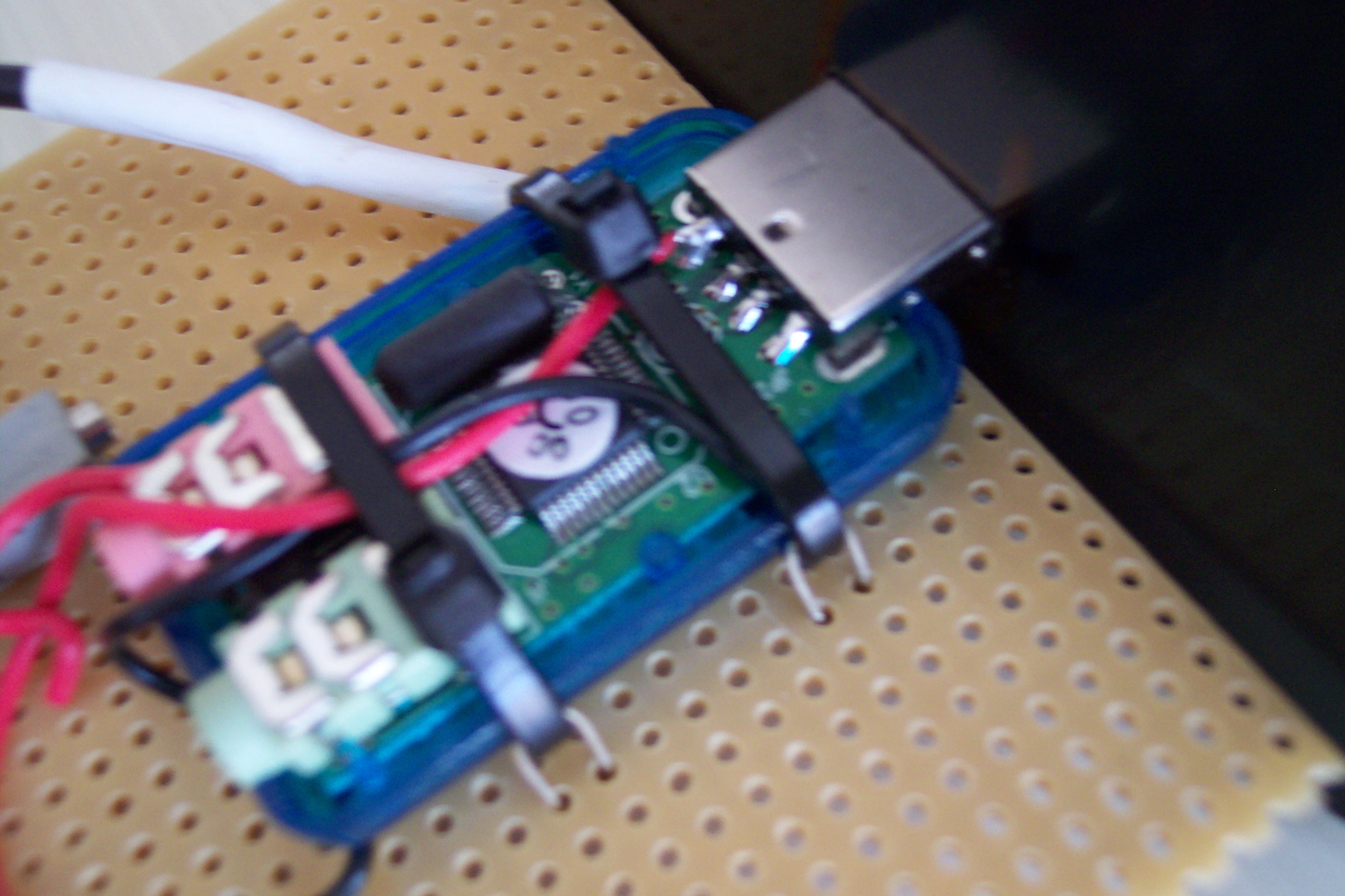

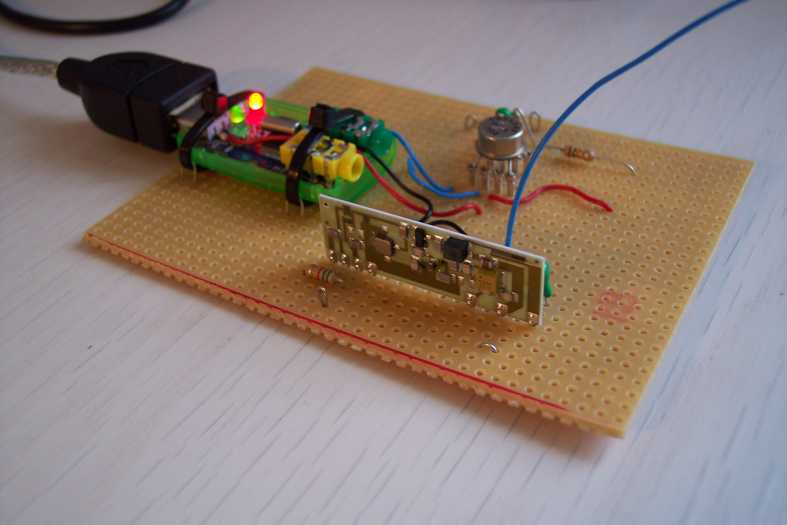

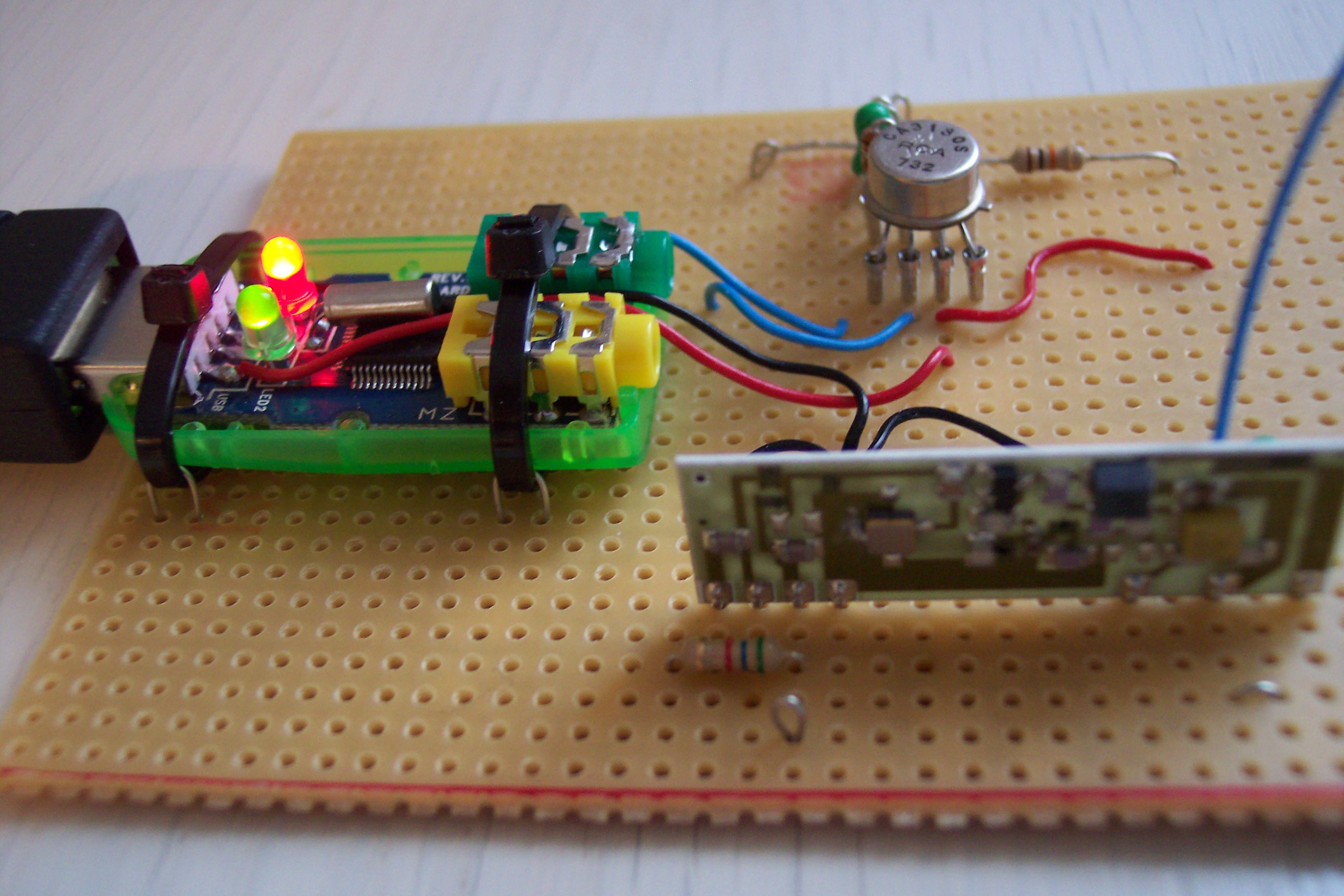

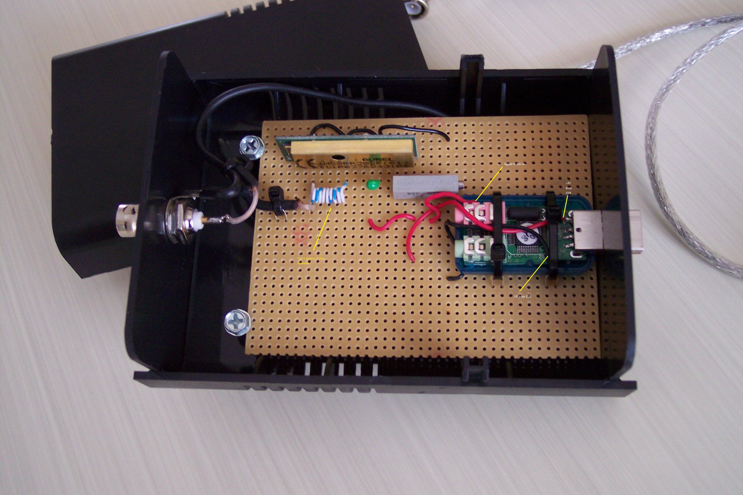

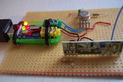

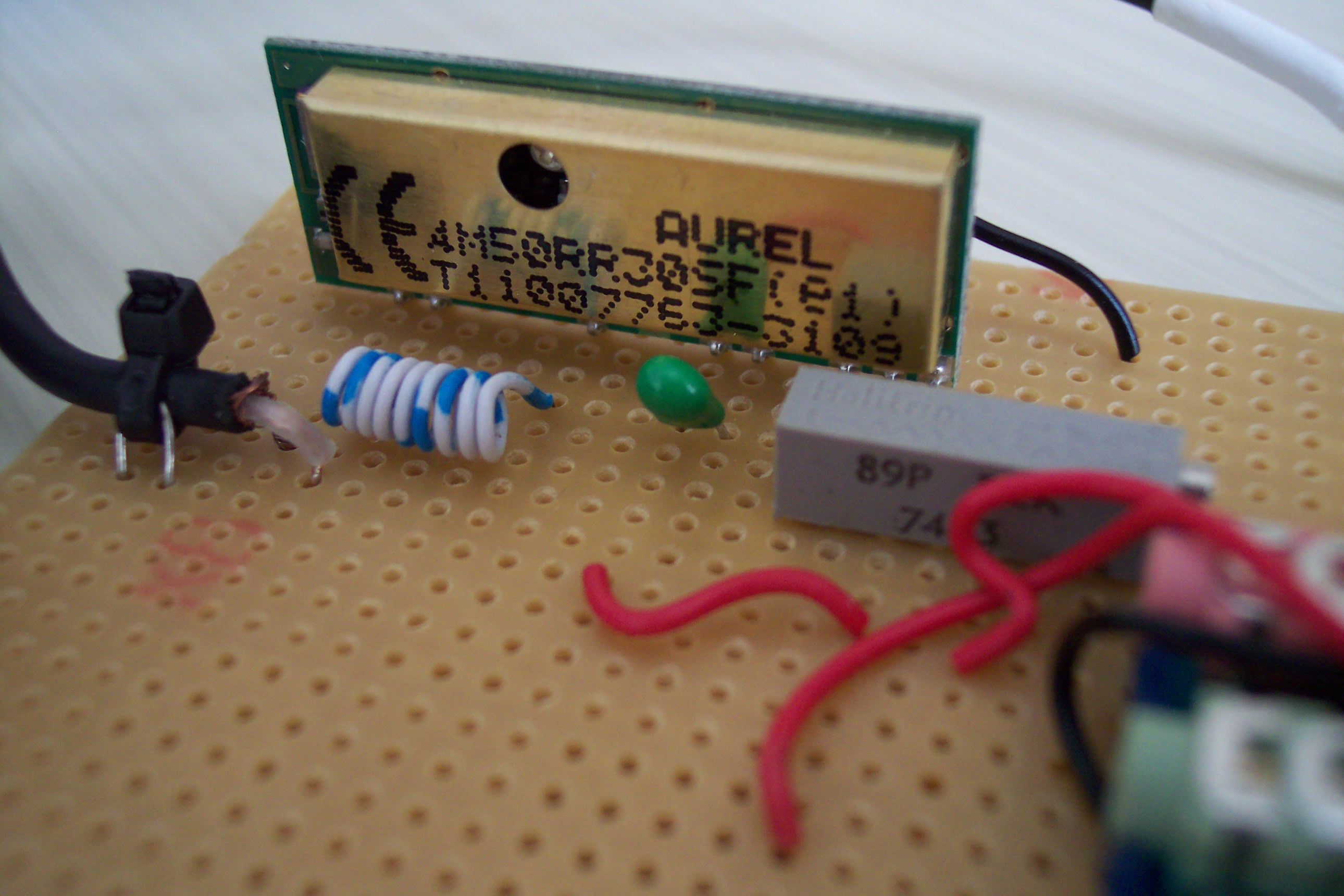

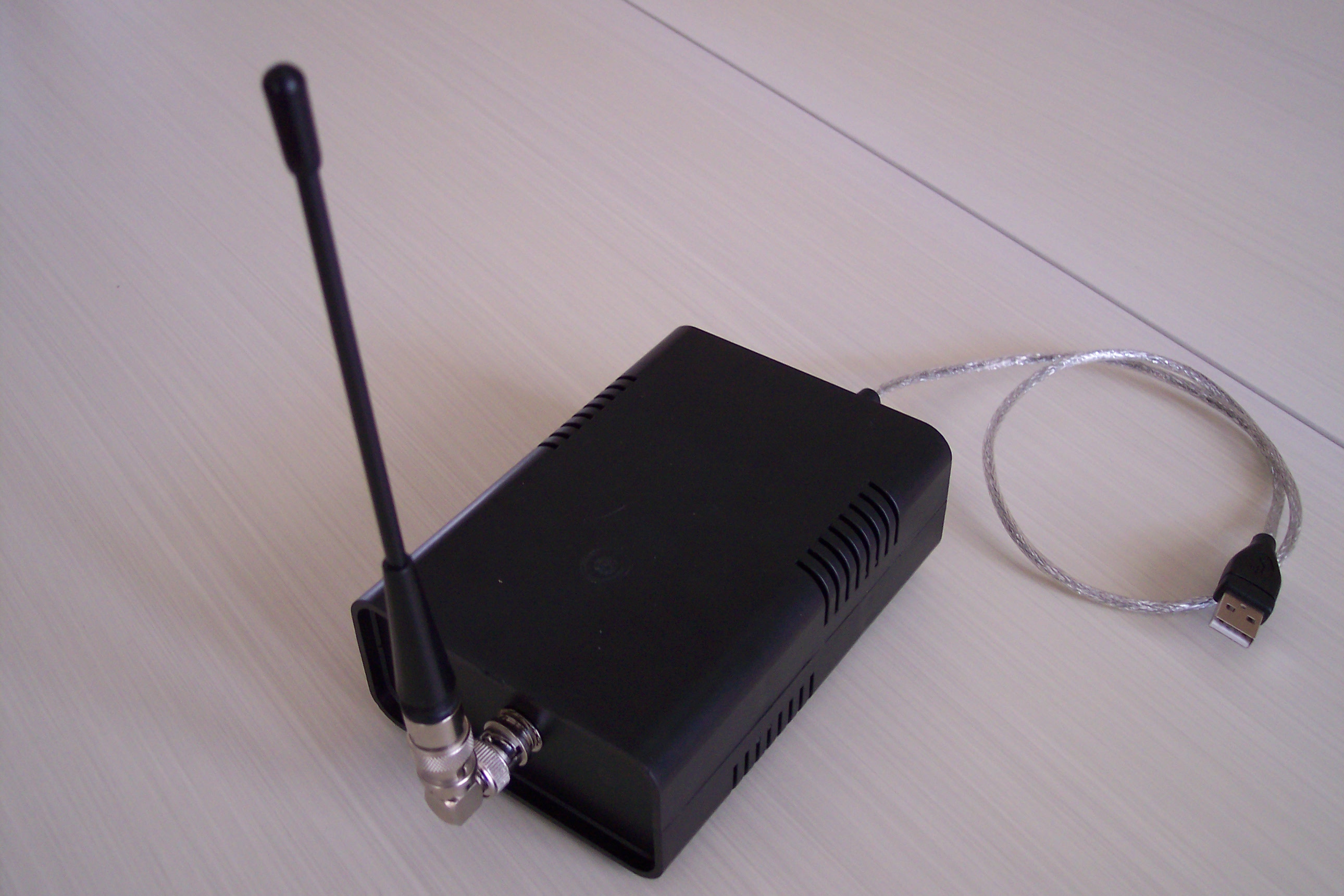

After experimenting a while, this is the "final" design of the receiver using the modul from AUREL
Pictures & schematic "made in paint" below

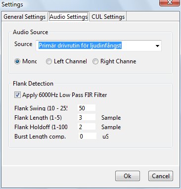

Here are my settings that gives best result so far

I have just made a small modification to the schematic above. When you make the virtual ground plane with the wire, it should be connected to the end of the coax shield at the antenna BNC connector. The other end of the shield must be connected to 0V (grounded)

I thought it would be worth mentioning my latest experiments in electronics
I took the challenge to build a transmitter using an AUREL module and I can tell you it works superb :!:
The build is not too ugly (but not the prettiest either)
Basically I'm using the module TX-SAW433/s-Z RFM
http://www.aurelwireless.com/rf-wireles ... o.asp?id=9
together with an USB sound card and some additional components like an OP amp etc
I found a place to buy it and other components here
http://www.soselectronic.com/
As for testing, I was very pleased to notice that the pronto code support works all the way from EG to the lamps :D
I will make a schematic with a component list the other day as soon as some time happens to be available
