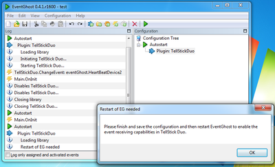

I'm having instability issues with the TellStick Duo plugin.
For testing purposes I have a fresh installation of EventGhost 0.4.1.r1600, TellStickDuo_15.09.2012 and TellDus Center 2.1.1.
1. Create a new empty EventGhost configuration, add the TellStickDuo plugin to Autostart and save as test.xml.
2. Simply open the test.xml again while it's already loaded. A message box says that EventGhost needs to be restarted. 3. Select File / Exit.
EventGhost hangs. The EG icon is stuck in the notification area and doesn't respond to left or right click. I have to use Task Manager to stop Eventghost.exe.
Any ideas?

The whole problem drills down to problems with Tellstick drivers. I introduced this message box when I noticed that it was not possible to re-subscribe to callbacks once you have subscribed, I got an exception. The only chance was then actually to restart EG completely.A message box says that EventGhost needs to be restarted
With the latest drivers, it seems to be possible to re-subscribe to callbacks (the message box is not popping up anymore) but there could still be some remaining problems in the callback functions (I disabled/enabled TellStickDuo many times and even if successfully subscribed, I managed to end up in a state where sensor events would not come in anymore but device events kept working fine).
Just to verify that you are using the latest, you could try to update to the latest Telldus drivers as well...
driverupdate.zip: http://telld.us/driverupdate
http://www.switchking.se/forum/viewtopi ... =10&t=1011
http://telld.us/files/TelldusService-30swait.zip
I have seen this also with other plugins. Re-opening an already open config is not really restarting EG. I believe the TellstickDuo drivers need more time to finish before re-opening. I do currently not know how I could delay the termination of EG from a plugin.Simply open the test.xml again while it's already loaded
I will look into the routines for closing and stopping the plugin and see if I can find any improvements as well.

Thanks, I updated to the newest driver and 30swait files. Unfortunately I see the same issue as before.
I get the same hanging of EventGhost even if the TellStick Duo is unplugged (but Telldus Center 2.1.1 is installed). As soon as I see the message box about the restart, it isn't possible to close EventGhost.
I've tried to give the drivers some more time as you suggested:
1. Open EventGhost with an empty configuration loaded.
2. Add the Tellstick Duo plugin.
3. Click File - New. Choose not to save.
4. Wait 5 minutes.
5. Add the Tellstick Duo plugin to the new configuration. The messagebox about restart is displayed.
6. Click File - Close. Choose not to save. EventGhost hangs in the notification area. I have to close EventGhost by ending the EventGhost.exe in Task Manager.
This procedure works even if it's performed in 30 seconds:
3. Click File - Close. Choose not to save.
4. Open EventGhost with an empty configuration loaded.
5. Add the Tellstick Duo plugin.
I have different EventGhost configurations with the Tellstick Duo plugin so to switch between them I need to remember to create a new empty configuration and close EventGhost before I load the other configuration. But sometimes i forget
Hope this helps.

Are you all with similar problems running with the latest drivers mentioned above?
I run my PC 24/7 and it never goes to sleep (I do not even have support for that as I can see), mabe thats why it works without this problem.
What is happening when you get this message box is that the plugin fails to subscribe to event callbacks from the duo driver.
This should normally not happen once the plugin has subscribed, it must be because you have lost connection with the device somehow for whatever reason.
Are you using some kind of power save mode where usb devices are disabled after a while?
Is this happening after resuming from sleep mode?
Please provide some more information how you are running your PC's (in general I think all kind of sleep/hibernate etc modes will cause a problem when resuming)
BestR Walter
