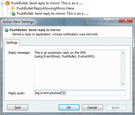

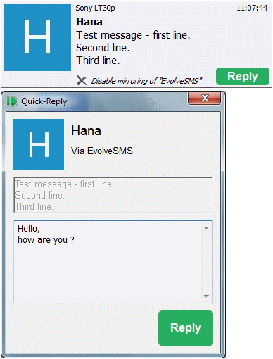

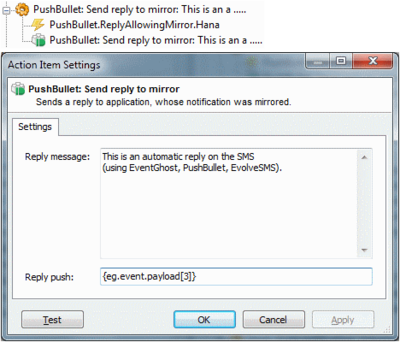

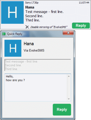

New version (0.0.19) released.
News:
  • first version for release r1669 and later (no need to install libraries)
  • mirror notifications are customizable now (colour, monitor, alignment)
  • introduced a new event "ReplyAllowingMirror"
  • added an action "Send reply to mirror"
  • if there is a possibility to send a reply, then on the mirror notification is a new button Reply
Notes:
  • It only works with EventGhost release r1669 or later
  • You can delete the folder "lib" (from the directory ...\EventGhost\plugins\PushBullet).
