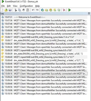

Re: MQTT Client
I have just upgraded to the Paho-based plugin and my log is now spammed with MQTT Connection messages every 10 secs (see attachment). Is this normal behaviour?

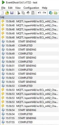

Hi again Walter,
By the way, the reason why I tried upgrading my old MQTT plugin is because the plugin listener seems to miss messages or not to trigger eg events when sent repeateadly
See the sample code below:
When hitting the [Test] button several times in the Python script window, events are triggered but time to time only:
In the meantime, the openHAB listener receives them all with no issue.
Is there anything I am doing wrong or is this a real bug?
I attached the XML test file for testing on your side. It is configured with the 'old' MQTT plugin but it behaves the same with the new Paho plugin.
Thank you in advance for your help!

Re: MQTT Client
No, it is not, it looks like the client is being kicked out every twenty secondsIs this normal behaviour?

Hello Walter,krambriw wrote:You cannot send the events that fast I think, try to insert a short time.sleep(0.1) in you script (modification below is for the paho version and my configuration but you get the idea)not to trigger eg events when sent repeateadly
Thank you for replying so fast.
Adding a pause does not fix the issue on my side. Even sending one single message (removing the for... loop from the test script) results in messages not translated into events by MQTT listener. And in the meantime, my openHAB server receives all events published by these tests like a charm, with no loss (even without the time.sleep() )
I also run the Eg test script on 3 different computer with all the same result: messages lost ramdomly when sending repeatedly.
I run the Eg test script on the 3 computers simultaneously (1 "publisher" and 3 "listeners): it shows that the only Eg instance that misses message is the one that is both sending and receiving.
So the code involved in this issue is rather the code handling subscribed messages rather than the code handling publishing messages
And publishing messages seem to interfere with reception and event triggering under some circumstances
I tried to look at your code but my only conclusion was that I need to get more experienced in Python coding before I can suggest anything
I hope this help to troubleshoot the issue.
