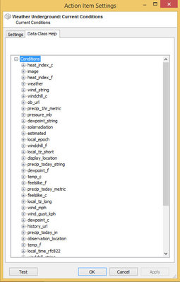

Howdy kg. Sooo long story short I ended up making a mess of the forum by asking for help with payloads in the coding corner when I blending it with this plugin. lol. So here I am again. Here's the thing, I know how to do the most basic things in eventghost and even can do some things that make me feel like I'm a maverick but both you and I know the truth!
I am having the darnest time capturing just the temperature from this wu plugin. I have followed your examples to the letter at least I thought I did... Instead of a simple temperature showing up in the log when I go to print the eg.result, I'm getting an error that says something about not having "key temperature" which leaves me wondering where to find the keys. Here's what I'm trying.

loveleejohn wrote:I'm sure I'm doing something wrong but I have no idea what it is.
your asking to retrieve the "high" key, but your using the current conditions action. There is no "key" for high in current conditions. High, indicates a forecast, not the current temp. Use one of the forecast actions, like 4 day forecast, then try this.
or this with the current conditions action you were using:

by loveleejohn
yokel22! That was indeed the magical sauce. Thank you very much for the help. Here's my challenge in this. I could not figure out where to look for the "key". How did you know to use temp_f after eg.result? Is this something you learned over time or was the eventghost wiki really enough because I've read that many many times and I've even started swimming in tutorials from this website
https://www.tutorialspoint.com/python/p ... e_time.htm. Sadly I was getting very disheartened after working on this for what certainly has felt like a very long time so thank you. Also want to say thank you to kg for the plugin in the first place. Just wish I was a bit better in python so I could make better use of it.

kgschlosser put some very handy key values in each actions config.
These are some quick ones i was working out for current condition:
data = eg.result
state = data.display_location.state_name
city = data.display_location.city
Location = city + "," + state
condition = data.weather
temp = data.temp_f
feelslike = data.feelslike_f
direction = data.wind_dir
mph = data.wind_mph
print Location + ": " + condition + ", " + temp + "/" + feelslike + ", " + direction + " winds at " + mph + " mph"
kgschlosser, i don't seem to see relative humidity in current conditions data.class. Am i just missing it?

yokel22 scores again! Thank you, thank you thank you!! I actually clicked on that and even clicked on test to populate it but I had no idea what they were.
At any rate, thanks kg for including this very stealthy arsenal!

by kgschlosser
now let me ask the dumb question... did you scroll down on the scroll bar on the right.. because it's at the bottom
and also just a couple of pointers..
if you have the unit of measure set to Imperial..
you will only have a need to do this..
data = eg.result
text = ''{0}, {1}: {2}, {3}/{4}, {5} winds at {6} mph, gusting at {7} mph'
print text.format(
data.Display_location.city,
data.Display_location.state_name,
data.weather,
data.temp,
data.feelslike,
data.wind_dir,
data.wind,
data.wind_gust
print data.relative_humidity
anything that has an imperial and a metric version of the attribute will automatically return the correct value based on what you set the action to do. so there is no need to specify mph or kph unless you have the action set to metric and want to see the imperial data. this goes for alot of the attributes. any attribute that there is 2 values for.

by kgschlosser
@loveleejohn
do you even read my posts??
I explained what that data class help tab was for. It shows you the layout of the class. word for word. it even shows you the purdy icon. which I am going to change into a wx bitmap so it would be extremely easy to use
