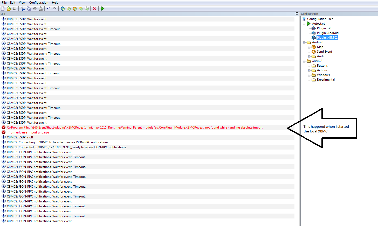

This happened when I started the local XBMC.
I have not seen any problems when getting that error, but I'm trying to fix them, have several already. They are weird as they don't happen always just sometimes.
