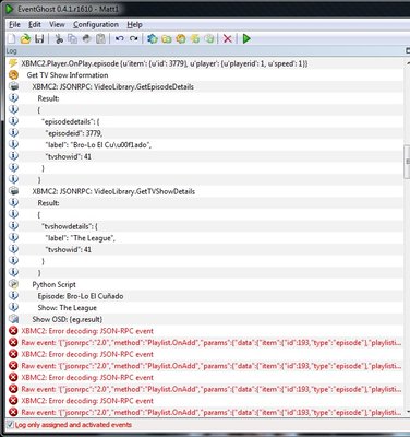

I have been using your latest test version (version = "0.6.9",) and everything works great when starting up. I have even been able to pull episode details and display them on the screen. The problem I run into is when loading a video playlist. The playlist will play alright, but once I try and fast forward or even stop the playlist I get a ton of JSON.playlist.OnAdd errors in the log. When I try and power down XBMC I get even more of these errors and eventghost will eventually freeze or it will end with "memory" error. The playlists are quite big so I am not sure if that is the issue, with trying to load 500 or so videos into a playlist.
I have attached a screenshot of the errors I get. This is only a couple of them because I wanted you to see everything works at first. But in actuality the errors will repeat over and over. Any ideas what could be causing this?
Any help would be appreciated. BTW - excellent work on the plugin!
-Mills
millsx2 wrote:I have been using your latest test version (version = "0.6.9",) and everything works great when starting up.
Great.
Nice.
Hmm, that's bad, m'kay.
Hmm, that's worse. It kinda reminds me of a problem I thought I had fixed before, damn.
If XBMC can handle the playlist there shouldn't be a problem in the XBMC2 plugin. Possibly if you try to get a big list of items from XBMC.
Unfortunately the log don't show the full errors (the lines in red) so don't help me much, if you can copy the lines and post or resize the window so I can see them fully, I should be able to fix the problem.
Why thank you, and now I feel even more guilty not having finished it. :oops:

millsx2 wrote:Here is one error code(red item).
Thanks.
Keep in mind the log is filled with hundreds of these lines. After looking at the text file and seeing how big the actual error code is, I think I can understand why eventghost is crashing.
Yikes :shock: Definitely not something I considered in the code, hopefully it's something I can handle.
@millsx2 test the attached test version (just put it in EventGhost install dir\plugins\XBMCRepeat)
It looks like I might have fixed the problem already in a debug version here. The attached file is mostly the same I just disabled it from writing a log when not in debug mode. Hopefully there is no new bugs/problems with it.
XBMC2 Test version 0.6.10
(97.99 KiB) Downloaded 227 times
millsx2
Posts: 10
Joined: Thu Aug 15, 2013 5:56 am
Post by millsx2 »
That worked great jonib!
Thanks for your help and keep up the great work on this plugin.
-Millsx2

13:28:25   XBMC2: Connected to XBMC ( 127.0.0.1 : 9090 ), ready to recive JSON-RPC notifications.
13:28:25   XBMC2: JSON socket.error: [Errno 10054] An existing connection was forcibly closed by the remote host
13:28:25   XBMC2: Disconnected from XBMC, not receiving JSON-RPC notifications.
13:28:25   XBMC2.System.OnStart
Hope it helps.
