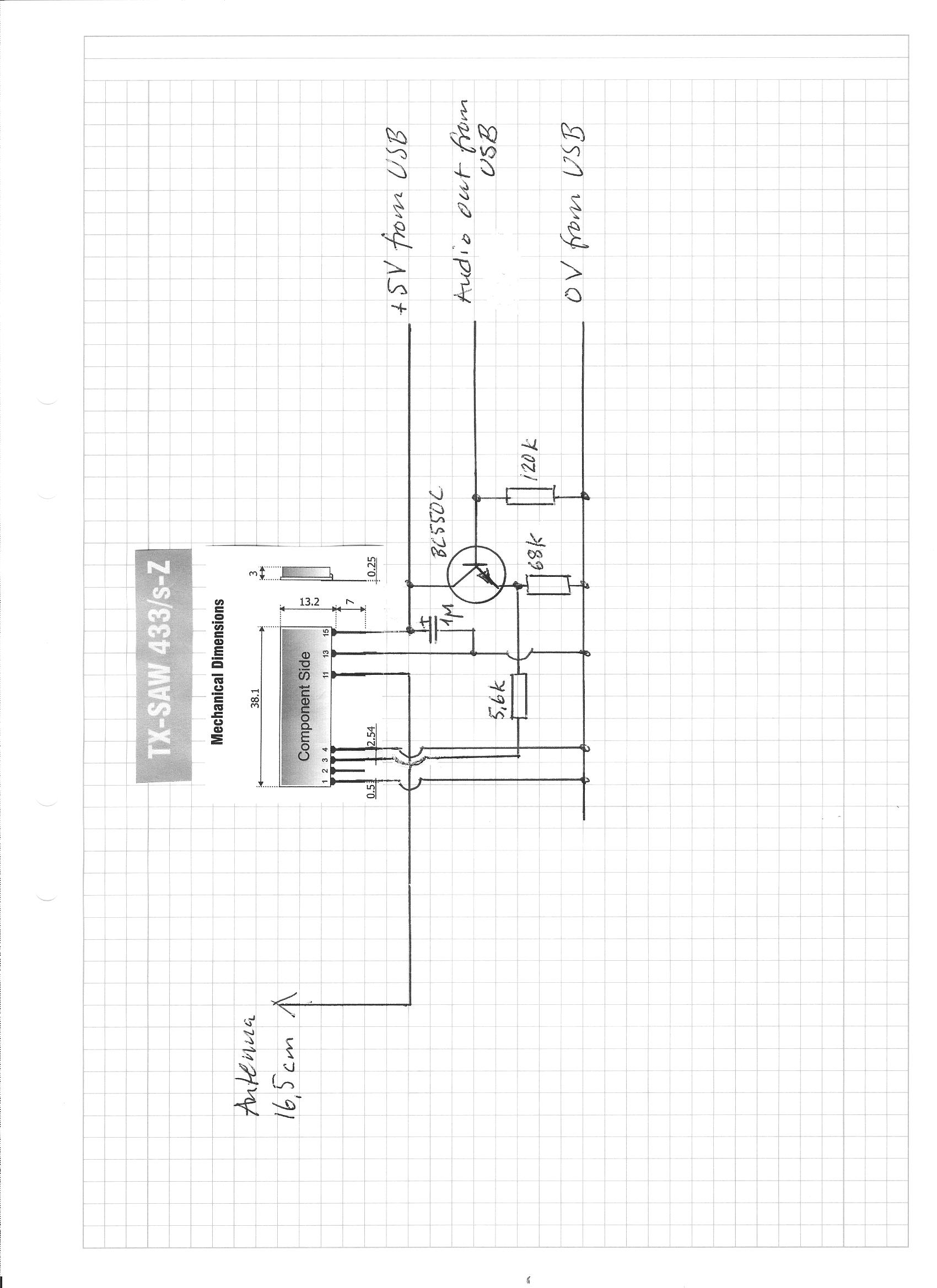

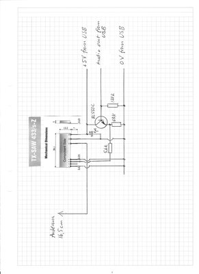

Hi, here is the schematic and a url to the data sheet in English
I have changed the design a bit to make it simpler using a standard NPN instead of an op amp (actually it improved the signal quality)
The other components (resistors & cap) are uncritical, I already had them in the drawer

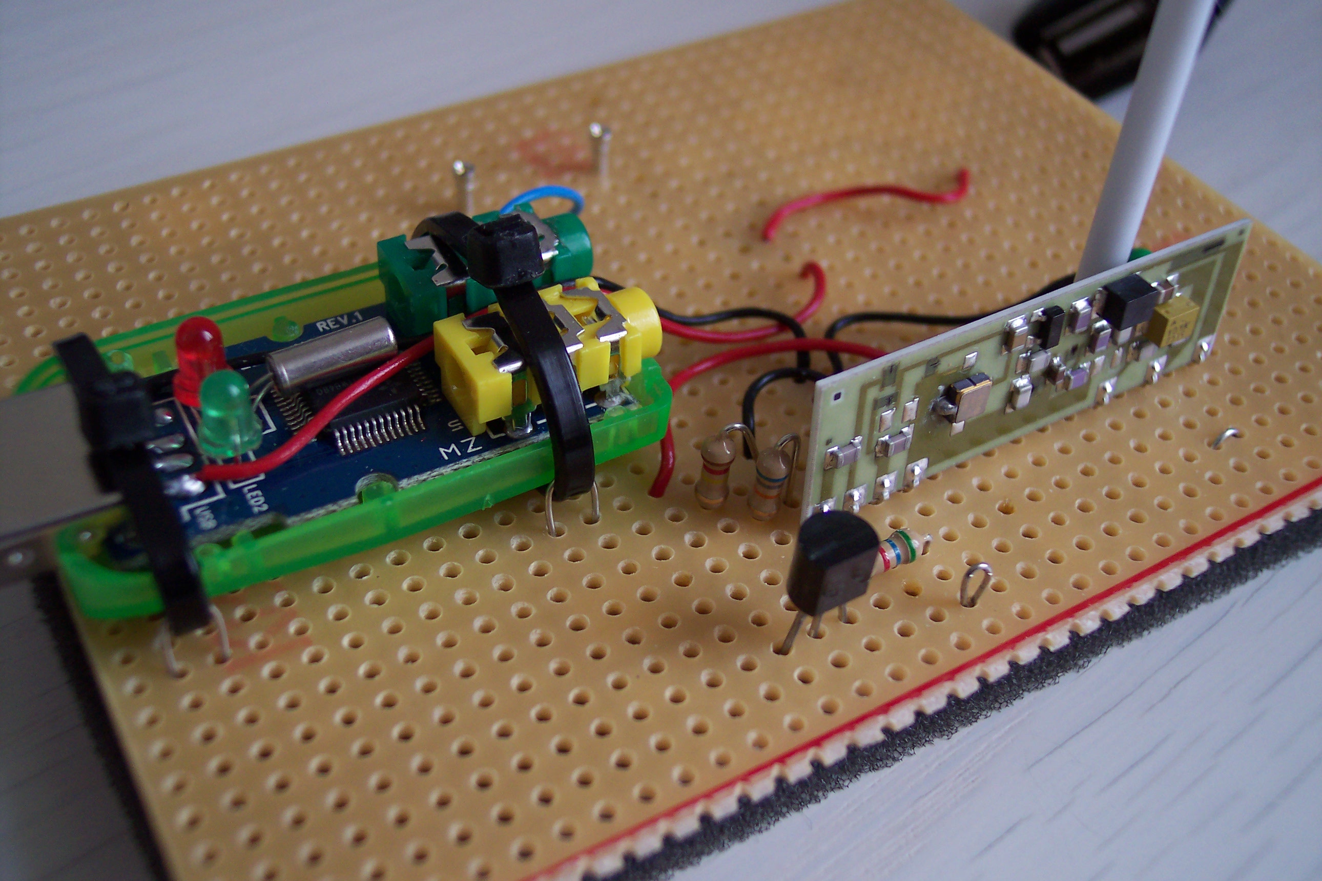

In the next post I will put some pictures that show how to connect the wires to the USB sound card
http://www.selectronic.fr/includes_sele ... WSZ_UM.PDF

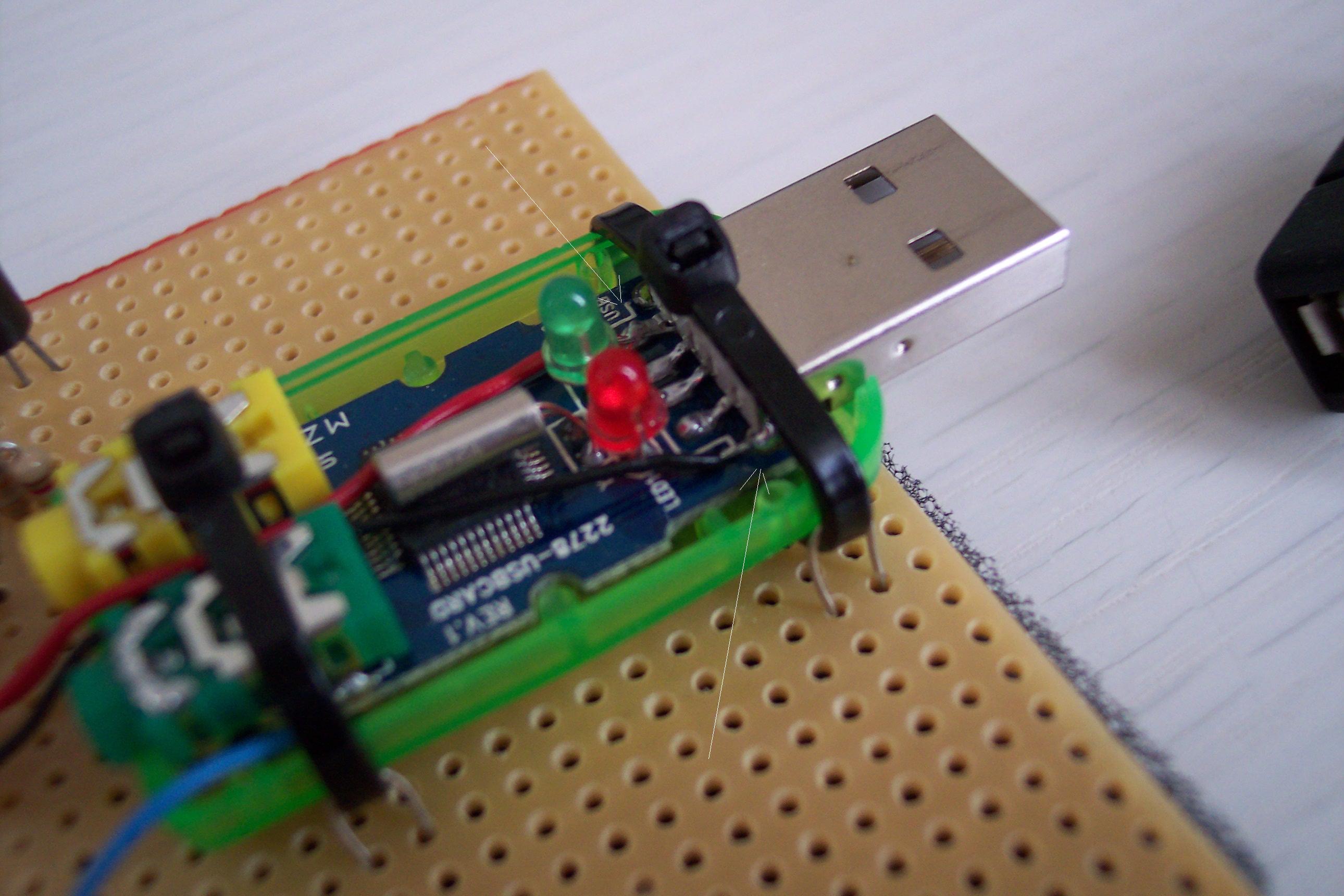

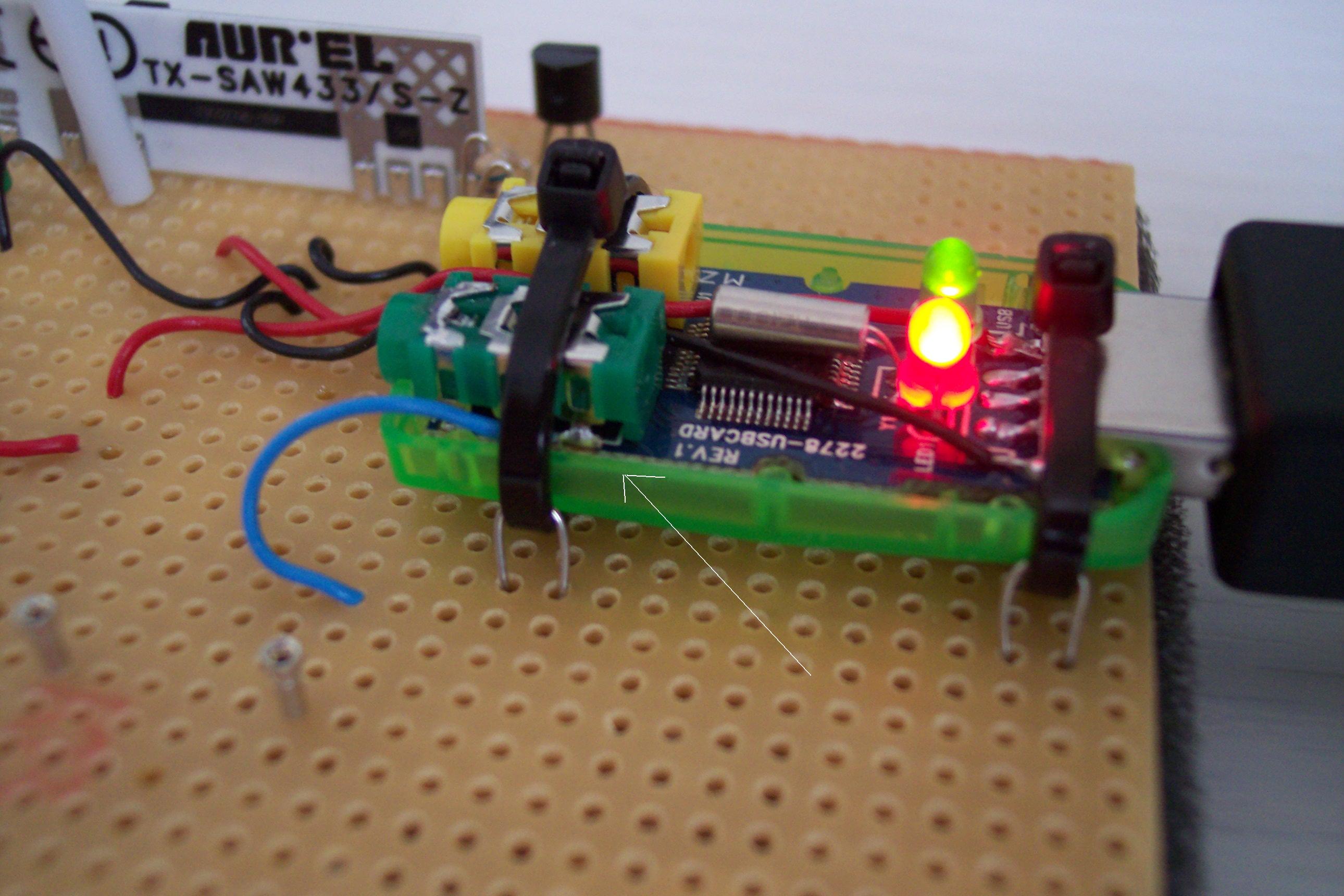

Re: Exchange events with NetHomeServer
The white arrow shows where you solder the blue wire to pick up the audio output
The white arrows show where to solder red & black wires for power supply (red +5V, black 0V)

Great, thanks for that. I'm using a dual OP amp. Will consider rebuilding to your design. Would you please also post the NetHome settings you use with this circuit?
Cheers,
Michael
I also started with the op amp approach but it never worked with the LF356 that was recommended. I changed to a CA3130 just to desperately test and then it worked. Tried at least 10 different LF356, LF355 and LF351 but no luck, all of them can't be broken. Back to CA and no problems at all
Looking at the signal pattern with the analyser made me however try a different approach and with the simple transistor circuit the waveform became much better

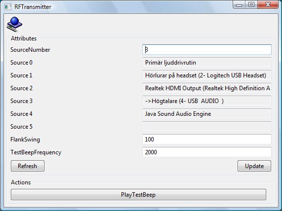

The settings below are just the default, you just have to pick the sound device, click update and it should work either from NetHome's web interface (I created a new Nexa lamp just to try it) or from EG using pronto codes

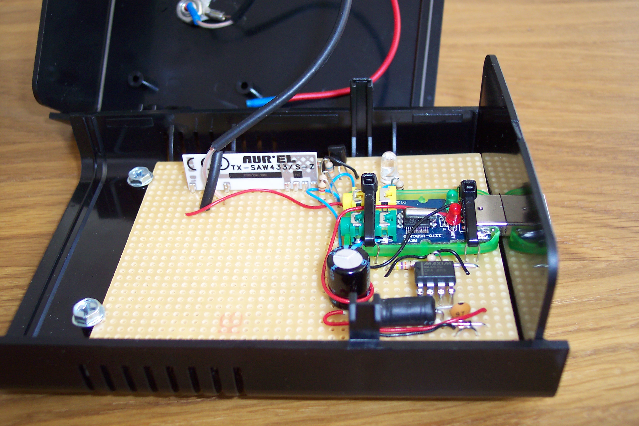

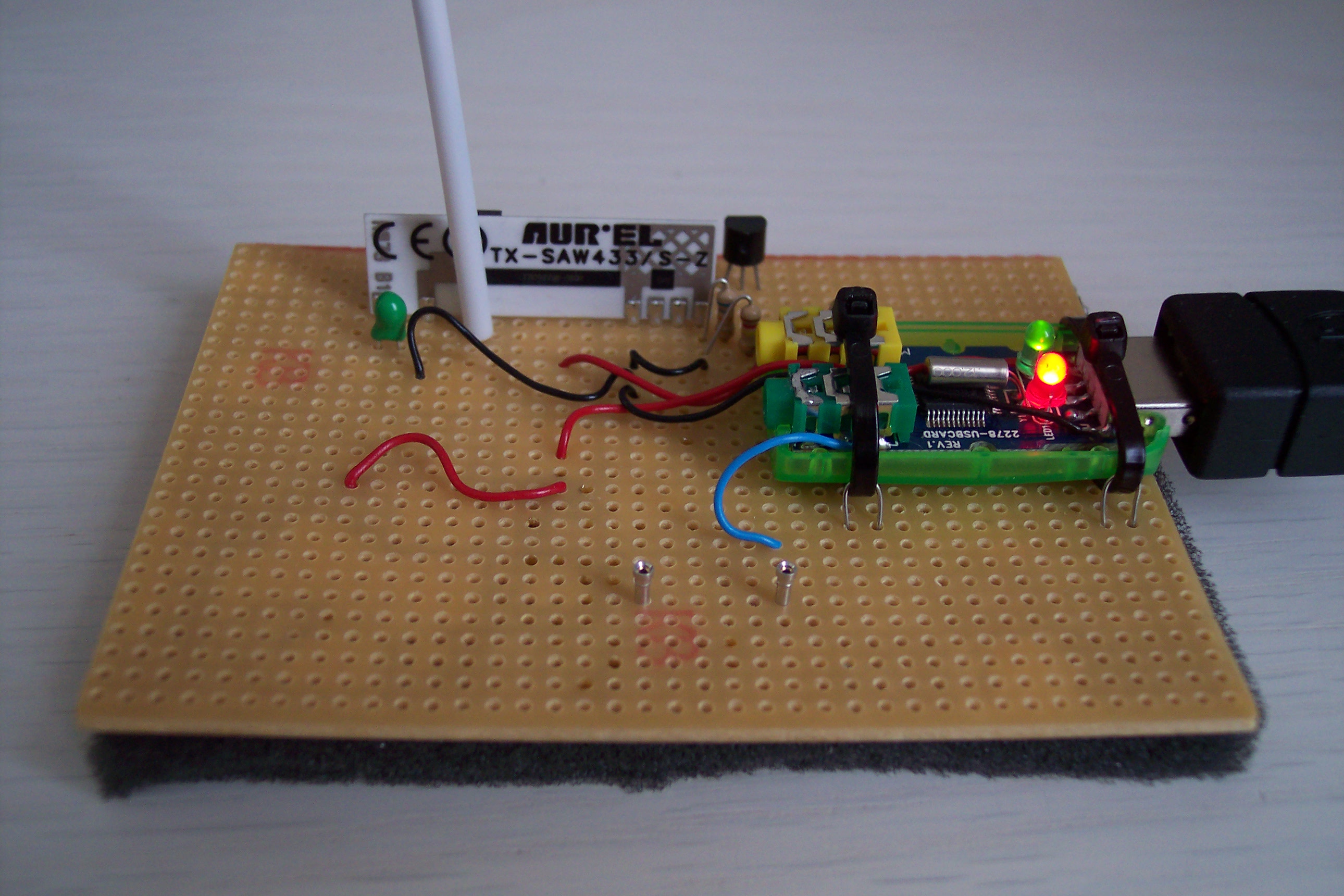

Hello, here some updated info regarding transmitters

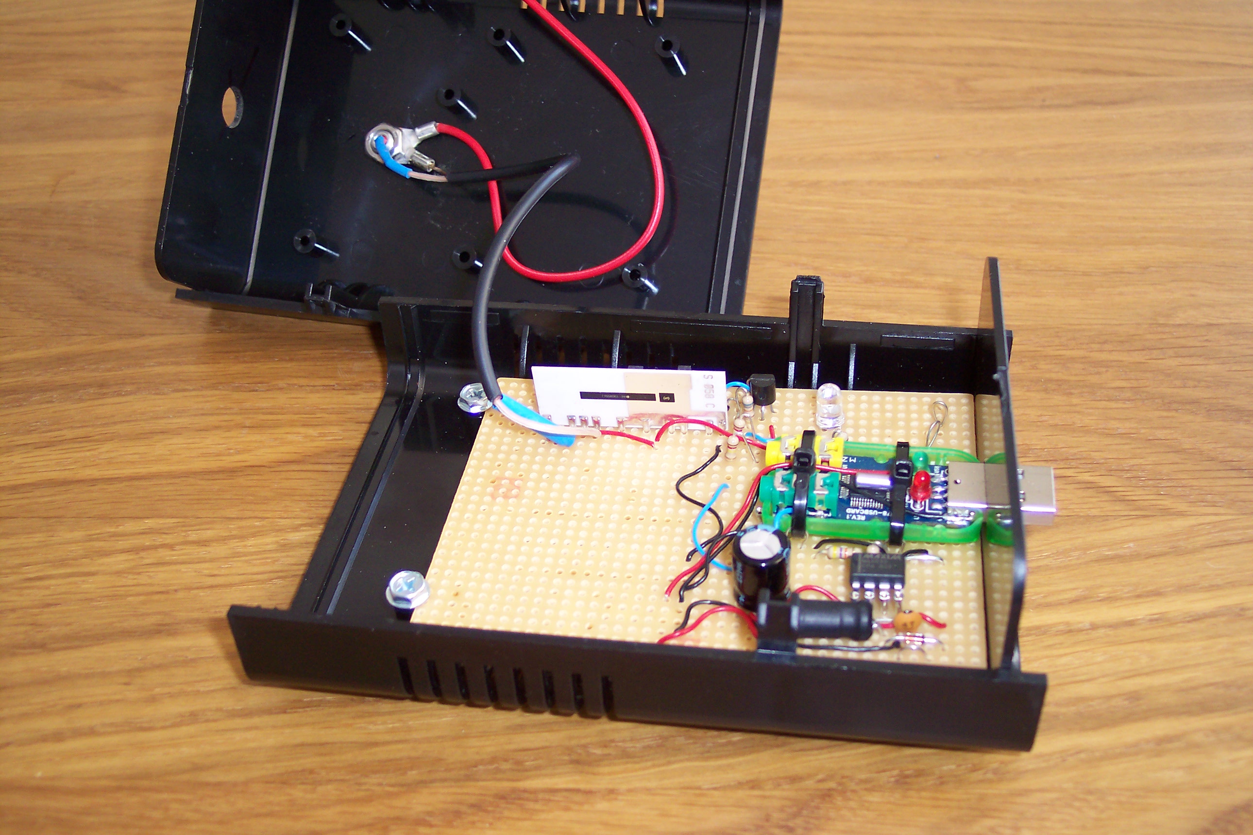

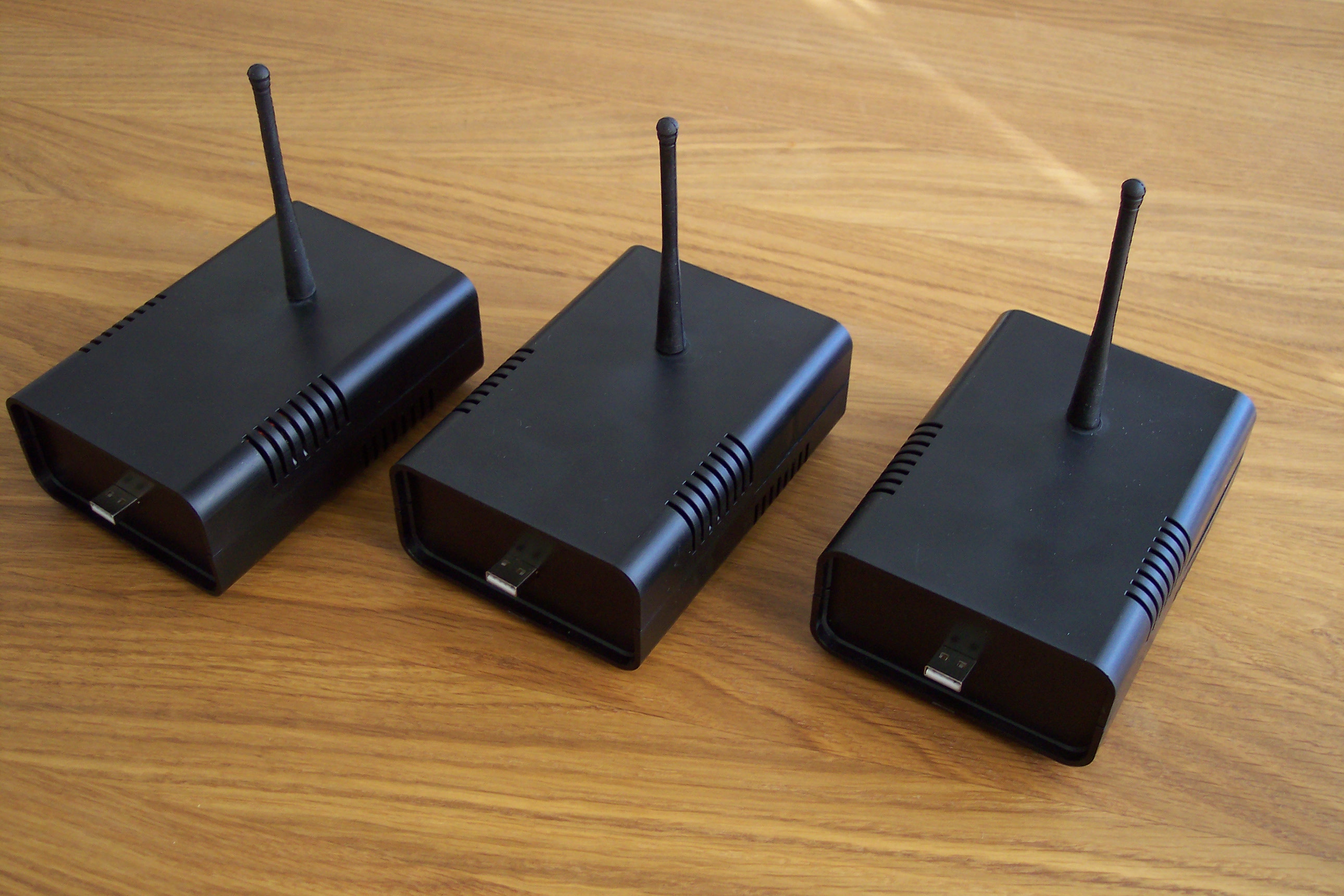

I have actually built 3 variants (they look all the same from outside :) )
1. The first one is just as described above, powered with 5V from the USB
Distance to receiver module in my house: 50-75 meters (from outside of my house)
2. The second is as the first one but powered with 12V using a step-up regulator (5V->12V)
Distance to receiver module in my house: 100 meters (from outside of my house)
3. The third is the "monster". It uses another type of transmitter module (TX-SAWBOOST) from here http://www.soselectronic.com/?str=371&artnum=5732
It is also powered with the same step-up regulator (5V->12V). It can take up to 15V so if I change one resistor value in the step-up regulator circuit I could gain even more power
Distance to receiver module in my house: 200-250 meters (from outside of my house sitting inside my car!!!).
Maybe it's not legal anywhere but I did it just for testing purposes :wink:
The antennas are also from AUREL and they provide the virtual ground plane with the kit
I connect a receiver (as described before) and a transmitter to separate USB ports on the computer. I tried having a common USB hub for them but it only worked fine in my fastest computer (Quad processor) running Vista. In my old "HomeAutomation" PC running XP, I had to use dedicated ports. I do not know why it didn't work with the common USB hub
In the following posts I will show detailed pictures and a schematic of the step-up circuit I used
The first one
The second one

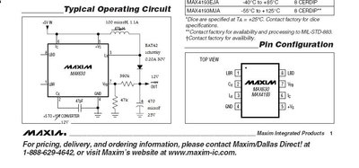

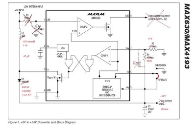

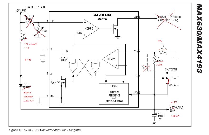

Here you can see the circuit for the step-up regulator

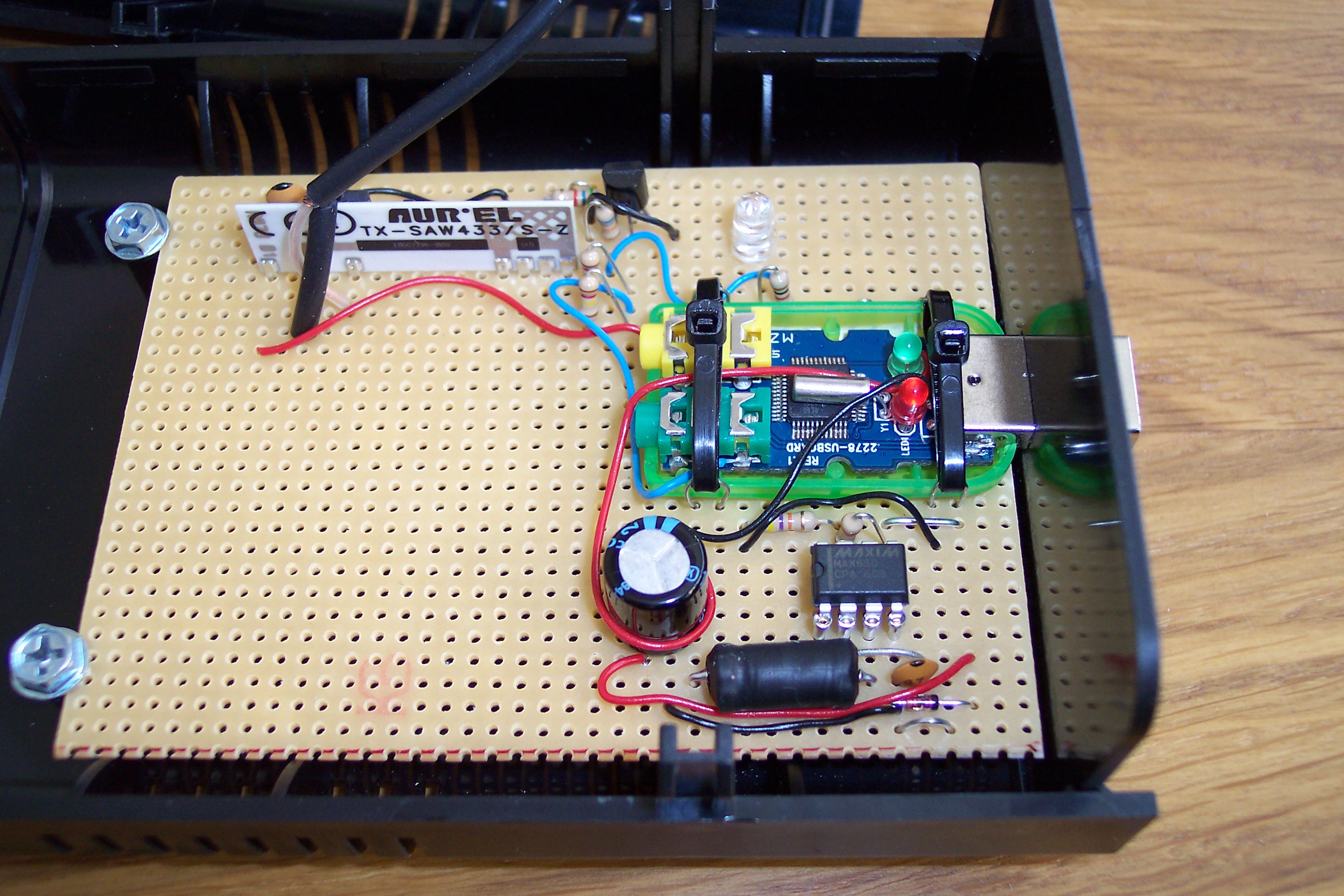

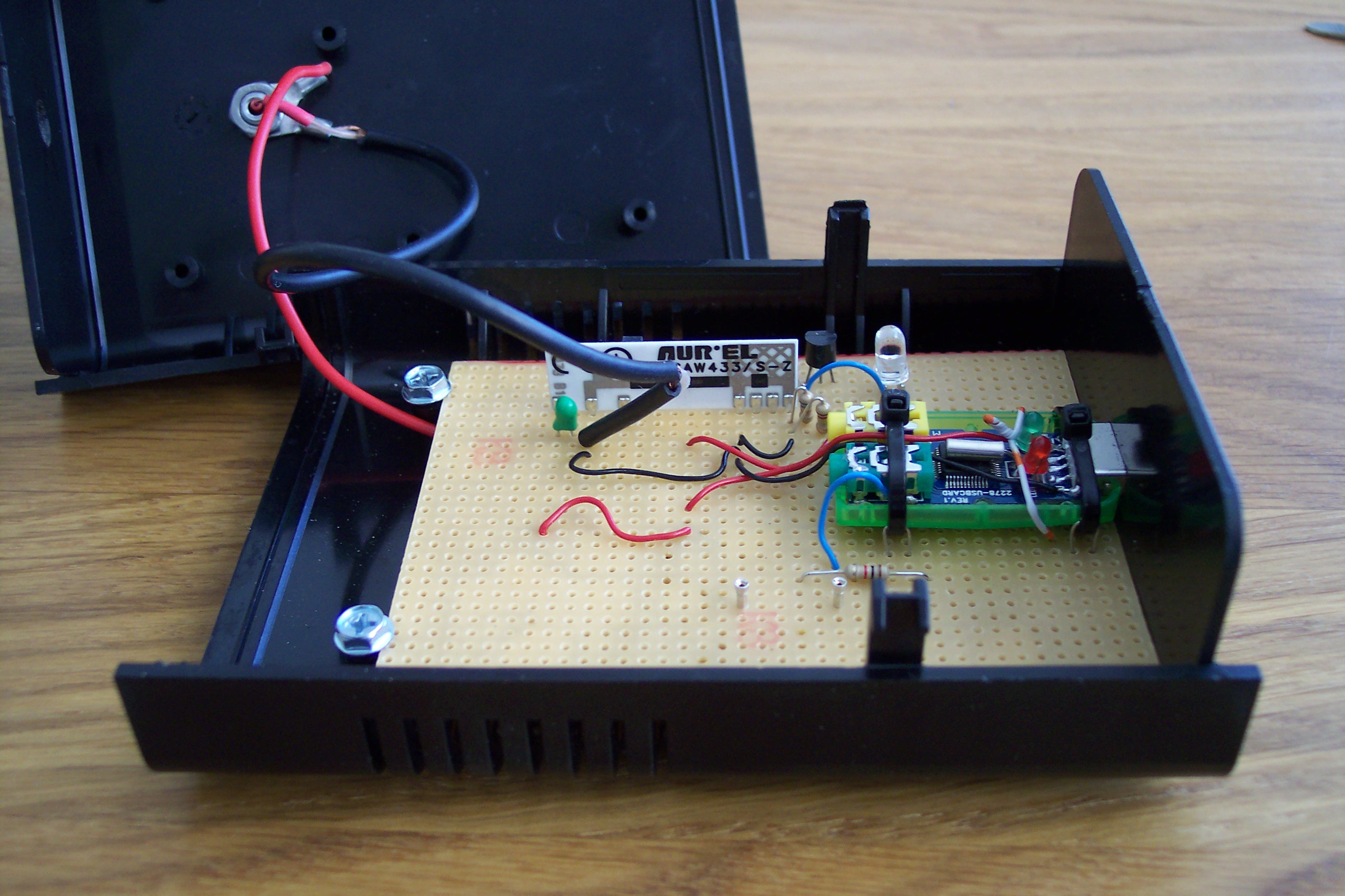

...and finally, the "monster"
Please be aware that you shall use a different input on the TX-SAW433/s-ZRFM module depending on the power supply voltage you use!!!!!!
5V power supply: input 3
12V power supply: input 2

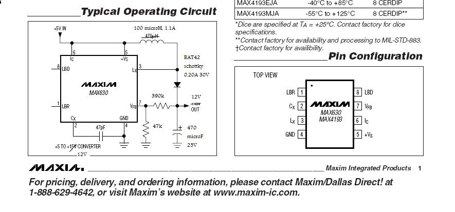

The schematic for the step-up regulator circuit (Correction, look at next post!!! ):
And the data sheet:
MAX4193-MAX630.zip
(233.51 KiB) Downloaded 186 times
This is a correction to the schematic in previous post. Both will work but I actually built it according to the picture below (same components)
It's a matter of taste I suppose
What ever you select, be sure to measure the output from the step-up regulator BEFORE you finally connect it to the transmitter module!!!

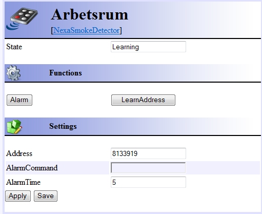

You can use the latest version of the analysator or you can use use net home itself as you mentioned (use the latest version or a version where you know that NexaSmokeDetector is implemented in).
Use the web gui, define a new NexaSmokeDetector object or navigate to the one already defined. There you should see a configuration view like in the picture below.
Click on "LearnAddress"
Press the test button on the smoke detector
Click on "LearnAddress" again and you should see the address in the Address field
