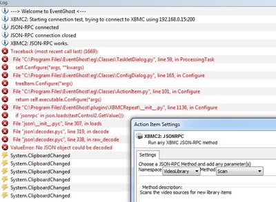

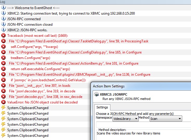

Hi again :(
Could you help me with whis one as well?
I┬┤m trying to run the scan video library Json.
Derbyboy wrote:Could you help me with whis one as well?
Sure, but the next time (if you didn't do it) read a couple of pages back before asking and you might find a solution. :)
Do this that I posted before. It's a known problem I haven't fixed yet (as I forgot about it the last time I updated the plugin :oops: )

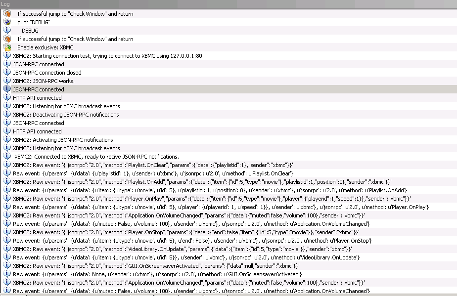

I am receiving all of these notifications in my log, I just don't know how to use them.
builderjer wrote:I am receiving all of these notifications in my log, I just don't know how to use them.
Just drag a event to a macro you want it to activate, you can access the information in the event with "eg.event.payload".

This is my log. It only shows it as a notification, not an event.
builderjer wrote:This is my log. It only shows it as a notification, not an event.
Those are "Raw" events just used for debugging, so you should turn that off. You need to disable the "Log only assigned and activated events" to see all events.

Post by builderjer »
Got it!!! Thank you!!
I did have to leave the "Raw Events" checked, otherwise it didn't show the events from them.
Now it's more playing, going window to window and see the action.
builderjer wrote:Got it!!! Thank you!!
Great
That would be a bug then, mind posting a new screenshot of the log with RAW events and normal events? I'll check on my system too a bit later with Gotham and Helix
