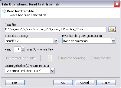

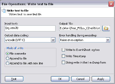

Plugin has two actions. Read from a text file and Write to a text file.
Dialog of action Read is as follows:
Dialog of action Write is as follows:
If are these two actions one after another, can be used for recoding a file.

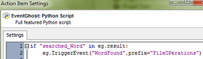

I am searching for something that allow me to read a line in a text and create an event when a specific word is there. This plug in allow this?
Re: File Operations
Posted: Sun Nov 20, 2011 6:51 am
by Pako
Of course, it's very simple:
