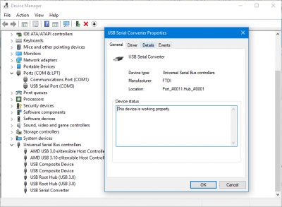

I've been using Girder on my old Windows 7x64 PC with infra-red receiver connected to a RS-232 socket (it used to come with Skystar 2 PCI card) and it worked perfectly with Igorplug plugin and my TS 35 remote.

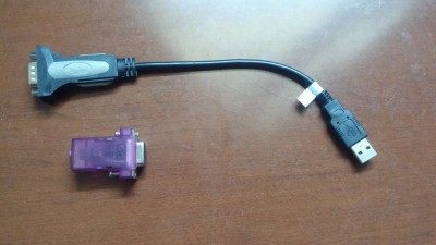

On my new PC, since there is no more RS232 port, I use USB to RS232 adapter with FTDI chip (model InLine 33306I) and my old infra-red receiver.

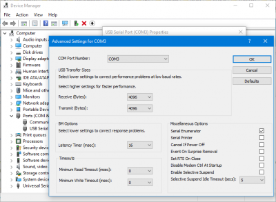

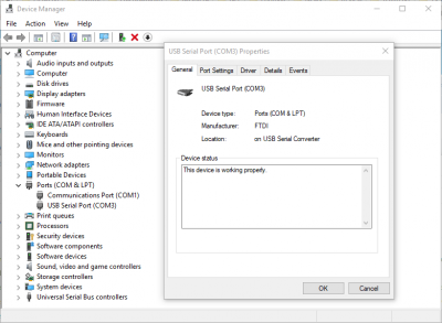

My new setup is detected as -- USB Serial Port (COM3)...
and also as USB serial converter

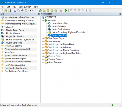

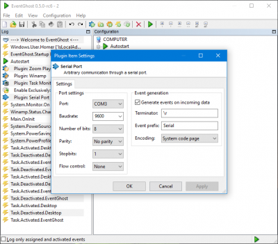

Is there any plugin that can make this combination work with Eventghost. I tried Plugin: Serial Port, it doesn't show any error in Log panel, but it also doesn't show any event by remote.

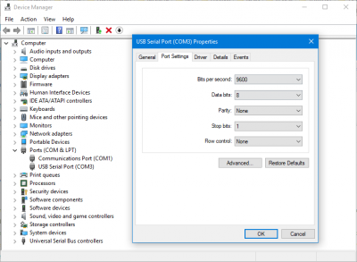

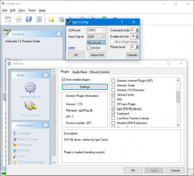

I should also say that my Girder setup on this new PC with Igorplug detects remote events, but the problem is that remote codes vary with each press. Here are my Igorplug settings...
Any help would be appreciated...

That is a TTL USB Serial adapter. It is not an RS232 USB Serial Adapter. so the adapter is wrong.
Let me explain why and this is a HUGE issue when trying to buy these things. Because the manufacturers of the adapters love to use the terms interchangeably when they really are not.
RS232 is a communications specification and that specification is for the hardware level. In that specification it requires that the on/off states are +12v -12v with the absolute lowest voltage being +6v -6v this is to define the "on" and "off" TTL is is a low voltage specification for transmitting serial data it has 2 different voltage ranges it can operate in +5v -5v and +3.3v to -3.3v. Your old IR receiver is an RS232 Serial and you are trying to use a TTL adapter.. Do you see where the issue lies? This is how you can tell to be sure when you pick up another adapter.. if it is true RS232 it is going to have a wall wart with it an ac to dc power adapter the little brick that you plug into an outlet. USB is at most +5v -5v it is impossible for it to produce the +12v -12v needed for RS232 so if there is no power supply it is not RS232.

Now because of some of the old eventghost topics i dead about this idor dll file and the igor type of IR receivers leads me to believe that we do not need to use the igor dll file at all and that the raw IR codes are what come from the receiver.. It was stated that the igor dll file was used to exploit some kind of a hole in Windows xp in order to gain a higher processor priority to parse the ir. Now that makes me think the data is actually raw IR codes. and the timings in which the pulses are sent in as data also have to be timed.. and very accurately too. Now because of this I am going to tell you that 9600 bps is not the speed in which you would set a serial port to if monitoring IR pulses real time. you would need 38400 or better. So that tells me that there is a setting goof there.. OR the pulses actually do not come through as serial data in the usual way.. meaning it is not sent using the TX bin on the receiver.. So you would not actually ever see any data.. There are 9 pins total. the RX and TX only account for 2 of them. I did notice from your screen shot of the settings in GIRD that the input signal is set to "DSR" which is an actual pin. this pin is used to typically handle handshaking but it can also be used to transmit data.. This thing can be pulsed at a high rate of speed.
I want you to download a program called RealTerm. It is a terminal emulator like HyperView It has wayyyy more bells and whistles.. One of them being the ability to see what is going on with those other pins..
try using that program to open the serial port to the receiver.. and then send some IR codes to it and see if there is any data to the window. but also watch the indicators for the different pins in the same window.. You will have to watch super close as the pulses come in at a frequency of 38khz or so. But sometimes you may have a long pause between pulses and it would cause that indicator to flash on the program.

and if you look the "out" of the IR receiver is wired to the DSR pin on the serial. So that is why you are not getting any data using the serial plugin. Because there isn't any to see.
