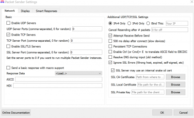

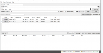

Here are screenshots of the setting dialog in Packet Sender and the actual GUI with the Power ON and Power OFF commands saved.
