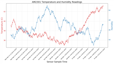

we can do that as well. The pyplot module has the ability to build an actual interactive type of webpage pyplot relies on matplot lib. or we can use matplot lib directly and simply dump an image into a directly. either way it's still easy to do. The only thing is that dumping the image to a folder every 5 minutes is kind of a waste of resources if it is not being used. That is your call to make.
here is an example of what you are kind of looking for I think
import matplotlib.pyplot as plt
import numpy as np
params = {
    'legend.fontsize': 16,
    'figure.figsize': (16, 10),
    'axes.labelsize': 16,
    'axes.titlesize': 16,
    'xtick.labelsize': 16,
    'ytick.labelsize': 16,
    'figure.titlesize': 22
plt.rcParams.update(params)
# plt.style.use('seaborn-whitegrid')
# this section is only to build a mock up of your data
import datetime
import random
dt = datetime.datetime.today()
data = []
temp_increment = 0.1
humidity_increment = 0.1
humidity = float(random.randrange(20, 80)) + (float(random.randrange(0, 9)) / 10)
temp = float(random.randrange(10, 50)) + (float(random.randrange(0, 9)) / 10)
count = 0
while len(data) < 500:
    count += 1
    temp += temp_increment
    humidity -= humidity_increment
    dt = dt - datetime.timedelta(minutes=5)
    entry = dict(Time=dt.strftime('%c'), AM2301=dict(Temperature=temp, Humidity=humidity, TempUnit='C'))
    data += [entry]
    temp_random_flip = random.randrange(1, random.randrange(2, 20))
    humidity_random_flip = random.randrange(1, random.randrange(2, 20))
    if temp >= 50.0 or temp <= 10.0 or count >= temp_random_flip:
        temp_increment = -temp_increment
        count = 0
    if humidity <= 20.0 or humidity >= 80.0 or count >= humidity_random_flip:
        humidity_increment = -humidity_increment
        count = 0
# here we are going to parse your data into the sections needed for the graph
x = []
y1 = []
y2 = []
for entry in data:
    x += [entry['Time']]
    y1 += [entry['AM2301']['Temperature']]
    y2 += [entry['AM2301']['Humidity']]
# Plot Line1 (Left Y Axis)
fig, ax1 = plt.subplots(1, 1, figsize=(16,9), dpi= 80)
ax1.plot(x, y1, color='tab:red')
# Plot Line2 (Right Y Axis)
ax2 = ax1.twinx()  # instantiate a second axes that shares the same x-axis
ax2.plot(x, y2, color='tab:blue')
# Decorations
# ax1 (left Y axis)
ax1.set_xlabel('Sensor Sample Time', fontsize=20)
ax1.tick_params(axis='x', rotation=45, labelsize=12)
ax1.set_ylabel('Temperature (C)', color='tab:red', fontsize=20)
ax1.tick_params(axis='y', rotation=0, labelcolor='tab:red' )
ax1.grid(alpha=.4)
# ax2 (right Y axis)
ax2.set_ylabel("Humidity", color='tab:blue', fontsize=20)
ax2.tick_params(axis='y', labelcolor='tab:blue')
ax2.set_xticks(np.arange(0, len(x), 60))
ax2.set_xticklabels(x[::60], rotation=90, fontdict={'fontsize':10})
ax2.set_title("AM2301 Temperature and Humidity Readings", fontsize=22)
fig.tight_layout()
plt.show()

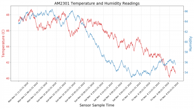

I coded in a random generator to create the samples. that graph is 500 samples
and here is one with 1000 samples.

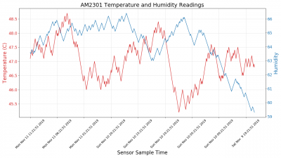

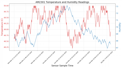

if you wanted to show to graph at the same time. This is an example where the second graph is a subset of the first.
image is 1000 samples
image is the same 1000 samples as above but only the first 500 samples are being shown.. call this is "zoomed in"
# Decorations
# ax1 (left Y axis)
ax1.grid(alpha=.4)
fig.tight_layout()
plt.figure(2)
ax1.plot(x[:-500], y1[:-500], color='tab:red')
ax2.plot(x[:-500], y2[:-500], color='tab:blue')
# Decorations
# ax1 (left Y axis)
ax1.grid(alpha=.4)
ax2.set_xticks(np.arange(0, len(x[:-500]), 60))
ax2.set_xticklabels(x[:-500][::60], rotation=90, fontdict={'fontsize':10})
fig.tight_layout()
plt.show()

here is an example using the plotly library
import plotly.graph_objects as go
import plotly
import plotly.io as pio
pio.renderers.default = "browser"
import datetime
import random
data = []
count = 0
while len(data) < 105120 / 4:
    count += 1
    data += [entry]
        count = 0
        count = 0
date = []
temperature = []
humidity = []
for entry in data:
    date += [entry['Time']]
    temperature += [entry['AM2301']['Temperature']]
    humidity += [entry['AM2301']['Humidity']]
fig = go.Figure()
fig.add_trace(
    go.Scatter(
        x=date,
        y=temperature,
        name="Temperature",
        line_color='red'
fig.add_trace(
    go.Scatter(
        x=date,
        y=humidity,
        name="Humidity",
        line_color='blue'
fig.update_layout(
    title_text='AM2301 Temperature and Humidity',
    xaxis_rangeslider_visible=True
plotly.offline.plot(
    fig,
    filename=r'C:\some\output\path\index.html',
    auto_open=False
it produces a nice JavaScript enabled HTML document that is interactive including over overs and a range slider
note: This applies to everyone. If you want to be able to embed HTML code into a post you will need to send me a PM along with the zipped up code. I am the only one that can do it as the HTML code will need to be uploaded to the server to do it. This is so that I can review it and make sure that nothing malicious exists in the code. I am going to reserve this feature specifically for the intent of displaying things like shown above. So the user will not have to deal with dealing with archives and extracting files. It is also going to be a foundation for being able to set up a live EventGhost as an example of how to use EventGhost and the webserver plugin and also what the possibilities are.
