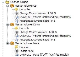

Thanks to the users "jonib" and "olurz", I can now give an easy-to-understand instructions to display the current volume in percentage or bar and the MUTE state (if the sound is ON or OFF):
1. Go to one of your volume macros (example: UP) and add "Show OSD" action (right-click -> Add Action... -> EventGhost -> Show OSD) and introduce this code (where it say: "Text to display"):
Volume {int(round(eg.result))}%
or if you want the volume bar insert this code insted:
Volume {'|'*int(round(eg.result))+'.'*(100-int(round(eg.result)))} {int(round(eg.result))}%
Note: You need to place the "Show OSD" before the "Autorepeat current macro" (if you have one).
2. Repeat the process for the other volume macro (example: DOWN) or just copy that previous action to the other macro.
3. The last thing you should want to do is to display the Mute condition. For that, go to your Mute macro (Toggle Mute) and add "Show OSD" action (right-click -> Add Action... -> EventGhost -> Show OSD) and introduce this code:
Mute {("Off", "On")[eg.result]}
Or you can choose to display the revert situation, showing "Sound On" or "Sound Off". For that use this code:
Sound {("On", "Off")[eg.result]}
You can adjust the position, font, color, time, etc. in the settings of the "Show OSD" event (double-click the "Show OSD" event).
I attach a screenshot of my settings. Yours should be looking something like this:
I make a video tutorial showing how to use EventGhost, including how to make display the current volume. Here's the video: http://www.youtube.com/watch?v=xnMzu1h1gxc
P.S. English is not my primary language so be understandable about my bad english.
ScreenShot - EventGhost - Display Current Volume.jpg (91.38 KiB) Viewed 18284 times
ScreenShot - EventGhost - Display Current Volume - Result.jpg (10.98 KiB) Viewed 18628 times
ScreenShot - EventGhost - Display Mute Status - Result (Mute On).jpg (7.98 KiB) Viewed 18628 times
