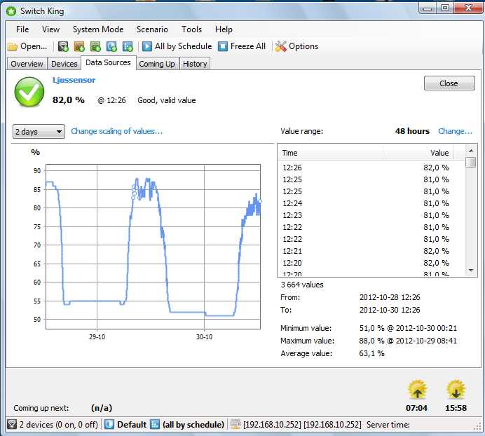

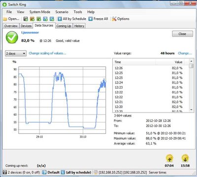

There are several ways doing this. I personally use SwitchKing (SK) in a test drive since a while.

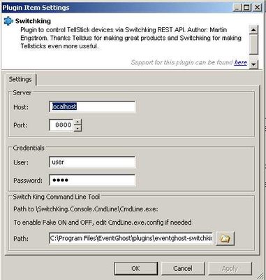

I have configured a data source in SK for each sensor of interest. Then I am using the SwitchKing plugin for EG to send data via the REST interface.
Below is a picture from SK showing one of my sensors ( a modified one for measuring the light level). Also below, see some screens as well as the python script from my EG configuration.
Below, configuring the SwitchKing plugin for EG
