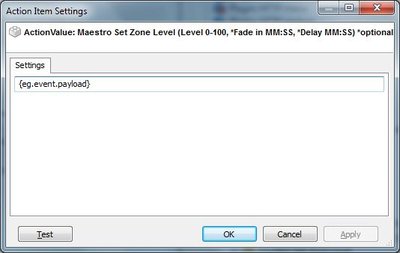

Is there a way to access an event's payload from within the actionstringparameter dialog?
For example... when i click on my action to adjust a light's intensity, the dialog shows up, and I would enter in a 50 for 50%. That works fine. Now, i'm trying to use voxcommando to set the light level to 50 via a voxcommando generated event with a payload of 50. I just don't understand what I need to do to pass the payload value into the action.
I have voxcommand generating the event with the payload properly. It shows up as Broadcast.RoomA.Light '50', and then when i drag that event from the log to the macro where the action is defined, it shows up fine - I just don't know how to get that payload from the event linked into the action for this macro.

rdgerken wrote:Is there a way to access an event's payload from within the actionstringparameter dialog?
This is very simple.
You must do two things:
1. Into your code, you must add the line value = eg.ParseString(value) as follows::
class MyAction(eg.ActionWithStringParameter):
    name = "Action Test"
    description = "This action tests values."
    def __call__(self, value):
        print "Action Test called: user value   = " + value
        print "Action Test called: command value   = " + self.command
2. Configuration dialog set as follows:
