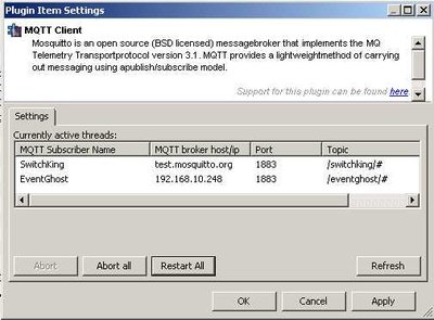

Once you add the plugin "MQTT Client", you will see this dialog on the screen (there will however be no entries in the list to start, they have first to be configured as described below).

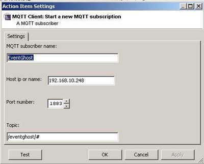

You may close this dialog and now instead add an action under "Autostart". Select "Start a new MQTT subscription".
This dialog will be shown and here you can fill in the details. As soon as you are done and clicked OK, the subscription will start.

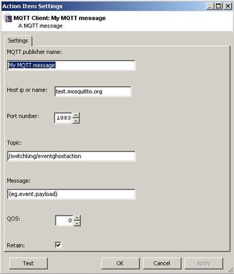

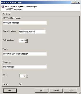

To publish a message to the broker, you need to configure a macro with a publishing action. Select the action "Publish a MQTT message" and the following dialog will appear:
The first part of the configuration like name of the action, broker host name or ip and port number is self explanatory I think.
When you define the topic, it is important that it is the same as the one clients are subscribed to, otherwise they will not receive the messages.
The message itself can be any fixed string or it can also be dynamic using {eg.event.string} or {eg.event.payload} like in this example:
The 'QOS' (Quality Of Service) can be selectable 0,1 or 2.
The 'Retain' can be set either True(checked) or False(unchecked)

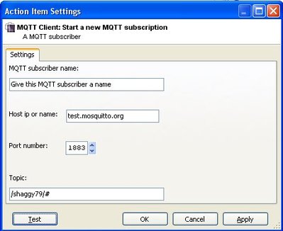

2) In EG,
- into EG plugin folder, unzip the MQTT Client plugin found here:
- restart EG and add the MQTT plugin
- add 'Start a new MQTT Subscription'
- configure it like in this picture
Click Test and OK and you should get connected.
In OwnTracks, tap on the symbol > or >> on top of the screen, select 'Puublish Now' and you should see an event in EG looking similar to this:
