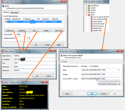

I was asked by one of the users to create a plugin for smart sockets (multifunction power controller) series Koukaam NETIO.
I turned to the producer and he willingly lent me one piece of NETIO-230C.
So it was possible to create a plugin.
The first version of the plugin I bring you today.
It is likely, that there are some bugs, that will be discovered when it will in actual operation.
I hope I'll be able to fix it even though I will not have NETIO available.
I made ÔÇïÔÇïa plugin so, that it is possible to control multiple pieces Netio.
However, I have not had a chance to see if it works correctly.

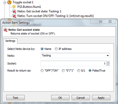

HTPCanwender wrote:A toggle command would be nice. When a port is on it should be switched off and when a port is off it should be switched on with the same command.
I am thinking about creating such an action (maybe even sometimes I will make it).
However, already now it works quite well this way:

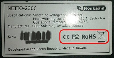

krambriw wrote:- if they do have so called CE approval?
I'm sure it has. For us it is very closely guarded. It would not be possible to sell such a product without it.
Here you can see the CE approval:

thank you very much for your quick answer and the workaround for the toggle command. Now I can use the Switch in the way I wanted.
