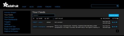

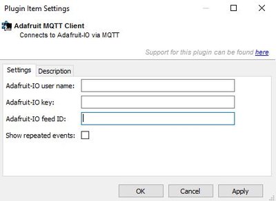

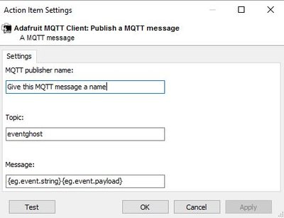

Below some screen shots that will help you install & configure the plugin. Also a view back at adafruit where we can see our feeds and events being published
1) Download & extract the plugin to the EG plugin folder
2) Restart EG, add the plugin to your configuration and configure it and actions according to your needs
Here is the configuration dialog for the plugin
This is a configuration for an action (I use it to publish events from my RFXtrx transceiver)
The dashboard showing my feeds with published events
