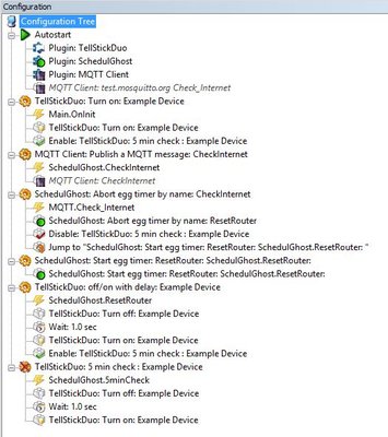

This is part of a configuration tree showing the actual sample configuration needed
In essence, it works like this:
0) When EventGhost starts up, a power on command is sent to the mains power switch and the macro for the 5 min check is enabled
1) Every 15 seconds (this can be altered of course) a message is published to a specific topic on the MQTT broker somewhere on Internet

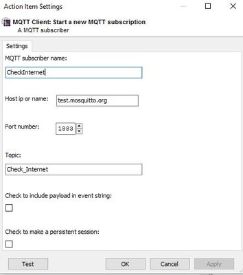

2) A response is received more or less instantly and this is received by the MQTT Client that is subscribing to the same topic on the same broker
3) The response is stopping an egg timer and then restarting the same egg timer again as well as disabling the macro for the 5 minute check
4) If the responses stops coming, the egg timer will fire and the TellStickDuo will cycle the power supply to the router. In addition the macro for the 5 minute check will be enabled again
5) Hopefully the internet connection will be re-established when the router has booted up again and then also the macro for the 5 minute check once again will be disabled

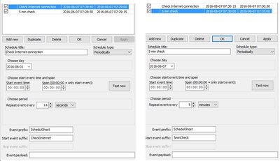

SchedulGhost: the 2 timers you need to configure
MQTT Client:

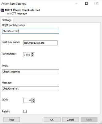

MQTT Client: Publish a message

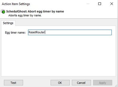

SchedulGhost: Abort egg timer

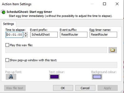

SchedulGhost: Start egg timer

It is the start egg timer time you should extend (increase, make longer). The thing is that a running egg timer is running in a separate thread. Even if EventGhost gets busy and thereby due to some overload is not able to stop the egg timer, it will fire when the time has passed and cause a reset of your router.
