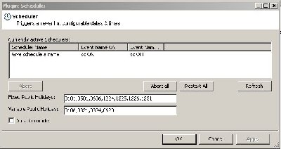

General description
I have made, I hope, a useful little plugin if you need a scheduler.
First of all, all credits to Bartman, I have based it on code and structure from his Timer plugin.
With this plugin, You could for instance feed your fishes in the pond automatically (provided you have the machine for that purpose) or control automatically the motor heater of your car.
If you use radio controlled outlet switches, you could start to save all that standby energi your stuff is consuming today. Fantasy is free....

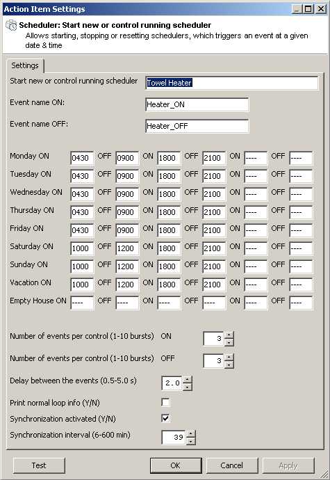

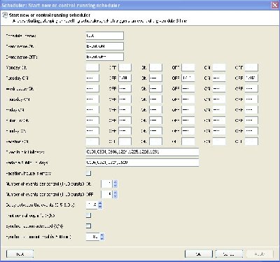

Some words about the settings as seen in the picture below:
The first 3 fields for scheduler and event names are rather obvious.
For each daytype you have 3 on and 3 off time settings. Write them in format "hhmm" like 1830. There are some error controls built in but if its 100% failsafe is left to be seen.
Then there are public holidays. You have fixed ones and you have variable ones (that changes every year). So this you need to maintain yearly.
The logic in handling of holidays is as follows
- if today is a normal weekday and tomorrow is a holiday, use time settings for Friday
- if today and tomorrow are holidays, use time settings for Saturday
- if today is a holiday and tomorrow normal weekday, use time settings for Sunday
Some devices, especially radio controlled (rf), needs sometimes the command to be repeated to be sure the on or off has been executed. The setting for this is called bursts, here you define how many "copies" of the event you like to create when turning on or off.
Some transmission devices also need a short delay between the transmissions. So there is also a setting for that.
Finally, you can decide if you like to have an entry printed in the log window for each loop execution.
Talking about log, in a separate directory, "Log", you find a logfile in html-format holding the on off actions.
To make things happen, just do as normal, finalize your settings, create an event with the same name in any macro together with actions.

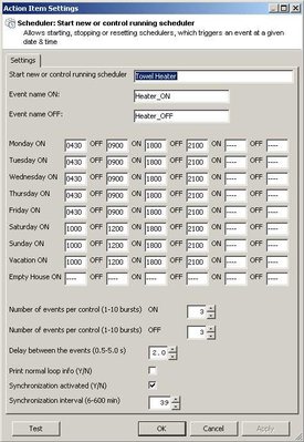

Re: Scheduler plugin

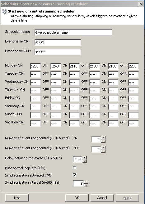

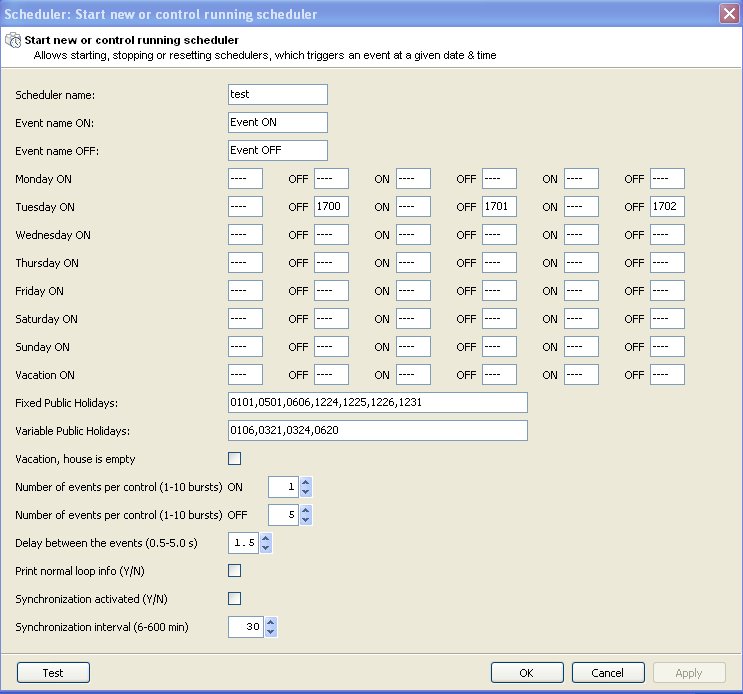

Hi, here is an updated version where you can set different number of bursts for ON/OFF events.
23.09.2008_Scheduler.zip
(9.08 KiB) Downloaded 578 times
You will have to delete and re-create the scheduler actions to use this version

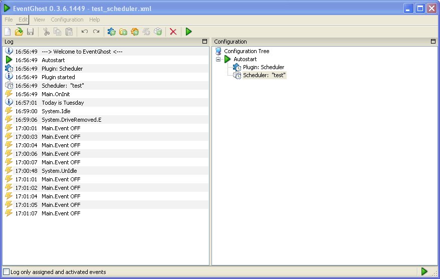

The other thing (sending only OFF events) works for me :?:
See the pictures below

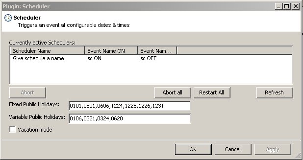

I have made some modifications to this plugin
After using it for a while I become a bit irritated in the behaviour when I needed to make modifications to the settings
What I wanted to achieve was that whenever a setting is changed, the necessary part shall read this new data and use it. Basically for this to happen, a full or partial restart was necessary
Besides, I thought some of the settings should be "common" while others still should be "individual"
Therefore I have moved the following variables from the action settings to the plugin settings;
-Fixed and Variable Public Holidays
-Vacation mode
I have also changed the behaviour of some buttons...
If you click "Restart All" all defined actions will restart independently if they are running or not
If you make a change of the setting in the plug-in, all defined actions will also restart when you click "OK"
If you make a change of an action setting and/or you click the "OK" button, the action will restart
All was made with an effort to make it easier to use when changing any settings. Now the affected parts are automatically restarted if needed
If you migrate from previous version, you will unfortunately have to make the configuration again, there is no way I can figure out how to migrate the data. You will have to delete the actions as well as the plugin and start all over again :(
