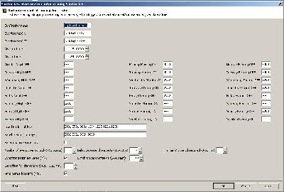

Some words about the settings as seen in the picture:
The first 3 fields for tracker and event names are rather obvious.
The longitude and latitude fields are needed to calculate the sunset/sunrise at your location.
For each daytype you have 3 time settings. Write them in format "hhmm" like "1830".
- "Night OFF" means any time between 0001-0559 when you want something to be turned OFF
- "Morning ON" is the time in the morning from 0600-1759 (long morning, yes) when you want
something to be turned ON
- "Evening OFF" is the OFF time in the evening starting from 1800-2359
A typical use-case could look like this
During weekdays, Monday through Thursday, it would be that
- the outdoor lamp is turned ON every morning at "0600"
- it is then turned OFF at sunrise
- it is turned ON again at sunset
- finally, its turned OFF later in the evening, like "2300"
On Friday evenings it would not be turned OFF, instead this happens Saturday night at "0200" (because the kids always arrives home much later during weekends)
For Saturday we do not turn ON the light at all in the morning, everybody is sleeping anyway...Later in the evening, it is turned ON at sunset. The same procedure as for Friday, its turned OFF at "0200" Sunday night.
On Sundays, finally, the same morning and eveing procedure as during Saturdays wih the exception that the lights are turned OFF in the evening at "2300".
During Vacation when the house is empty and you are dancing in Ibiza, another pattern could be applicable...
I hope you got the basic idea behind. The picture below is configured accordingly
There is a checkbox where you can enable/disable the vacation override function. If checked,
all days will follow the vacation schedule.
Then there are public holidays. You have fixed ones and you have variable ones (that changes
every year). So this you need to maintain yearly.
The logic in handling holidays is as follows
- if today is a normal weekday and tomorrow is a holiday, use time settings for Friday
- if today and tomorrow are holidays, use time settings for Saturday
- if today is a holiday and tomorrow normal weekday, use time settings for Sunday
Some devices, especially radio controlled, needs sometimes the command to be repeated. The setting for this is called bursts, here you define how many "copies" of the event you like to create when turning ON or OFF.
Some transmission devices also need a short delay between the transmissions. So there is also a setting for that.
Also it makes no sense to turn on lights if they anyway are going to be turned OFF shortly. Here you have a setting where you define the minimum ON period left to be required.
You can decide if you want the devices to be synchronized or not. This means that if by accident, someone turns a light OFF when its supposed to be ON, it will be turned ON again
at the next synchronization. The interval is also configurable.
If you like, you can specify an offset in minutes for ON/OFF events. A negative offset, as example -45, results in that the ON event is created the specified number of minutes (in this example 45 minutes) BEFORE the actual sunset happens.
The OFF event will occur the same amount of minutes AFTER the actual sunrise. This function is much appreciated when you like to control indoor lights since it's normally getting a bit darker earlier inside than outside.
A positive offset works the reverse way. It creates the ON event specified number of minutes AFTER the actual sunset. The OFF event will occur the same amount of minutes BEFORE the actual sunrise. This function can be used in cases where you think that there is still enough light from the sun also a period of time after the actual sunset and before the sunrise. It depends on your actual location.
Finally, you can decide if you like to have an entry printed in the log window for each loop execution.
Talking about log, in a separate directory, "Log", you find a logfile in html-format holding the on off actions

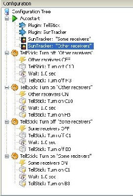

Add the plug-ins themselves as you have done (one for Tellstick and one SunTracker)
Then you right-click on the SunTracker plug-in and create an action (one for each receiver if you need different settings for each)
You will then get a setting dialog where you enter your data like the name of the action, your geographical position (to make it possible to calculate the sunrise/sunset where you live), the name of the events that is going to be generated when the action triggers for ON and OFF...and a lot of other settings. Look earlier in this thread and you will see a typical setting dialog.
Next step will be to create macros, actions and events for the Tellstick. Events must have the same names as you used above in SunTracker dialog
One macro can be used to trigger several receivers even if they have different adressing so you just create the Tellstick macros, add the actions you need and give the events the same names for all. If you need different settings for some, you have to create another SunTracker action. In the picture below you can see an example. I have added a delay between the Tellstick transmissions
Hope this helps a bit on your way, you are welcome with new questions
