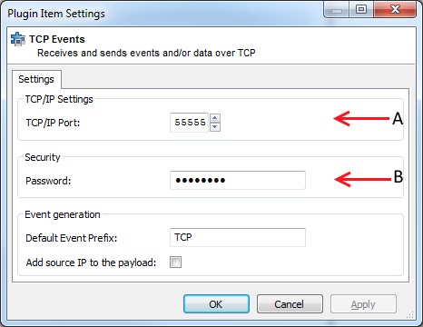

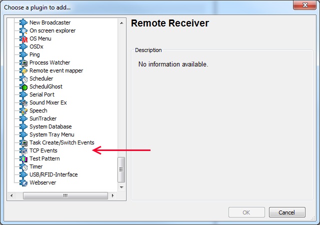

EventGhost Setup:
We need to install the TCPEvents Plugin as you can see by the photos above for instruction
A: The port in which we want to have EGI connect to. set this to whatever you like but make note of it. I am going to use 55555 for this tutorial. Remember to allow incoming and outgoing connections to this port in windows firewall. I have not included instructions on how to do this they can be looked up on the internet
B: The password is going to be needed at both ends of the connection for security purposes i am going to use passw0rd for this tutorial.
C: The event prefix field we are not going to use because the event prefix is generated by the EGI program but this is if you have other programs connect to EG using this same port. and if those other programs don't generate their own prefix

Above is what the setup should look like.
And that concludes the EG setup, pretty easy huh??..

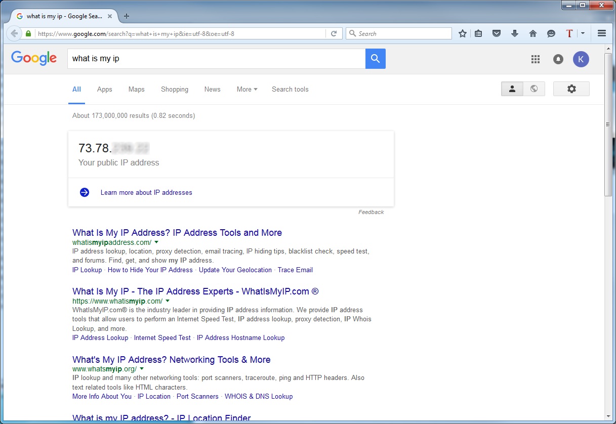

Obtain Public IP:
The above is a simple way to get your "public" or "wan" IP address. Simply do a Google search for "what's my ip". Write down this number.
