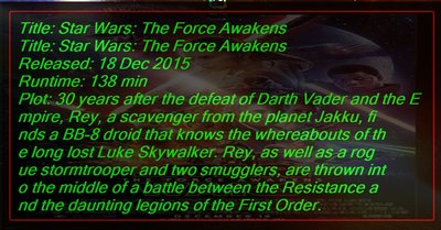

ok here i have something i just made up for ya
I think you may like it. :D :twisted:
these lines
LINELENGTH = 50
TRANSPARENCY = 220
FADESTEPS = 50
OSDTIMEOUT = 30
MONITOR = 0
DISPLAYSIZE = 0.60
you can change
LINELENGTH is how long the display text should be. use this is you have text overrun on the OSD. make the number smaller
TRANSPARENCY is how see through the OSD is set this number from 40 to 230 nothing higher or lower
FADESTEPS this all depends on the computer its running on, if things are running slow then shrink the number
OSDTIMEOUT is when the OSD will dissapear, it's in seconds.
MONITOR is for a multi-monitor setup. 0 being the default for a single monitor
DISPLAYSIZE this is a decimal representation of the % of the screen you want to cover so the 0.60 will cover 60% of the screen (on that monitor)
copy and paste the code below into a python script. you will have to get rid of everything in the macro except the event and the TextGrabber. and both of those have to be located before the script.
there seems to be one glitch. i have to poke around and see if i can find it. but it's when the menu goes to shutdown on occasion it will throw an exception. one time i had the osd get stuck on. not sure what is causing it and why it's so random
i will add other features like being able to change the colors but this is a nice start.

Re: Parsing global variable
Posted: Tue Oct 18, 2016 9:25 am
by nathan323
Ah excellent, thanks! I'd added something in python that further edited the title down to hide episode code, then inserted the text into the clipboard on my phone, so I could paste into iMDB app haha.
Yours is great for some quick info. Although the OSD doesn't seem to be working, I can only see plot, runtime, etc. in the Event Log (with the little blue info bubble icons).
Here is the log:
 Python script "2", line 223, in <module>
  ScrapedOSD(text, data['Poster'])
 Python script "2", line 45, in __init__
  poster = Image.open(urllib2.urlopen(poster)).resize((xSize, ySize), Image.ANTIALIAS)
 File "PIL\Image.pyc", line 1964, in open
AttributeError: addinfourl instance has no attribute 'seek'

but this also goes and grabs the movie poster and shows it.
i am going to add 3 separate transparency values. one for the poster, one for the box overlay, and the 3rd for the text. maybe i should just make a plugin for this. so that any data can be passed into it and it will bring up an osd, that might be the way to go to have some nice dialogs for the settings and what have you

2016-10-20 17:20:08  MACRO: VLC - Show Title (forum)
2016-10-20 17:20:08     ACTION: Find Window: vlc.exe
2016-10-20 17:20:08     ACTION: TextGrab: GrabText
2016-10-20 17:20:08        INFO: Text grabbed: The Departed.mkv - VLC media player
2016-10-20 17:20:08     ACTION: Python Script
2016-10-20 17:20:08        INFO: The Departed.mkv - VLC media player
2016-10-20 17:20:08        INFO: {'Plot': "In South Boston, the state police force is waging war on Irish-American organized crime. Young undercover cop Billy Costigan (Leonardo DiCaprio) is assigned to infiltrate the mob syndicate run by gangland chief Frank Costello (Jack Nicholson). While Billy quickly gains Costello's confidence, Colin Sullivan (Matt Damon), a hardened young criminal who has infiltrated the state police as an informer for the syndicate is rising to a position of power in the Special Investigation Unit. Each man becomes deeply consumed by their double lives, gathering information about the plans and counter-plans of the operations they have penetrated. But when it becomes clear to both the mob and the police that there is a mole in their midst, Billy and Colin are suddenly in danger of being caught and exposed to the enemy - and each must race to uncover the identity of the other man in time to save themselves. But is either willing to turn on their friends and comrades they've made during their long stints undercover?", 'Rated': 'R', 'Response': 'True', 'Language': 'English, Cantonese', 'Title': 'The Departed', 'Country': 'USA, Hong Kong', 'Writer': 'William Monahan (screenplay), Alan Mak, Felix Chong', 'Metascore': '86', 'imdbRating': '8.5', 'Director': 'Martin Scorsese', 'Released': '06 Oct 2006', 'Actors': 'Leonardo DiCaprio, Matt Damon, Jack Nicholson, Mark Wahlberg', 'Year': '2006', 'Genre': 'Crime, Drama, Thriller', 'Awards': 'Won 4 Oscars. Another 90 wins & 123 nominations.', 'Runtime': '151 min', 'Type': 'movie', 'Poster': 'https://images-na.ssl-images-amazon.com/images/M/MV5BMTI1MTY2OTIxNV5BMl5BanBnXkFtZTYwNjQ4NjY3._V1_SX300.jpg', 'imdbVotes': '885,411', 'imdbID': 'tt0407887'}
2016-10-20 17:20:08        INFO: Title: The Departed
2016-10-20 17:20:08        INFO: Released: 06 Oct 2006
2016-10-20 17:20:08        INFO: Runtime: 151 min
2016-10-20 17:20:08        INFO: Plot: In South Boston, the state police force is waging
2016-10-20 17:20:08        INFO: war on Irish-American organized crime. Young unde
2016-10-20 17:20:08        INFO: rcover cop Billy Costigan (Leonardo DiCaprio) is
2016-10-20 17:20:08        INFO: assigned to infiltrate the mob syndicate run by g
2016-10-20 17:20:08        INFO: angland chief Frank Costello (Jack Nicholson). Wh
2016-10-20 17:20:08        INFO: ile Billy quickly gains Costello's confidence, Co
2016-10-20 17:20:08        INFO: lin Sullivan (Matt Damon), a hardened young crimi
2016-10-20 17:20:08        INFO: nal who has infiltrated the state police as an in
2016-10-20 17:20:08        INFO: former for the syndicate is rising to a position
2016-10-20 17:20:08        INFO: of power in the Special Investigation Unit. Each
2016-10-20 17:20:08        INFO: man becomes deeply consumed by their double lives
2016-10-20 17:20:08        INFO: , gathering information about the plans and count
2016-10-20 17:20:08        INFO: er-plans of the operations they have penetrated.
2016-10-20 17:20:08        INFO: But when it becomes clear to both the mob and the
2016-10-20 17:20:08        INFO: police that there is a mole in their midst, Bill
2016-10-20 17:20:08        INFO: y and Colin are suddenly in danger of being caugh
2016-10-20 17:20:08        INFO: t and exposed to the enemy - and each must race t
2016-10-20 17:20:08        INFO: o uncover the identity of the other man in time t
2016-10-20 17:20:08        INFO: o save themselves. But is either willing to turn
2016-10-20 17:20:08        INFO: on their friends and comrades they've made during
2016-10-20 17:20:08        INFO: their long stints undercover?
2016-10-20 17:20:08        ERROR: Traceback (most recent call last):
2016-10-20 17:20:08        ERROR: Python script "3", line 225, in <module>
2016-10-20 17:20:08        ERROR: ScrapedOSD(text, data['Poster'])
2016-10-20 17:20:08        ERROR: Python script "3", line 47, in __init__
2016-10-20 17:20:08        ERROR: poster = Image.open(urllib2.urlopen(poster)).resize((xSize, ySize), Image.ANTIALIAS)
2016-10-20 17:20:08        ERROR: File "PIL\Image.pyc", line 1964, in open
2016-10-20 17:20:08        ERROR: AttributeError: addinfourl instance has no attribute 'seek'
