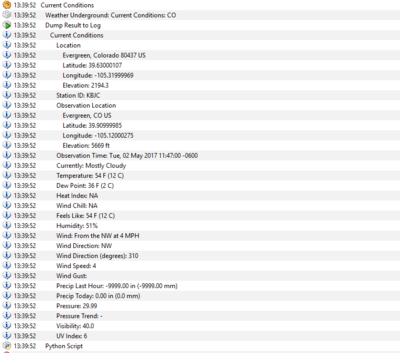

Re: Can anyone lend a hand with payloads please?
Posted: Tue May 02, 2017 6:42 pm
by loveleejohn
Got ya. Here's what the plugin outputs to the log when I use the "dump result to log" action.
WU plugin output
WU plugin output
