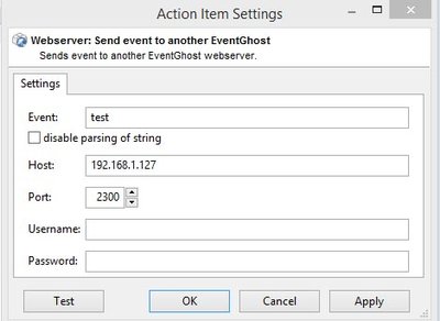

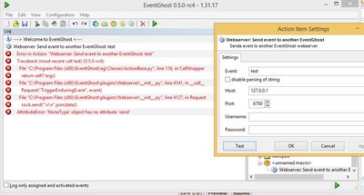

I mean, what does your configuration for the webserver action "Send Event to another EventGhost" look like. I'm able to replicate the error when i set mine up like this.
If i send it with a direct ip:port like this, it works properly for me.
Re: help with Webserver plugins
Posted: Thu Aug 24, 2017 1:05 am
by scottsams
Here is mine
