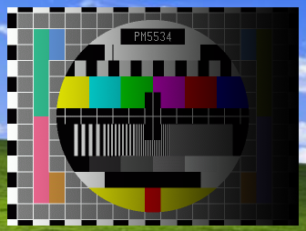

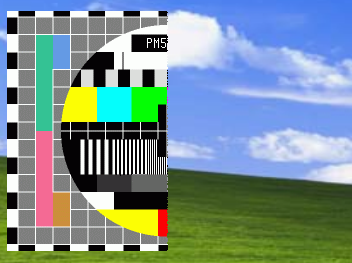

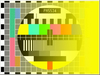

Hi guys,
I am not having any success with the alpha channel of a PNG using this script.
Enclosed is the PNG file in a ZIP, because it seems that the forum strips the alpha channel. The alpha.png file in the ZIP has an alpha channel which is a horizontal gradient.
The file is correct, because I tested it on a web page with a background image: However, this is the result I get with this script when showing the file on the desktop: All I get is the transparency showing some kind of grey background instead.
Am I doing something wrong, or is there some limitation of wxPython that I am not aware of. Right now I have no experience with wxPython. I need to finish learning Python first.
Eventually I want to implement a semitransparent screen overlay with text and graphics. Without semitransparency, the idea is dead in the water. It would be great if it could become some sort of GDI plugin, if you see what I mean.
Anyway, thanks for your time...

Re: Show picture+Make it disapear after a Delay
You're right, I can confirm.
Both actions (System.ShowPicture and System.DisplayImage) displays the file incorrectly.
I tried a simple thing. I used it as an "icon" in PushBullet plugin (action Push mirror) and it looked like this:This means properly.
And since I'm the author PushBullet plugin and also the action System.DisplayImage, so it should not be a big problem to fix it.

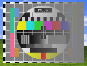

I'm a bit improved behavior of Display Image action.
Now is better taken into account the value of the alpha channel:However, I do not think it will be sometime in the future so perfect that will be rendered semi-transparent image on a transparent background.
I'm not saying it's impossible. But it is at least very difficult, and I have no interest in spending more time on it.
Modified System plugin can be downloaded here.
- __init__.py
- Plugin System
- (68.22 KiB) Downloaded 198 times

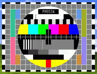

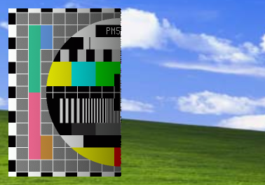

Thanks for your effort Pako, you don't need to spend any more time with this.
I just want to clarify what I said earlier.
The result.png image obtained previously did not use System.ShowPicture or System.DisplayImage, but used the script that you posted here for themaster1 in 2011.
System.ShowPicture ignores all transparency and alpha values: The original System.DisplayImage: The new System.DisplayImage: In the old and new System.DisplayImage cases, alpha < 127 is opaque, and alpha > 127 is transparent.
There is a slight visible difference between the two versions, but I don't think the modification is worth releasing.
The script from the 2011 post was more effective, it resulted in displaying the whole image.
An interesting observation about the script: you can only drag and click the non-transparent regions... Cool! I can already envision OnScreen Sliders and other GUI controls.

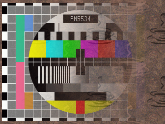

Here is the other image for the previous post:
(I just found out that each post can only have 3 attachments)
Yes this is the default behavior.WharfRat wrote:In the old and new System.DisplayImage cases, alpha < 127 is opaque, and alpha > 127 is transparent.
It would be possible to add the option to choose the threshold (from 0 to 255).
I think that you are not right.WharfRat wrote:There is a slight visible difference between the two versions, but I don't think the modification is worth releasing.
The difference is especially noticeable when the Shaped window (if alpha channel exists) option is unchecked.
Note: The difference between the old and the new version is more:
- Background color behavior
- Doubleclick behavior [when Shaped window (if alpha channel exists) option is unchecked]
I must apologize for not testing the modification more thoroughly. Yes, System.DisplayImage does work better now:
I was also not aware of the double-click feature. So sorry...

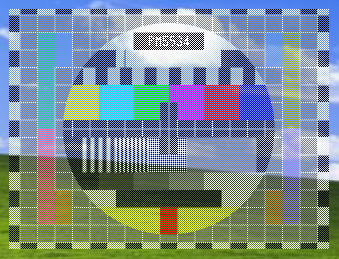

Something just occurred to me...
All this time I have been wanting a partially transparent image.
Maybe I should use a chessboard pattern in the alpha channel instead.
I think the technique is called 'half-toning' or something like that.
Better get back to GIMP.
This seems to be the easiest solution, I'll try it now.
