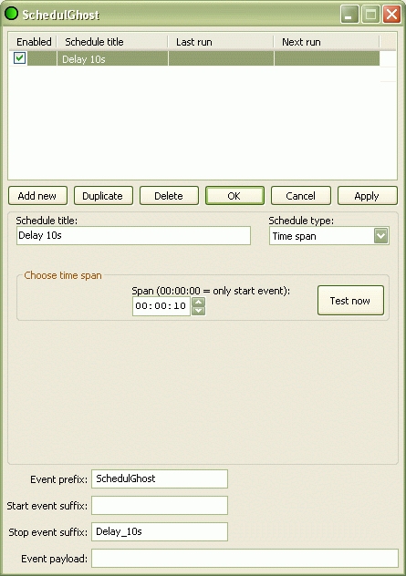

It is very simple:
Maybe you did not understand what it means to use empty path to clear.
Delays 10s you can do so easily, as shown in the first macro.
It has but one drawback - EventGhost throughout the delay just waiting and can not perform any other activities (the icon is yellow).
If it matters, you need to do more complicated. This is shown in the second and third macro.
Insert the plugin SchedulGhost and create a schedule based on this picture:
And that's all.
