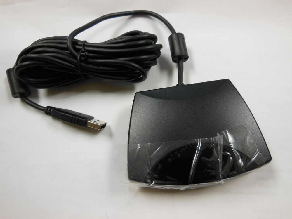

on the receiver itself it says "OVU4003/00".
In the Device Manager:
Under "Human interface devices" I have a "Microsoft eHome-Infrarottransceiver" with the device instance path "CIRCLASS\IRDEVICEV2\1&79F5D87&0&PORT1".
AND under "USB-Controller" there is also a "eHome-Infrarotempfänger (USBCIR)" with the device instance path "USB\VID_0471&PID_0815\PH00HPTJ".
I hope this helps!

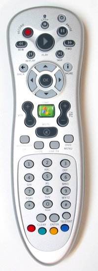

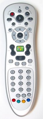

mine looks like this:
And the receiver like this:

Clearly, you both have different MCE remotes.
blaher has an older version of 0019, and I do know that there is at least one other older version of it.
I will do some searching for them again so that it (blahers version) can go into the catalogue.
Sem;colon has a variation of 0029 which has the extra Teletext buttons.
I remember seeing some variations of 0029 on the XBMC website, but I have not catalogued them yet.
