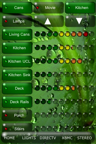

Here is the current incarnation of my RadioRa2 iViewer interface.
The top six buttons are scene or raise/lower and the column of buttons is scrollable to reach any given control in the house. The button toggles off (button is transparent) or on (button is grean) or you can use the slider to the right to set the dimming level on any device.
