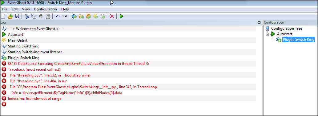

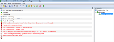

    Hi!
    I have something like this as well...
    I have tried to get this to work the last days, but I only get error messages like this:
    All the services for SK is running like thay should, and I have tried to restarted them but that dues not solve this problem...
    Any other suggestions?
    (Sorry for the screenshoot... it is in Swedish. I can make an other one in english if some one like to have it translated)

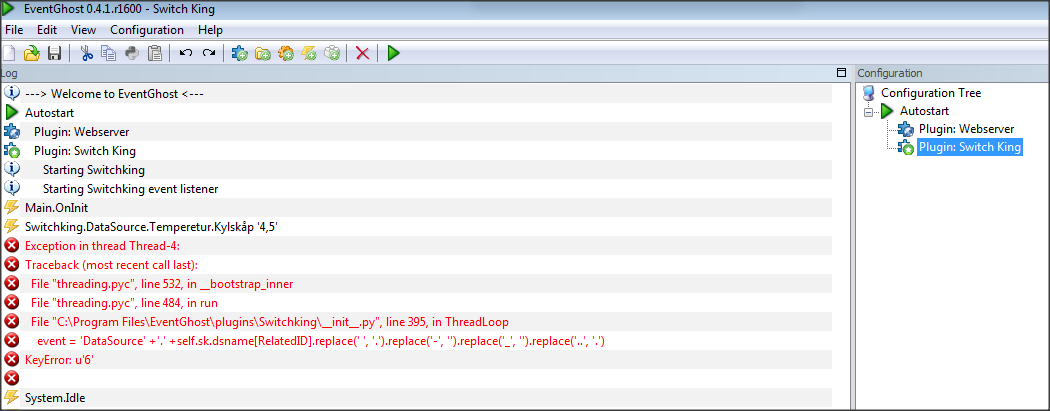

    Hi!
    I experienced something similar when I try to start the Event Ghost with this pluguin.
    As you can see in the screenshot below, I also get a lot of error messages. I have several times tried to restart the Switch King services and then restarted the Event Ghost, but without result.

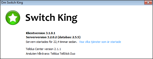

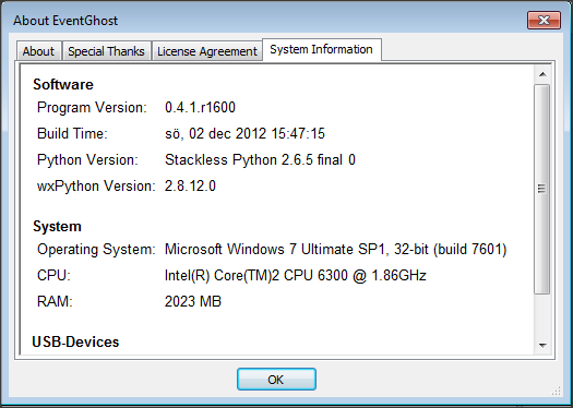

    Some info about my system:
    Does anyone have any other suggestions on what this could be?
    woggy
    Posts: 40
    Joined: Sun May 02, 2010 2:06 pm
    Re: Switch King Plugin
    Post by woggy »
    Is it the same error on V0.0.8?

    woggy
    Posts: 40
    Post by woggy »
    Gyld wrote:
    woggy wrote:Is it the same error on V0.0.8?
    I am using V0.0.8
    The error on line 395 is from 0.0.7
    Have you tryed to restart the Client, it's sometimes needed when adding new data sources or devices

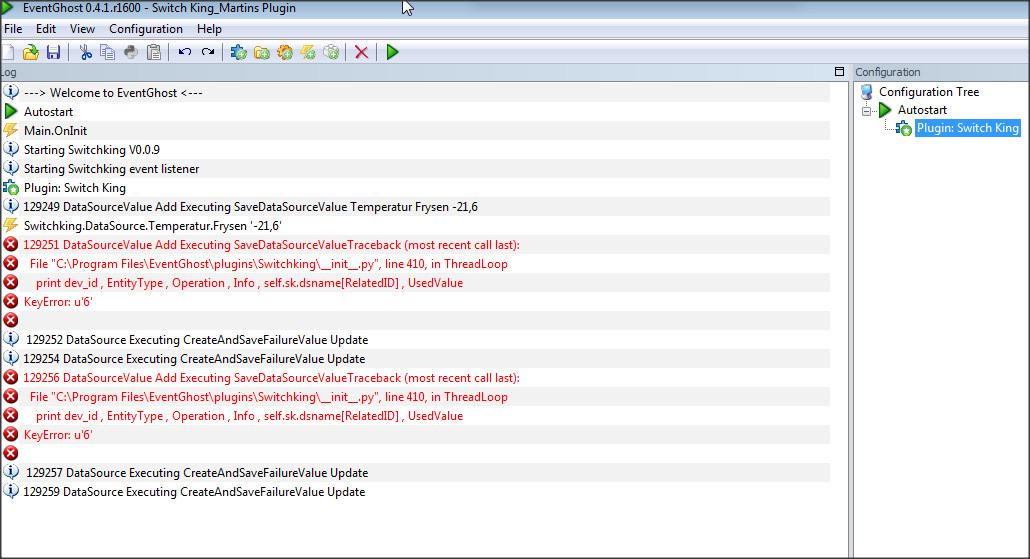

    Many thanks for the quick response! :)

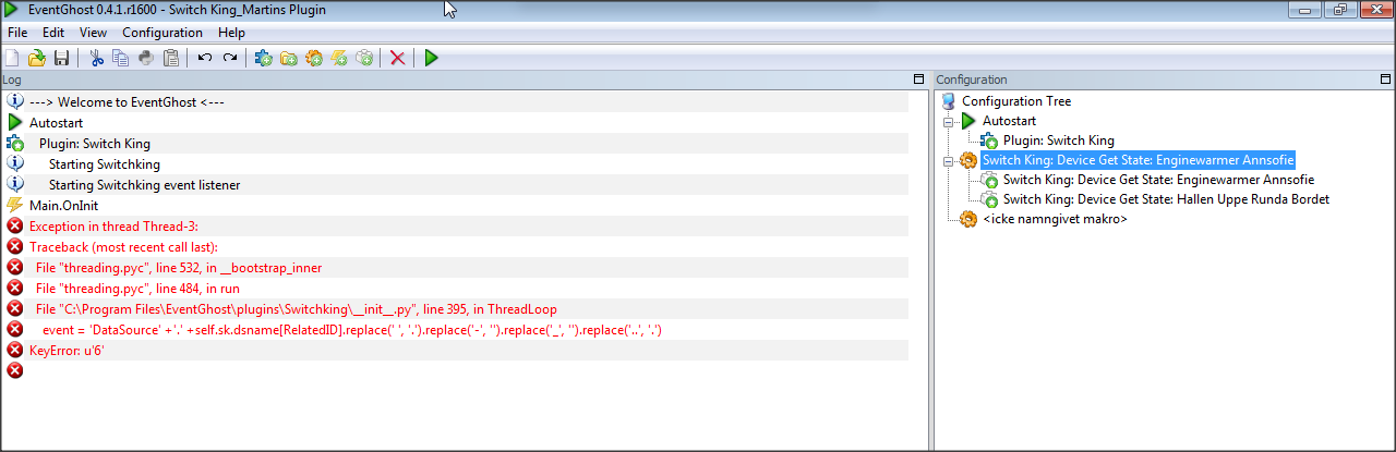

    I have installed the v0.0.9 and now it seams to receive information from my temp sensors in Switch King, but I still get some error messages:
    Does you have any solution on that as well? :)

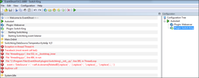

    Gyld
    Posts: 9
    Joined: Wed Dec 26, 2012 7:53 pm
    Post by Gyld »
    Here is an other screenshot where the system has been running for some minutes.
    woggy
    Posts: 40
    Post by woggy »
    Okey, try V0.1.0
    The REST API is not consequent at the time being so it's a bit hard to extract the information. If you enable ONLY "Debug mode" the ID numbers should come in sequence and not skip any number.

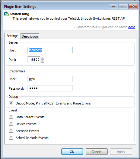

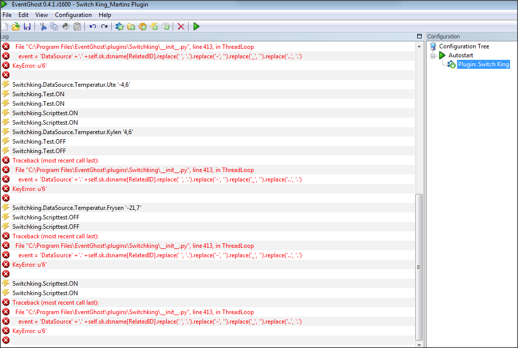

    Gyld
    Posts: 9
    Post by Gyld »

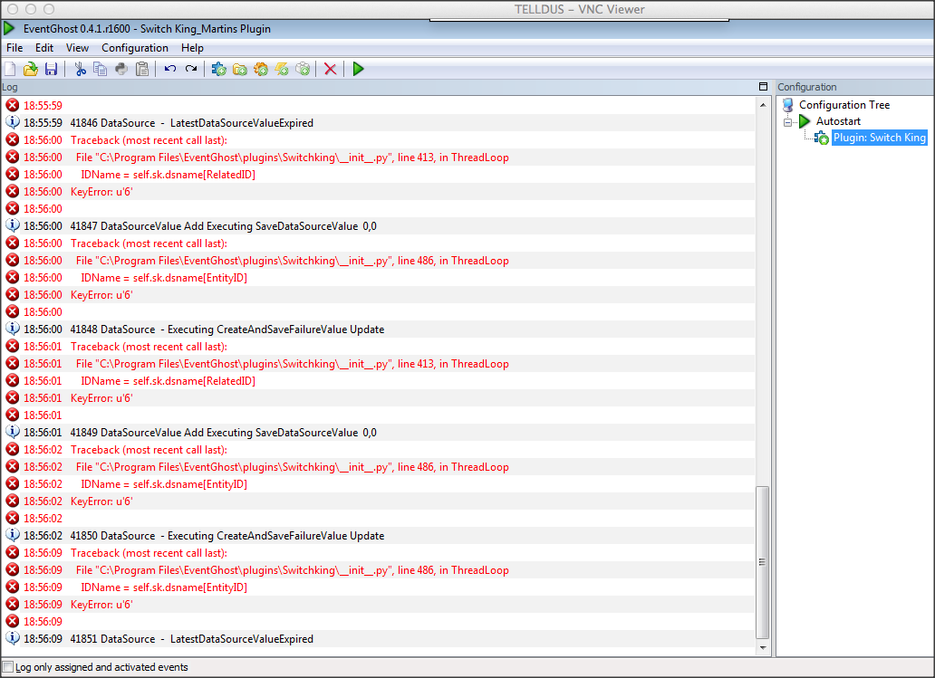

    woggy wrote:Okey, try V0.1.0
    I really appreciate your efforts in trying to get this to work! Awesome nice!
    Unfortunately I must announce that I still get lots of errormessages even with v0.1.0
    If I understood you correctly, it was JUST debug you wished to be check?
