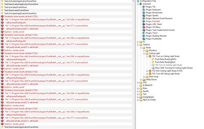

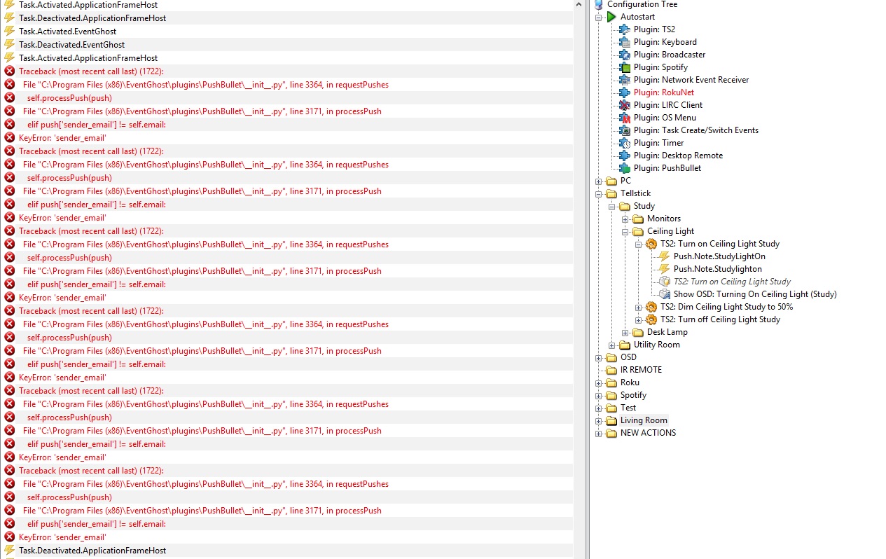

Hi, I've been using this plugin for a while now and its worked perfectly but today it's stopped working. I keep getting the following error when I try to push a note to evenghost:
Traceback (most recent call last) (1722):
File "C:\Program Files (x86)\EventGhost\plugins\PushBullet\__init__.py", line 3364, in requestPushes
self.processPush(push)
File "C:\Program Files (x86)\EventGhost\plugins\PushBullet\__init__.py", line 3171, in processPush
elif push['sender_email'] != self.email:
KeyError: 'sender_email'
I've updated eventghost and the plugin but the error persists.
if anybody could help I would really appreciate it,
I've attached a screen shot of the error along with an example macro that I would use it to run.
Re: PushBullet plugin (Pako)
That's weird. I do not have such a problem. Maybe I miss some information.
Please do the following things:
1) In setting EventGhost (menu View) turn on the "Log Times" option. It is more clear, when I also see time.
2) In the setting Pushbullet plugin set Logging level = 5
Then again, do a test sending / receiving push.
If an error occurs, please attach a copy of the relevant part of the log (not the screenshot).
It should look like this:
15:57:53   PushBullet: Getting pushes, modified_after = 1454770415.4304640
15:57:54   PushBullet: Response = {u'chats': [], u'blocks': [], u'pushes': [{u'body': u'Test_001\nMessage_001', u'iden': u'xxxxxxxxxxxxxxx', u'sender_iden': u'xxxxxx', u'created': 1454770665.022835, u'sender_name': u'xxxxxxxx', u'awake_app_guids': [u'xxxxxxxxxxxxx'], u'target_device_iden': u'xxxxxxxxxxxxx', u'direction': u'self', u'modified': 1454770665.0282691, u'dismissed': False, u'sender_email_normalized': u'xxxxxxxxxxxx', u'receiver_email': u'xxxxxxxxxxxx', u'source_device_iden': u'xxxxxxxxxxxxx', u'sender_email': u'xxxxxxxxxxxx', u'active': True, u'receiver_iden': u'xxxxxxxx', u'guid': u'xxxxxxx', u'type': u'note', u'receiver_email_normalized': u'xxxxxxxxxx'}], u'contacts': [], u'clients': [], u'devices': [], u'channels': [], u'texts': [], u'grants': [], u'accounts': [], u'profiles': [], u'subscriptions': []}
15:57:54   PushBullet: modified_after updated: 1454770665.0282691
15:57:54   PushBullet.Note.Test_001 [u'Test_001\nMessage_001', None, u'xxxxxxxxxx', u'Sony Xperia T', '2016-02-06 15:57:45']
You can (as I do) overwrite some data that could be private.
naryk_reklaw49
Joined: Sat Feb 06, 2016 12:53 pm
Post by naryk_reklaw49 »
Ok, thanks so much for your response. I've copied the log below, hope this is what you wanted.
18:46:59   Traceback (most recent call last) (1722):
18:46:59     File "C:\Program Files (x86)\EventGhost\plugins\PushBullet\__init__.py", line 3364, in requestPushes
18:46:59       self.processPush(push)
18:46:59     File "C:\Program Files (x86)\EventGhost\plugins\PushBullet\__init__.py", line 3171, in processPush
18:46:59       elif push['sender_email'] != self.email:
18:46:59   KeyError: 'sender_email'
The problem was, when the sender was IFTTT.
In this case, the parameter 'sender_email' is missing.
Now I have this case treated, so now it should be fine.
You can download the latest version 0.2.15.
naryk_reklaw49
Thanks a lot it's back to working perfectly!
