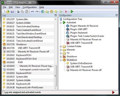

I'm using 0.3.7.r1194 on Vista SP2. I'm trying to execute a macro when I shutdown the computer. (the one called shutdown in the picture). When I execute the macro manually, it works fine, but it doesn't get executed on shutdown. Can anybody tell me why, and how to fix it??

I tried putting a 2 sec delay in the end of the macro, but it has no effect at all. It seems like the macro is not even being triggered by the event "System.OnEndSession", but I can't figure out why. Any suggestions any one?????

Well I can't see it because the computer is shutting down, and the log gets cleared, so I don't know. But Yes I'm looking for some event, that can trigger when the I shutdown the computer or secondary when the application is closed, but I'd prefer the shutdown event, since I could otherwise trigger the macro If i restarted the application.
But anything will do at the moment:-)
The System.OnEndSession was described in an other post here, so I tried it, but as noted it doesn't seem to work for some reason I that I can't figure out.

Perhaps I should reformulate the question.
I'm looking for an event, that I can use to trigger a macro (that can turn off some stuff) when I turn off my computer. The event should occur when EventGhost exits or preferably when the computer shuts down.
I've tried using System.OnEndSession without success.

You could try running EG with the -debug switch. That will write out the log (plus some extra messages) to a file. Then, even if you can't see the messages in the EG screen, you can see what events occur from the log text file.

Thank you very much for the advice Stottle (though I probably should have thought of that as the first thing
). After playing a bit Around with the events in the debug log I found that:
Main.OnClose - will fire when the app is closed. and
Main.OnEndSession - will fire when Vista shuts down.
