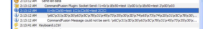

This just converts it to a string with all data converted to \xFF format:
\x6C\x31\x3D\x30\x63\x5C\x78\x31\x45\x73\x35\x30\x3D\x74\x65\x73\x74\x20\x31\x5C\x78\x30\x44\x31\x63\x5C\x78\x31\x45\x73\x35\x30\x3D\x74\x65\x73\x74\x20\x32\x5C\x78\x30\x44\x5C\x78\x30\x33
It should print out like the selected line in the attached image, with just the non printable hex chars as squares:

The problem is that at some point between the configuration dialog and the action of your plugin the string gets an extra layer of escape characters, like as if it would be input as a raw string. In other words any escape characters '\' in the original string convert into '\\'.
Now, what you should do is take off one layer of this string escaping with string.decode('string_escape').
def __call__(self, Value):
        val = Value.decode('string_escape')
        val = eg.ParseString(val)
        print(val)
        self.plugin.Push(val)
-jinxdone

THANK YOU! works perfect.
I had tried decode("hex") but obviously wasn't what I was after ;)
