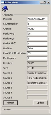

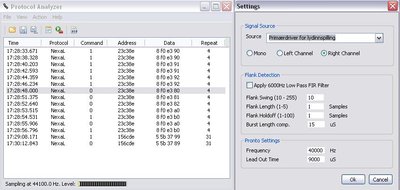

Once you have connected your home made receiver to the mic, you can start NetHomeServer. There is a HomeManager.bat file for this purpose (I created a shortcut to it in my startup folder)
Open the RFReceiver and configure it properly. The settings in the picture works fine for me but you might have to adjust them. Click "Update" to save settings.
When you have selected the correct sound device and the settings are OK, you can try to see if it captures RF events correctly. Press some buttons on a RF remote and click "Refresh". You should now see a changed value for the counter "Received"

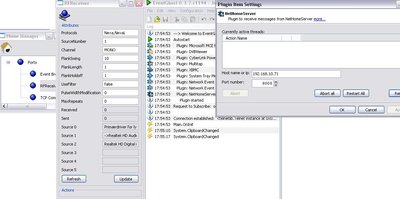

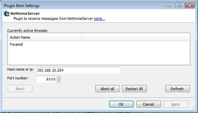

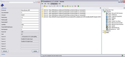

In EG, the following view is shown when you add the plugin
Here you configure the ip and port number to connect with NetHomeServer. Default port is 8005

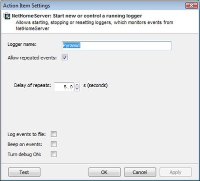

Then it is time to add an action for an event logger
In this view you define the name of the logger and some optional settings if you need them

Hi krambriw.
Thanks.

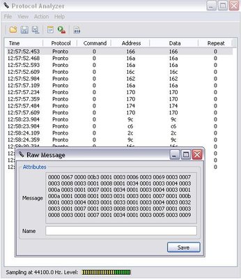

I cant get it working. I dont think it is the plugin that is the problem becouse when i use the:
http://wiki.nethome.nu/doku.php/analyzer/start
I cant get any of the nexa signals inn. If i use the raw decoder i can get it.
Have i done something wrong with the config or the mod you think?

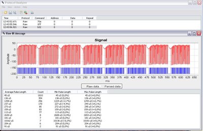

I have tryed using lots of diferent Flank swings. Here you can se an example of the signal i get when i press 1 to on on the nexa remote. I also tried pronto. For each press i get 4 or 5 "events".
Thanks for everything so farr.
Best regards Jostein.

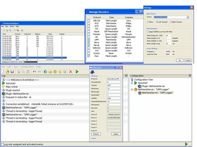

Hi, this is not such a bad start at all!
I did not now you used the analyzer, here is a more updated version, please replace the installed with this one
Check the following important Windows settings:
- volume mic input maximum level
- no microphone boost enabled
I'm not using the 600 Hz low pass filter, try first without it

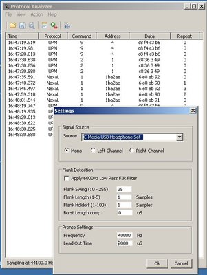

The settings for the UPM is a little bit different then for the Pyramid I have
Start with the following settings
If you don't get nexa messages to appear, try to increase "Burst lenght comp" in steps of 5 us (I have 35 but Stefan recommends 0 for the UPM). Next to experiment is the "Flank Swing" and then the other 2 "Flank" parametres
Bets regards, Walter

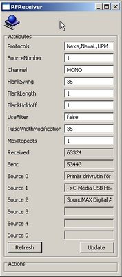

I just used the analyzer to check that i had the UPM working.

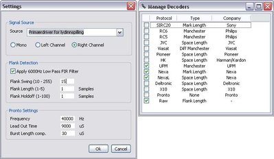

When i inserted your file i can recieve signals fine from remote and the motion detector. (Not from the tellsick but that is not important).
Using these settings: But i cant sem to get it working still. Is the "Burst lenght comp." in the analyzer the same as "Pulse With Modification" in net home?
Where you get the pyramid in eventghost i dont get anything. Also i dont get any recieved in the nethome.
Am i missing something?
Thanks again.
Best Regards Jostein

Yes, this is the same, in your case is should be 15 it seemsIs the "Burst lenght comp." in the analyser the same as "Pulse With Modification" in net home?
Also the rest of the values should be the same as for the analyzer
And, most likely, change the SourceNumber to 0 (and it might work)
When it is working correctly it should look similar to the following
As for the plug-in in EG, you are very, very close. The plug-in has successfully connected to NetHomeServer. Now you only have to add an action of type NetHomeServer and this will then generate the events when they are received NetHomeServer

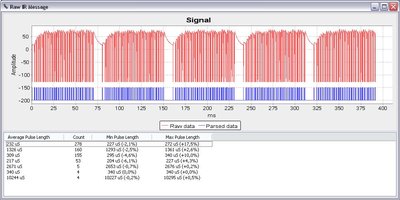

Please make a new picture of the analysers result (wave pattern) now that it works. I'm interested to see your signal quality

Hi
If i only chose the Nexa decoders i cant get the sample up(atleast dont know how to). Can get raw message: But if i chose Raw as a decoder i get a sample: Was this what you wanted? If not please explane how to get the picture you want.
At first i couldent get it to work.
So i desided to deleted everything and downloaded nethomeserver_844 again inserted your files. At first i couldent get it to work, Tried many diferent things. Changed it back to how it was in the start and sudently it worked. I find it weary spoky as i am sure it is just the same as it was 15 minutes before. But it at least is working. I tried both Source 0, 1 and 2, they are all working now but after restart i have to chose 0 for it to work but can then change to 1 and 2 and it still recieves the signals. (Veary strange)

Hello Jostein, no problem, I'm happy that it seems to work now!
Yes this was the picture I asked for (and you can only make them with raw, sorry didn't say that). I think your (raw) signal looks fine now
To save the settings in NetHome you need to edit the xml file demo.xml. Here you can type in the settings

Just found and tried this amazing solution! Looks very promising, but I'm not quite there yet.
I modded an UPM thermometer and followed all the instructions in this thread.
Using the analyzer, it works as it should, witn Nexa and UPM signals properly decoded.
However, in the HomeServer application, there is no activity detected; Sent and Received remain at 0 after Refresh.
In EG, the plugin starts and connects OK, but the logger thread terminates immediately.
Any ideas?
Settings and results attached
EDIT: Last try before bed, and all of a sudden it works!!!
No changes to any values or anything, just a restart of the HomeServer and EG and the events started showing up in the log! Great stuff!
