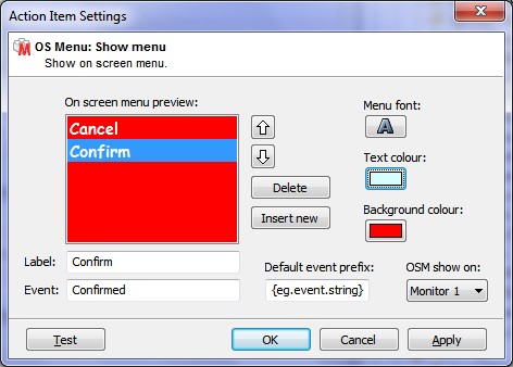

For the moment, I have just a question : Do you think that it is possible to add a confirmation dialog ?
I ask you this question because i'm using the OSM to do critical actions like restarting computer or starting an another application.
Those actions in a middle of a movie can be very dangerous !! :D

Maby not what you are looking for but there is a way to do what you want now.
Use the event to launch a second menu with only "Confirm" and "Cancel". Then have Cancel go back to the first menu and Confirm triger the event that restarts the computer.
If you have a lot of menues it can look weary bad but it atleast works in a way.

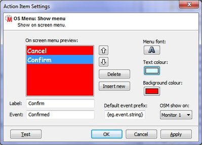

Re: OSM (On Screen Menu)
I think Jostein's solution is the right way. I just made a very simple improvement. Download the new version and you can proceed as follows:
You just create only a macro, which will be assigned all the events that you need to confirm.
In the editing box "Default event prefix:" you shall put the term "{eg.event.string}".
Once the menu, then choose "Confirm", created a new event, accompanied by the suffix "Confirmed".

I've just tried. It function as I want.
Thanks Pako and Jostein.

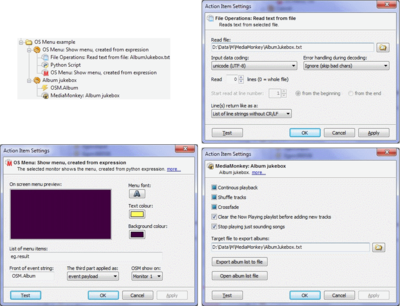

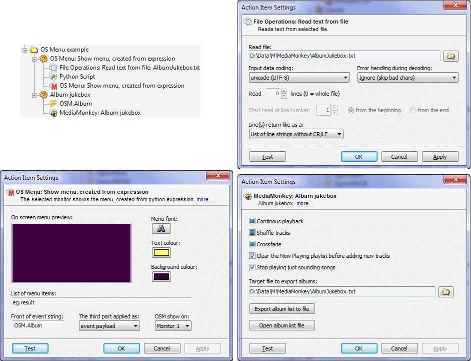

Here is one example of the use of new capabilities OSM.
You can easily (using the OSM) select the album, which will be played in MediaMonkey.
I think that the pictures need no comment.
Python Script contains the following code:
tmp = [item.split("\t") for item in eg.result]
tmp = [(item[2]+" - "+item[1],item[0]) for item in tmp]
tmp = [(item[0].upper(), item) for item in tmp]
tmp.sort()
eg.result = [item[1] for item in tmp]
OS Menu example whole script:
<EventGhost Version="1436">
    <Folder Name="OS Menu example" Expanded="True">
        <Macro Name="OS Menu: Show menu, created from expression" Expanded="True">
                FileOperations.Read(1, u'D:\\Data\\M\\MediaMonkey\\AlbumJukebox.txt', 0, 1, 'utf8', 1, False, 0)
                EventGhost.PythonScript(u'tmp = [item.split("\\t") for item in eg.result]\ntmp = [(item[2]+" - "+item[1],item[0]) for item in tmp]\ntmp = [(item[0].upper(), item) for item in tmp]\ntmp.sort()\neg.result = [item[1] for item in tmp]\n')
                OSM.CreateMenuFromList(u'eg.result', (255, 255, 94), (64, 0, 64), u'0;-16;0;0;0;700;255;0;0;238;3;2;1;66;Monotype Corsiva', u'OSM.Album', 0, 1)
        <Macro Name="Album jukebox" Expanded="True">
            <Event Name="OSM.Album" />
                MediaMonkey.Jukebox(2, 2, 2, True, u'D:\\Data\\M\\MediaMonkey\\AlbumJukebox.txt', True)

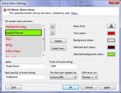

1) Colors of the selected item - it is not yet possible to do.
Menu is based on the class wx.ListBox and there is not possible to set these attributes.
I would have to be used instead of wx.ListBox class more complex (and therefore much more difficult applicable)
wx.Grid class. However, I'll think about it.
2) Position of the menu setting - this is not a big problem technically, but it's a problem in terms of design and logic
of configuration dialog. When the user will have option to set the location of the menu, will also probably appropriate
to give him an opportunity to set the maximum size. I am by this time was convinced that the location of the middle
of the screen is satisfactory, because the menu is always displayed only a short time.
If multiple users will claim that it is important for them to implement this option, I'll do it.

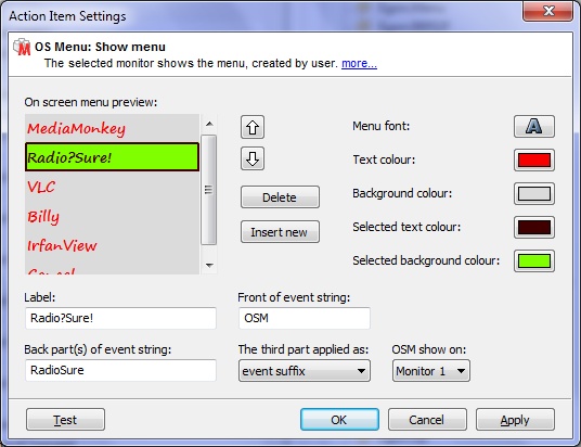

I have never used the class wx.Grid and tempted me to try it.
Therefore, I decided to do a new version of the plugin and it is in the world.
It is true that it gave me more work than I expected.
So what's new:
1) Added ability to choose colors of selected item.
2) Added ability to completely control the menu using the keypad
(accepts Up, Down, PgUp, PgDown, Esc and Enter keys).
It is possible that I have tested poorly and you will find bug. If so, please report it here.
Of course I also welcome your positive response :) .
