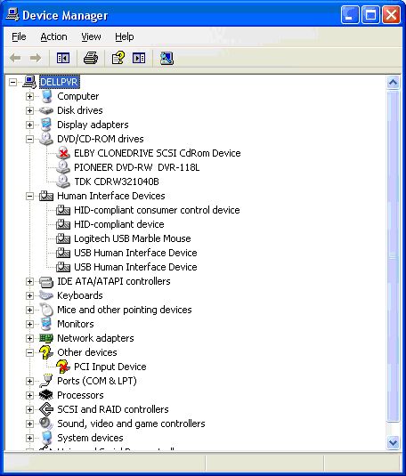

I have one of those IR receivers from ebay and I can't seem to get it working with eventghost. I tried following all the instructions on this thread, but I probably got it wrong as I am new to eventghost and can not readily recognize what is right and what is wrong.
When I try to update the driver via the device manager by pointing to a driver DLL, I get a message that the driver can not be installed. When I try using one of the driver installers I get a message the the driver was installed successfully but there is no change in the driver shown in device manager. After I copy the PY, PYC, and INF plugin files to the plugin folder, I am able to install the "Deal Extreme USB PC remote" plugin to the start section, but then I get an error messages in the log and no apparent response from clicking the buttons on the remote.
I have spent many may hours trying the different drivers and plugin files linked on this thread, but I can not seem to get this going. Any help in identifying what I got wrong would be appreciated. I attached some pics that might help.
OS: Windows XP SP3
EventGhost: 0.3.7.r1436

Are you making sure to use the right device id in the device manager to manually force install the driver? Go into driver details tab and use the pull down to select hardware ID make sure the hardware ID for the HID device matches than do a manual install of the driver.. Just extract the driver to a folder and copy the driver_mod.inf that you should have downloaded from here for the remote 'DAnschis Ebay Fernbedienung' and copy to that folder. You have to replace the original driver.inf file and use that to install the driver. My earlier post has the driver_mod file you need.

OK, I solved my earlier problem with installing the DAnschis Ebay Fernbedienung driver for my IR reviever. Running the USB-Remote-Driver.exe file with the INF file was not working for me. I had to instead choose Update Driver in Device Mangager and select the the "Don't search. I will choose the driver to install" option during the update process. During this process, the wizard asked for two DLL files that it could not find (WinUSBCoInstaller.dll and WdfCoInstaller01007.dll) . I searched my PC for them and found them in an obsure location in the Windows folder. After locating these two files and pointing to them in the wizard, the wizard competed the update and the IR receiver now appears in the Device Manager as DAnschis Ebay Fernbedienung. Also, the remote control events now appear in the Eventghost log when buttons on the remote are pressed. Yeh!!! I thought I would pass this solution on for anyone else experiencing the same problem while trying to install the driver.

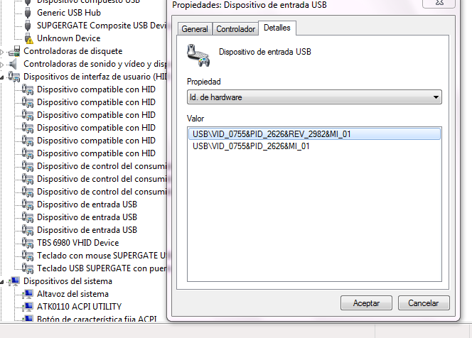

Finally, I bought this remote. But I can not make it work with EventGhost.
What I have to do or change to test if it works?
